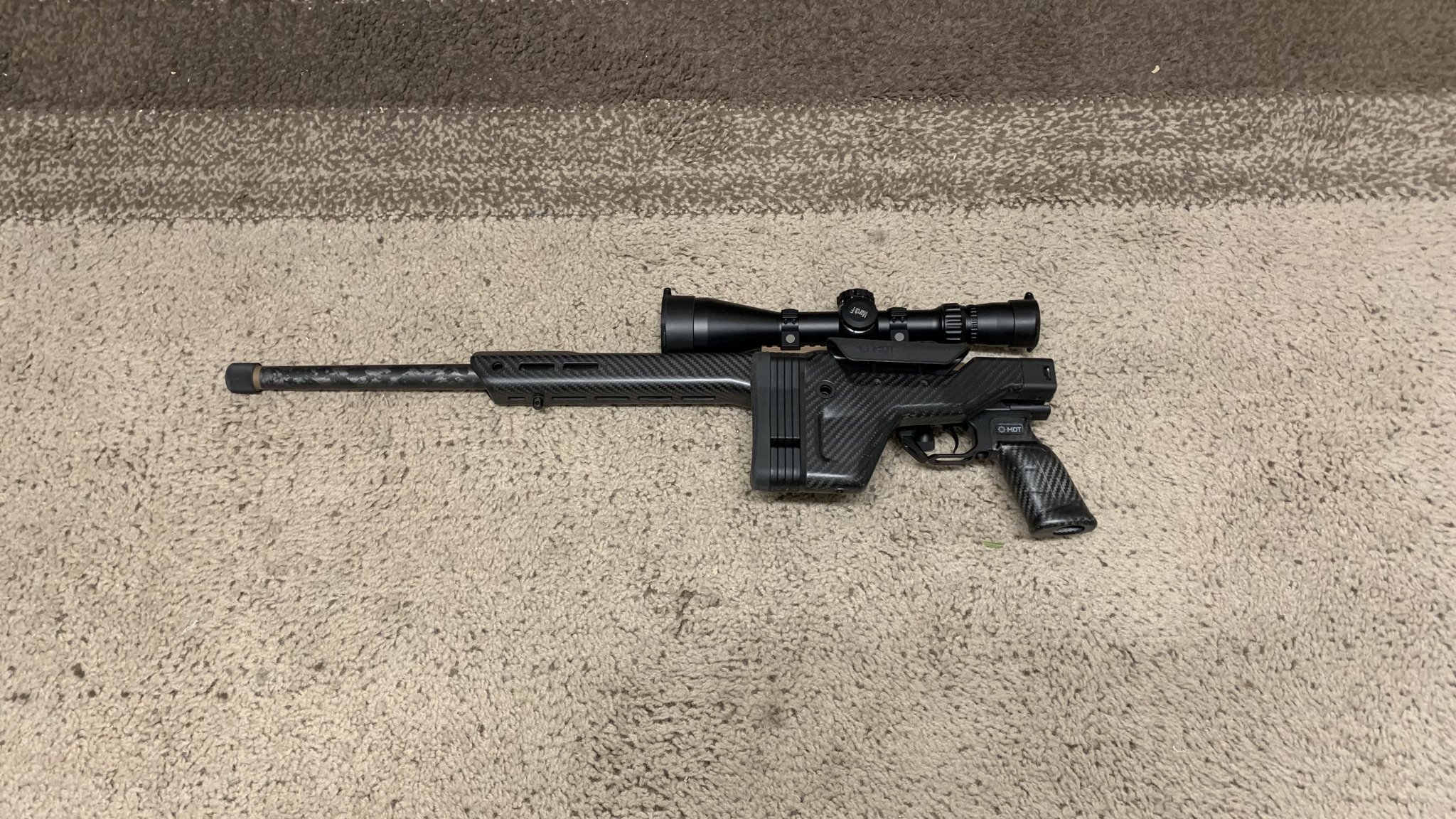

I like 60 deg actions, but not for hunting rifles. They just make the bolt stick out a lot. Id do a defiance anti receiver(standard, not the X), the MDT HNT 26 stock (folding), and a proof carbon barrel. If you stick to those parts with a 18-20” barrel, the rifle will weigh about 5.5-5.75 lbs. Since it folds, it will stick to the side of your pack nicely while trekking. If you're doing the barrel work yourself, you’ll keep a fair amount of your budgeted money in your pocket.

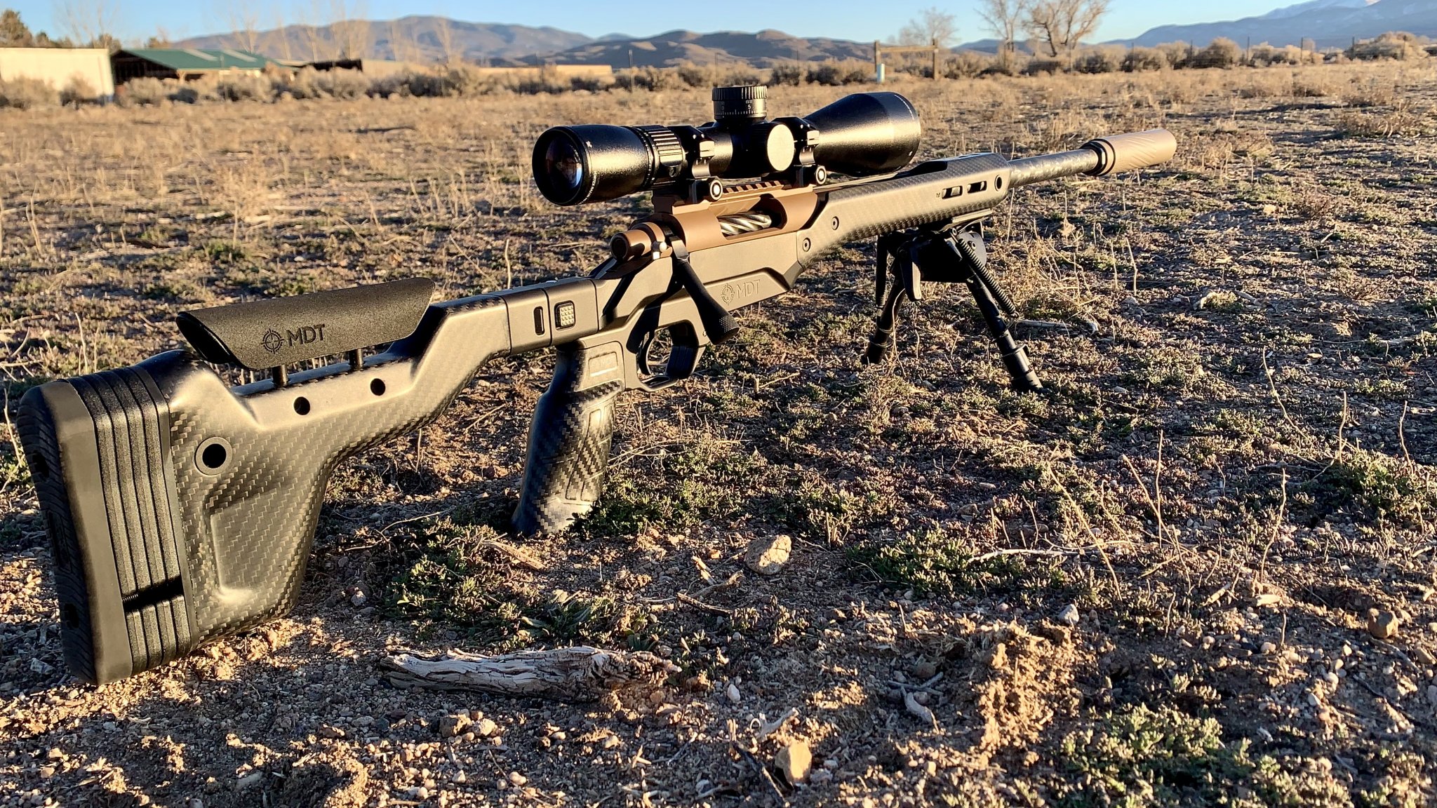

This is 7.8 lbs without the suppressor. The action is needlessly heavy, and the anti would save about 9 oz. A leupold vx3 4.5-14 wpuld save another 6oz. So right around 7 lbs ready to hunt. Im building another barreled action now using the defiance and a 22” proof in 260 to replace this one.

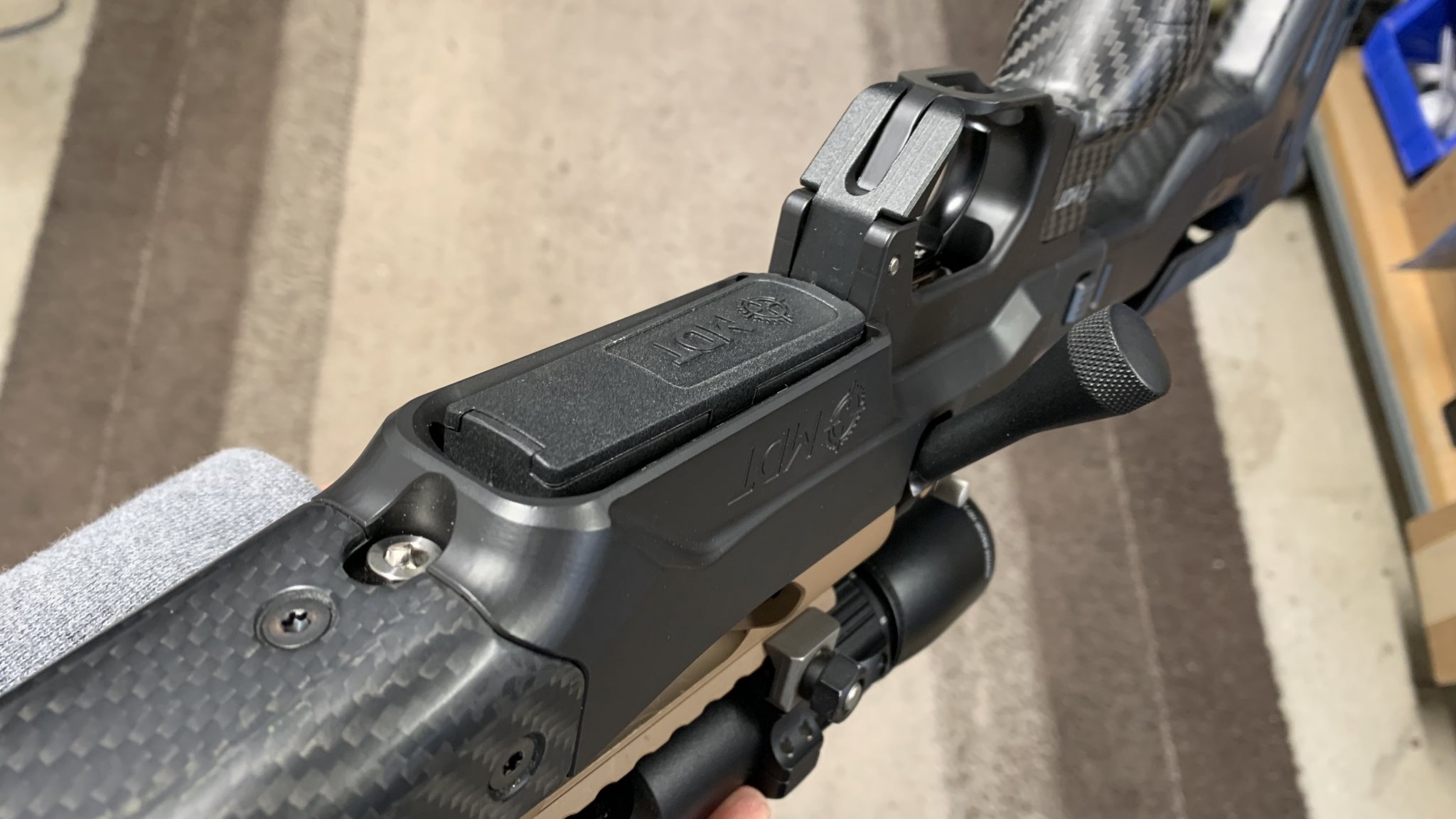

I have a very similar built as Supersubes I have a defiance deviant in 6.5 CM in HNT 26 stock and a leupold vx3 4.5-14 18'' proof barrel and a stud for a spartan bi pod. Also went with a 3 position safety cause I like the bolt locked down when I am bush whacking. I love the set up for Deer sized game and just got back from Alaska when it was covered in salt spray and sand. The action and rifle did outstanding. No rust and functioned flawlessly. Loaded with Hammer Hunters its a deadly set up.
