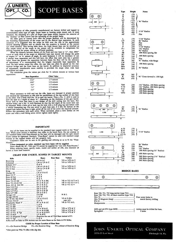

If I understand your question, you want to mount a Unertl style scope on your Model 70 using existing holes in the front receiver ring and barrel, like the USMC M70 Sniper Rifle shown below. Due to the different diameters of the ring and the barrel, the forward base will be somewhat higher than the rear one. The Unertl charts show a "P1" and "B70" base for the pre-64 M70 Target rifle, and I've also read that the pre-64 M70 Standard rifle uses "LV" and "C70" bases. This assumes of course that you have a factory barrel and the holes on your rifle are drilled in the standard locations (which may or may not be the case).
To purchase blocks I would point you to Steve Earle Products, who makes a broad variety of Unertl and other target-style scope blocks; all are extremely high quality with great prices Steve Earle scope blocks

Here's a copy of the great Unertl chart, which should help you out (its certainly helped me plenty).
Once you work out what you need, Steve Earle makes a nice range of the blocks in various heights just like the originals.
www.steveearleproducts.com
Steve supplied the blocks for my own Model 70 target project, which is underway currently:
  • C-70 (hole spacing of 1.750”), for the front block sitting forward over the heavy barrel
  • STANDARD ¼” ( hole spacing of .860”) for the rear block sitting on the receiver ring.
Just going from memory the hole centres for the front scope block on the barrel sound much shorter than is standard (for the target model at least)..
Do you know if its still the original factory barrel, and if so which contour/model?

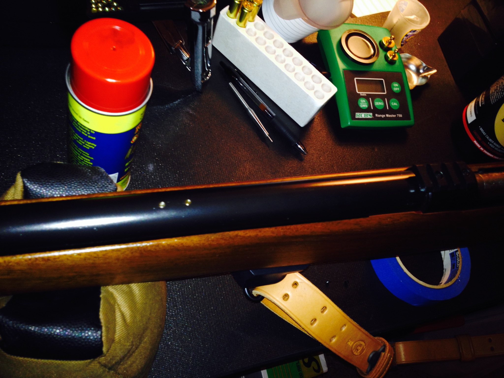

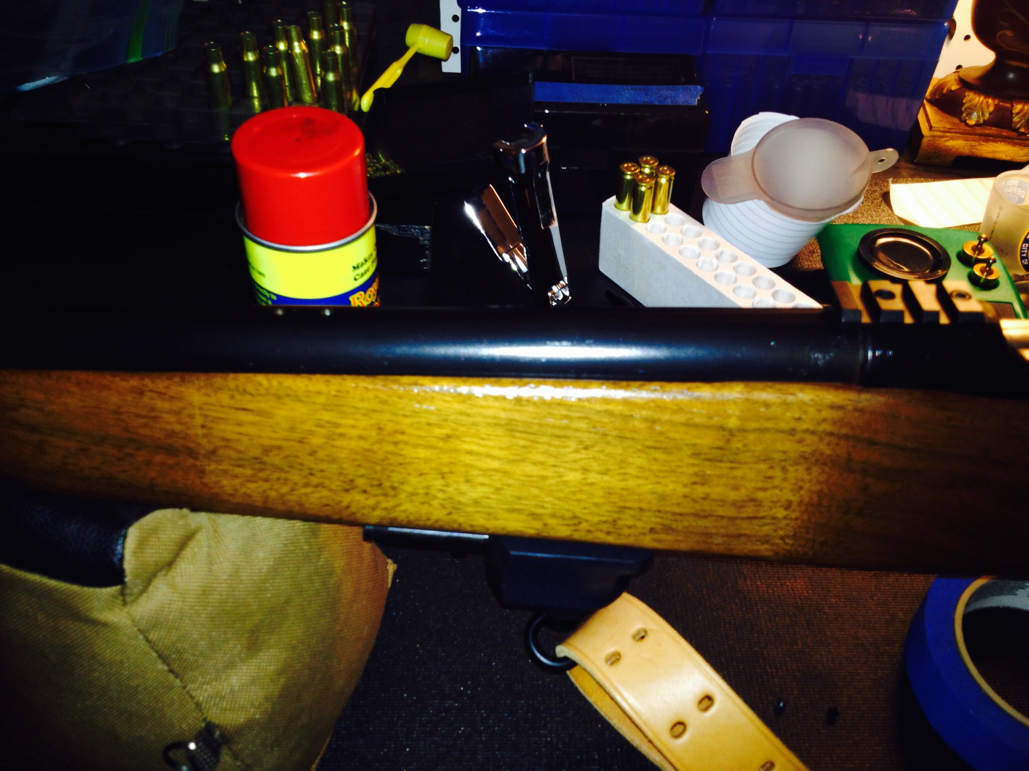

Need to measure center to center in thou. MM is a crude measurement for scope mount holes. Do you have pic of holes? I likely have a base or several that will fit.
Hopefully these pics help.
The rear tapping shows that a warne base WILL fit... but I never could find the front.
Matt.

If you are wanting bases for receiver, need to show pictures of it with everything removed. I am certain I have bases that will fit, but have lost confidence in your conceptual skills. Good luck with your project.
