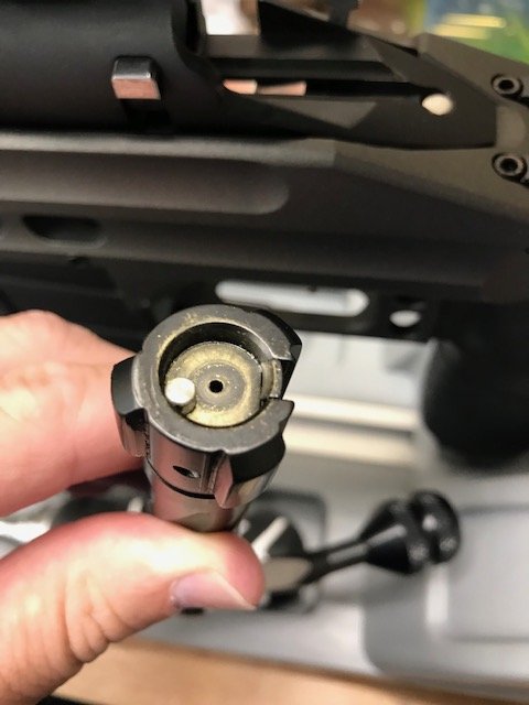

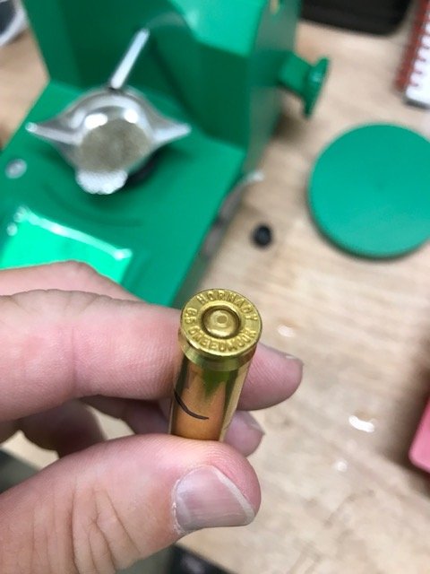

Im getting this primer swipe when I close the bolt on my MPA. Ant ideas what is causing this? It is not happening all all of my handholds.

New brass or previously fired? Primers are fully seated and primer pockets are not excessively dirty or loose fitting primers? Head spacing is correct and bolt not closing hard? Bolt face is smooth?
This is generally caused by primers being seated proud by a smidgen. Measure case length with calipers before and after seating a primer and you'll find out how proud they are.

I did check primer seating on the ones that were scraping and could not seat them more. I also loaded a few more and made sure I was seating them fully, but still found some that were scraping.

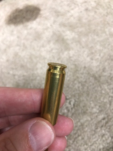

Ok I think I know what the problem is. The bottom of my case has a bulge. See the ring in the pic. After sizing it it is .004 larger than a brand new Hornady case. I just don't know why it's like this. Not enough lube when sizing? Bad dies? Signs of pressure from a previous load?
Not every die will size the body down by the web. Often, what they call a Small Base Die will have tighter dimensions and affect the lower part of the case body, but regular dies may not.

If your sized case will allow an easy bolt closure, that bulge is just cosmetic. Test to see if a sized case will cycle easily before you address the bulge.
Those marks on the primer are usually caused by one or a combination of debris around the firing pin hole or the primer isn’t completely seated, or both. In theory, that primer sits more than 0.002” below the case head so it can’t get touched unless it is in the wrong place or the bolt face has issues.

The bulge cases create resistance when closing the bolt. With a new factory case the bolt will close much easier.

Why don't you clean the bolt face, some solvent and a toothbrush will do. Your ejector plunger may sit proud, that'll scrape the shit out of brass, and in your case, being some don't, all brass not the same dimension. You may have some brass buildup on the underside of the plunger if you know how to pull it and clean that too.
