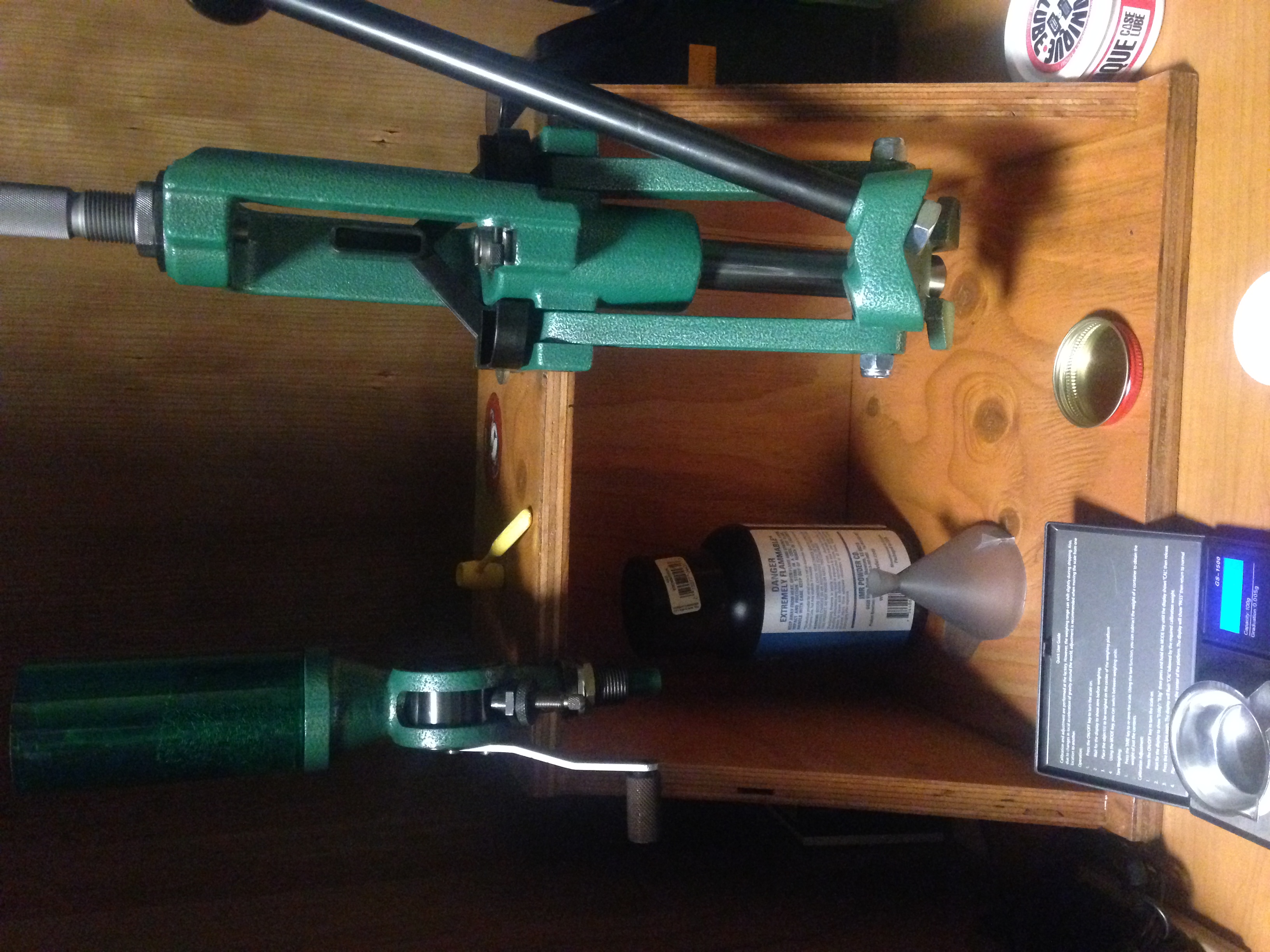

mine is similar, mounted my RC and powder dispenser to a wooden box made out of 3/4 wood I clamp it to any flat surface with C clamps with no issues what's so ever sizing 308

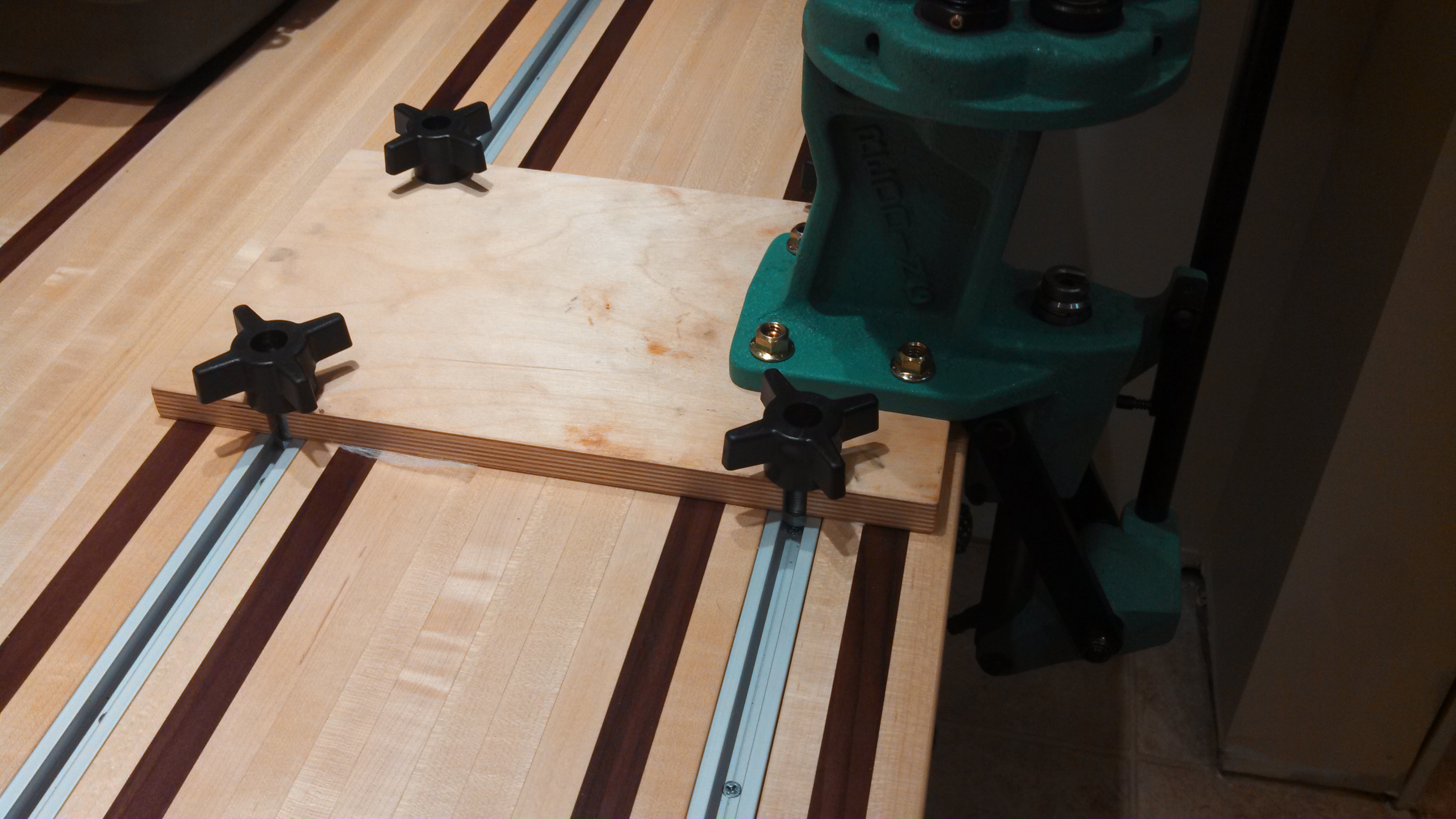

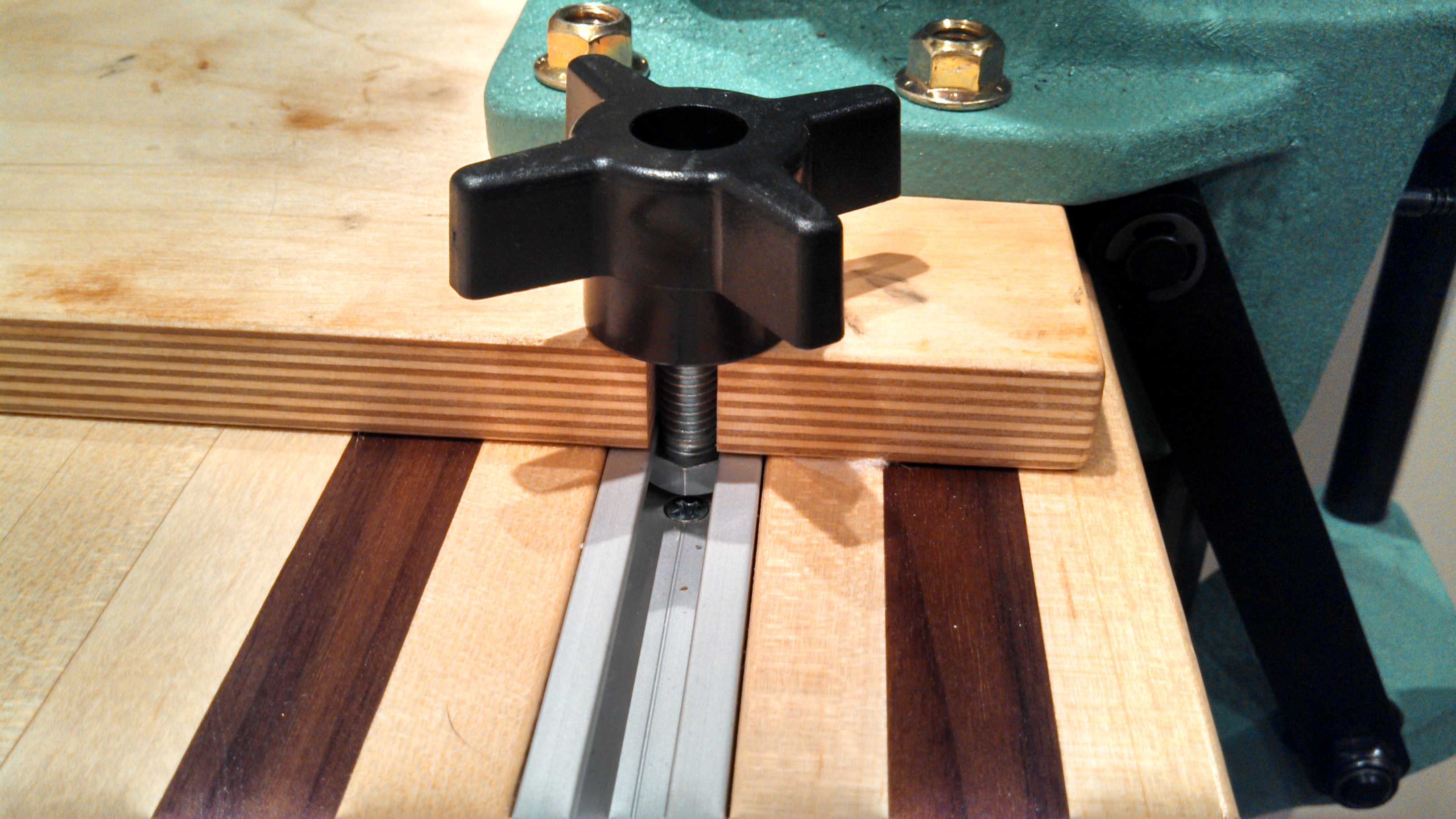

When I starting planning my bench top, I also wanted to move the press around. I found these tracks online and love them. I had a few plates made for other presses, trimmers.. and so on.
Worth a look?

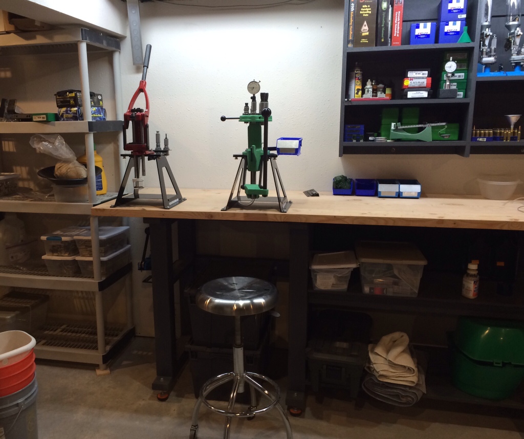

I use the in line fabrication mounts and secure the press to 3/4 inch piece of plywood. I can change presses in about a minute depending on what I want to load for.
Yes the bench is a mess...But i have the rest of the week off to allow for an OCD level cleaning and organizing.

Does the Inlinefabrication quick change mount lock down tight or is there any play/wiggle room? Basically once it's mounted down is it solid?
Yes, the Inline Fabrication quick change is very easy to swap out, and very sturdy without wiggle when attached. Will try to describe it below for you.
With the Inline Fabrication quick change mounts (the part that is bolted to your equipment) there is a large "tab" at the back that sets into the base (the part that bolts or clamps to your bench). There is an alignment post in the front that indexes the location horizontally and laterally into the top of the base. Two threaded posts are welded to the underside of the quick change plate which go through two holes in top of the base. Two brass finger nuts then screw onto the threaded post clamping the quick change plate snug against the base. At this point it is rock solid and doesn't have any play in it, even though you can change presses in under 30 seconds and didn't use any tools. I was really impressed how solid it feels.
My base assembly is bolted to my bench with hex bolts, and can be removed from the bench in about 2 minutes.
