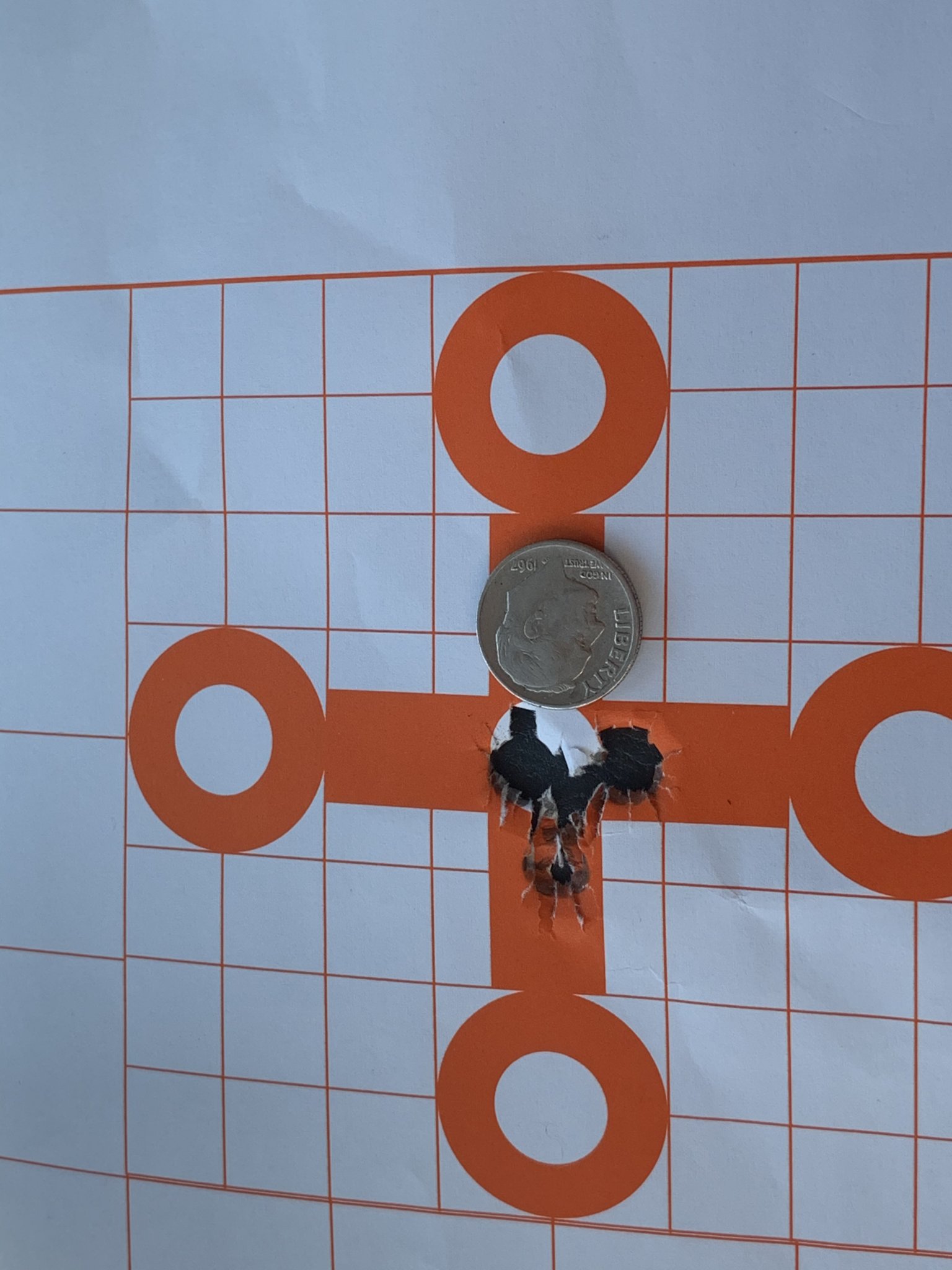

Rifle is a Bergara HMR Pro in 308. Barrel today now has exactly 115 rounds. I've been running Berger 175 OTM and Nosler 175 RDF over Varget in virgin Lapua and once fired Federal Match brass.
I have yet to find a 5 shot group under .769" and that was the best I've had out of several. Most were above 1 MOA and some into the 1.5-1.8 MOA. I know this rifle can do better. I know I am capable of .305"-.033" 5 shot groups with my HMR in 6.5, so I'm a little worried about this rifle.
I've worked seating depths up and down from mag length to the standard 2.800" COAL. Not finding anything so far that justifies the 1680 and change I have into the rifle.
Twist is 1-10 with a 20" barrel. Should I try a different bullet in 175 or try a different weight. I've read that the 155.5 Freebores and 185 Juggernauts (sp) have been very good over Varget. Twist rates/bullet weights seem to be all over the place opinion wise.
Any guidance would be very helpful and appreciated. Each of my 5 shot groups were chrono'd as well. I have some strings of single digits SD's but working up and down in .002" increments and .2 grain increments seem to get stupid wide on paper and in SD.
Thanks in advance
Different rifles like Different powder n bullets try 168gr 190gr and 200gr you have a 20 inch barrel so try some CFE223 and AR-COMP. I recommend Winchester headstamp brass it has an extra 2gr H20 capacity. Its the only brass I use!

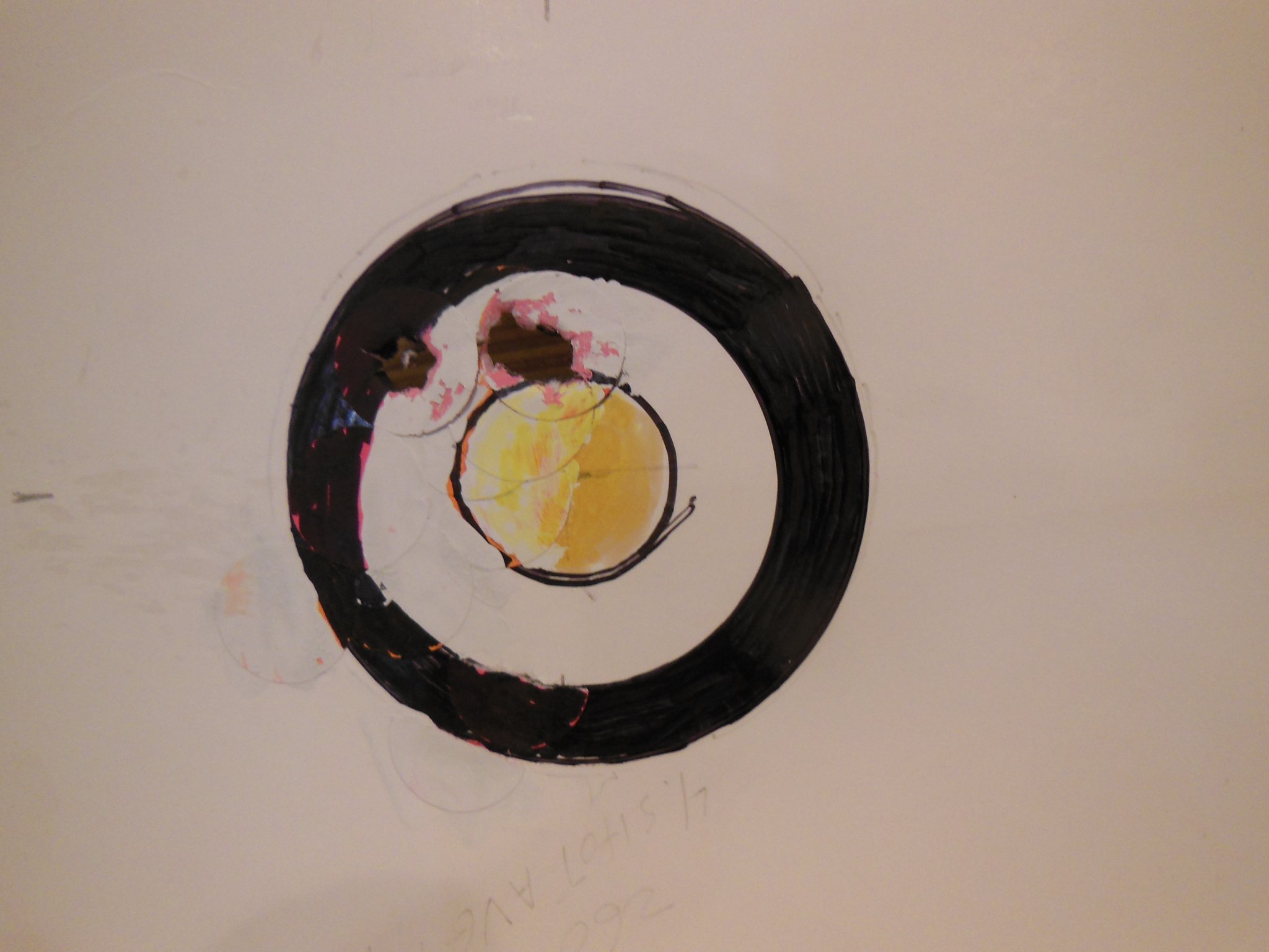

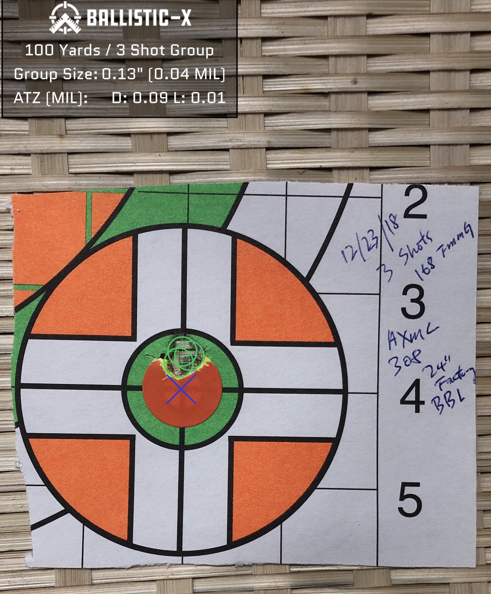

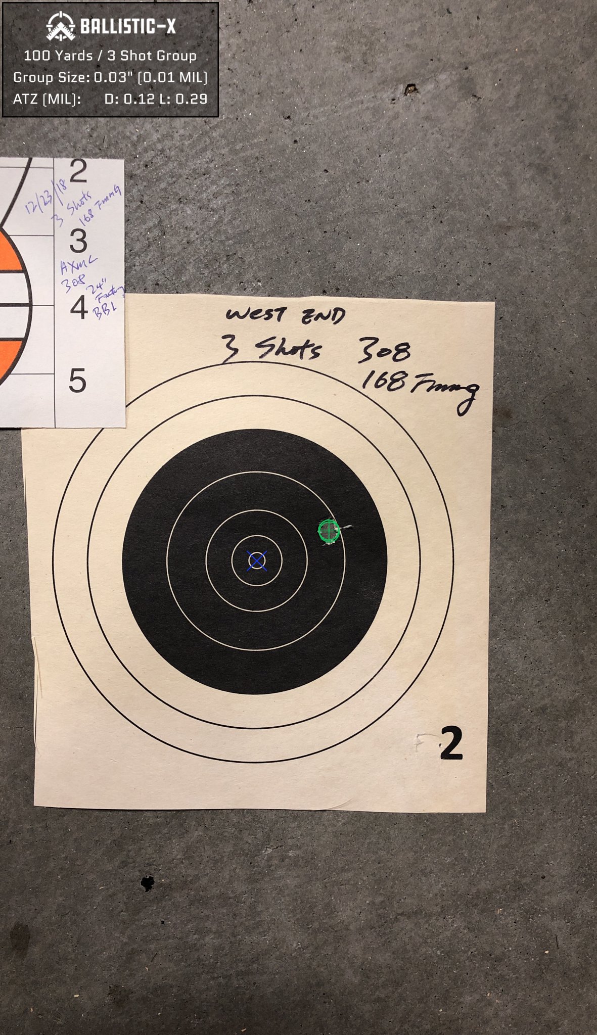

I spent over 2 years for reloading 308 Ammo and none of my reload can match the 168gr federal match. The best I can do is .4 moa of my reload. I tried match the federal muzzle velocity, seating depth, case headspace, bullet runout.... still not working and I just gave up.
First pic was shot with factory AXMC
2nd pic was shot with trued r700 pacnor match bbl
No sir. Chrono is 6-7 yards off the muzzle

Hopefully powder/bullet/primer testing will get it shooting better. Best of luck.
Also, typically barrels will speed up or “break in” in the first 100-300 rounds (depending on the barrel). I generally hold off on any load development until she’s settled in (ie you may want to retest some promising loads previously tested).

I get excellent results with Varget on most loads 165-168 Gr Barnes 45.5 Gr Varget but with 175 Gr SMK or Berger I use 42.0 Gr IMR 4064.

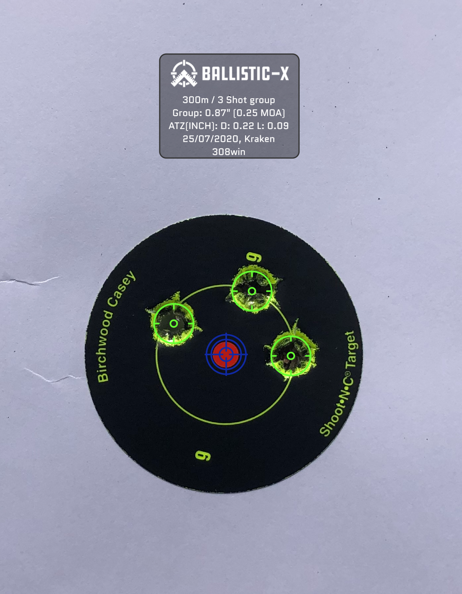

I use the 175 Lapua scenar-L with varget and federal GMM brass and get 1/4 MOA at 300m.
41.8 gr of varget and 2.236” CBTO. Will shoot well in any rifle! Will still 1/2 MOA at 1054m
24” barrel with 11.25 twist
