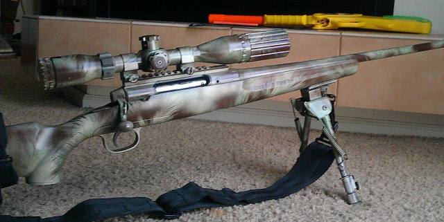

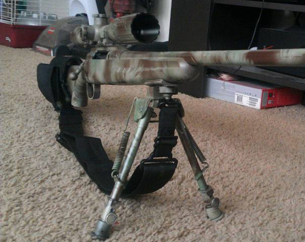

I had my AR15 Duracoated FDE and Tactical Black. Whatcha think?
What colors were these? They look amazing!
Ben
Thanks Ben !
Got everything from home depo
Base coat is Rustoleum Camo #1917 Khaki. The sponged on is standard Rustoleum "satin" #241238 Dark Taupe. Snagged a sponge roller with biggest holes in it for $3 and took the scissors to the roller for manageable pieces. Tore chunks out of the pieces to get somewhat different shapes.
Did NOT clear over any of it. Its a truck gun not a safe queen so wasn't too worried about it getting knicked,scratched or wear spots.
Edit: Barrel,action,bolt are Cerakoted Coyote Tan,not spray paint.
