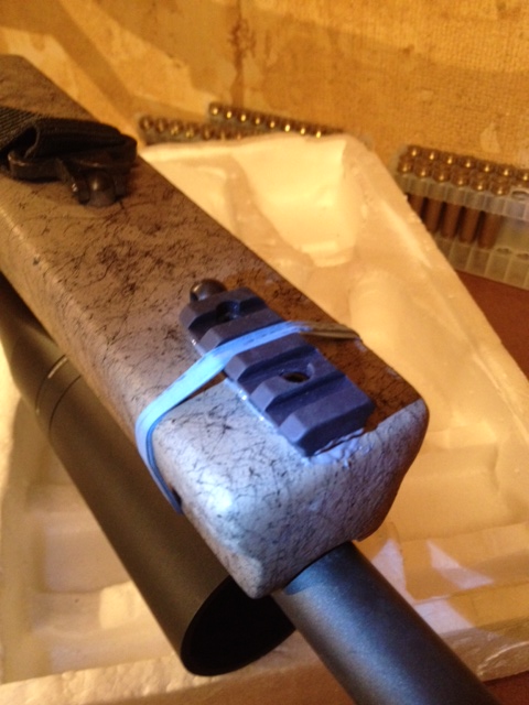

Been doing some research, and also sent an email to B&C and got no real helpfull suggestions, but I am trying to mount an Atlas QD bipod to my B&C Tatical Medalist stock. Do you guys have a suggestion for a shorter 3"ish rail that will work in the T slot configuration forend ?
Got this one from GG&G and attached it to my B&C tactical medalist. Drilled two holes for the screws and uses them as placeholders, but ultimately it's JB welded on. Make sure you sand down to the actual stock and not just screw/glue to the paint. Ignore the rubber band. Obviously it was removed when the JB weld set up.
I've loved this set up btw. It doesn't look pretty, but it's highly functional and durable.
