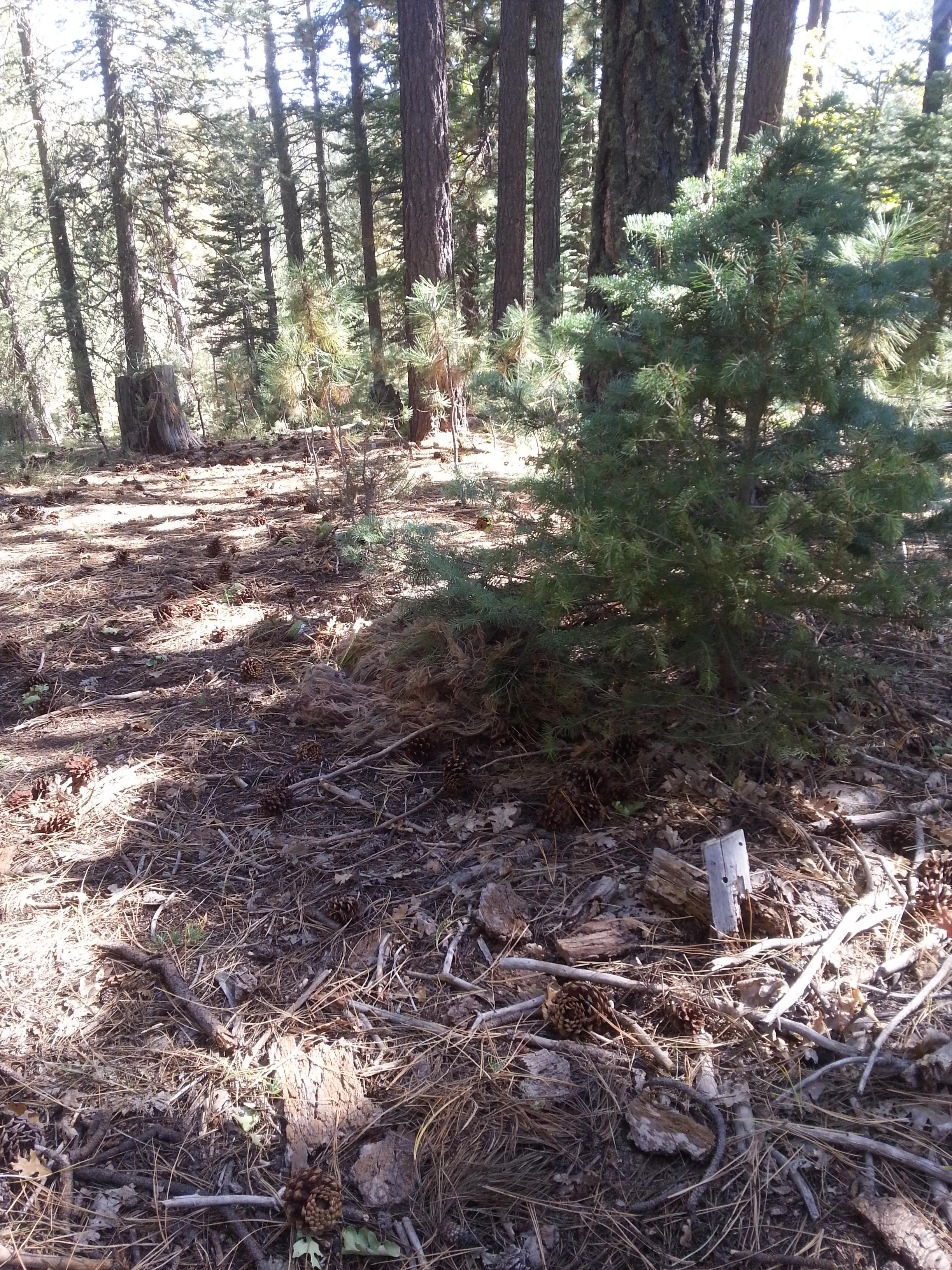

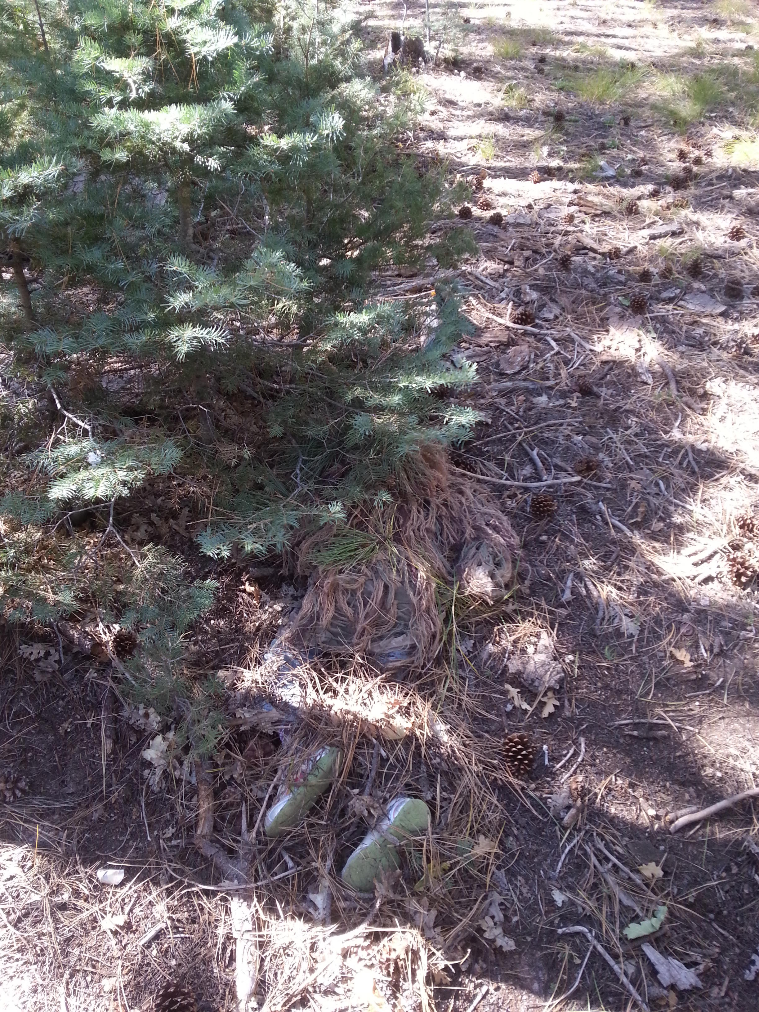

Kraig, I built my ghillie just to build it (honestly). I wanted to see if I could do it. ALOT OF FUCKING WORK? yes...Worth it? my kids think so when we are camping and they want to play ghillie hide and seek. They found my buddie in his turkey hunting / real tree ghillie thing. They walked right past me. Pictures attached are of my daughter wearing the jacket and hat.
