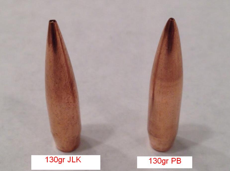

See the attached picture highlighting his bullet on the right, next to a JLK on the left. The PB's are a tangent ogive profile, significantly different from the JLK and from the Berger, which have secant profiles in the 0.6 R/Rt range. The ogive radius length is 15 calibers, which is very long. I'm aware of only one other tangent ogive bullet with an ogive that long, Berger's 140gr LRHPBT. Most tangent bullets are in the 10 caliber range (including most SMKs). PB's also have a very slight rebate on the boat tail (you can barely see it); the boat tail itself is 10*, for 0.20". The meplat has been tightened up to ~0.02" with a pointing die (the picture highlights this pointed meplat nicely; note how small it is compared to the JLK, which itself has a tight meplat of ~0.05"). Overall length is 1.375". Don uses only the outstanding J4 jackets from Berger, same as JLK. He seats, swages and points these bullets on top of the line precision equipment, including Detsch dies, regarded as the best forming dies available.
Looking at these factors as a whole, we have a bullet that offers excellent long ogive led by a tight meplat. The boat tail is standard, with a slight rebate that may or may not improve precision due to reduce dispersion at the muzzle from gas inconsistencies shot to shot. The ogive is strongly tangent, so we are increasing its drag by maybe 5% or so vs the secant JLK and Berger. The tangent profile might make it less seating depth sensitive (see discussion there below). All in, and using Litz regression model to estimate G7 form factor, I think we are in the 0.94-0.95 range, i.e. very good, approaching excellent. At 6.5mm and 130gr, we get a sectional density of 0.266 lb/in^2, which leds us to a G7 BC of 0.28-0.29, roughly 0.56 on the G1 BC scale.

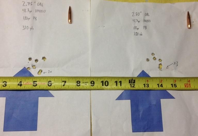

Ok, moving off the reloading bench and into the field. I basically did zero load development. I used the exact same load as my go-to 130gr JLK load: 41.7gr of H4350, 2.750" OAL, a CCI BR4 primer (this is a 6.5x47L cartridge). First time out and the bullet was shooting in the 0.1"s at 100yds in my 26" Hart 8 twist barrel. Rounds I thought I pulled went out 0.2"! These things are crazy precise at 100yd.
I swapped out the barrel for my 21" tube. Initially, and for some unknown reason, I loaded these rounds to 2.85" OAL. With this load in the 21" Kreiger 9 twist, I got not so hot results at 100yds: it was going into 0.5" groups and I was getting weird marks on the brass. Checking the load a bit, I noticed that at 2.85" the bullet was jamming into the lands and I was getting marks on brass related to forcing the bullet into these lands. So I moved it back to 2.75" OAL and also loaded up a 2.70" lot and bang, the load went back to shooting in the 0.1"'s! Damn, zero load development and the PBs are drilling absolute bug-holes.
Next, I moved out to 310yds (longest lane I could get on a piece of private land). See attached groups for both the 2.75" and the 2.70" OAL. Each group is 7 rounds (and looks like there was about 3mph of 9 oclock wind as I had 0.2mil on the scope and its roughly 0.1mil off the POA). I estimate the 2.75" lot is doing 2800fps at the muzzle and the 2.70" is hotter and maybe 50fps faster. Group measures about 1" vertically and horizonally, with both lots have multiple bullets go into the same hole. I'm pretty happy given the results and the amount of effort (basically two trips to the range and a few hours on the reloading bench).
Based on these results, I ordered a big fat lot of these bullets and they will be go-to load going forward.
I am going to continue to test these, especially at longer-range. Will hammer out the BC more, but pretty confident 0.55-0.56 BC will have me on steel out a good long ways.
