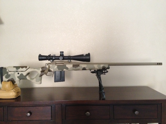

Just got my 6 Creedmoor yesterday from Moon of Crescent Customs. The rifle is a trued Rem 700 with a Med Palma 26" Bartlien Barrel, Manner's T-5 adj, Jewel trigger, Badger DBM and MB with a Leupold Mark 4. Shooting Berger 105 Hybrids, 42 grns of H-4350 @ 2.80 COAL FPS is 3168

Hmmmmm, dark flat earth I see, as ive stated in a previous reply here mine will be the same color. Cant quite make out the velocity on your target, I know you're not getting 3345 out of a 6 Creed, must be from a different rifle, eh? I get 3144 from 41.9grs H4350, 28" tube.
