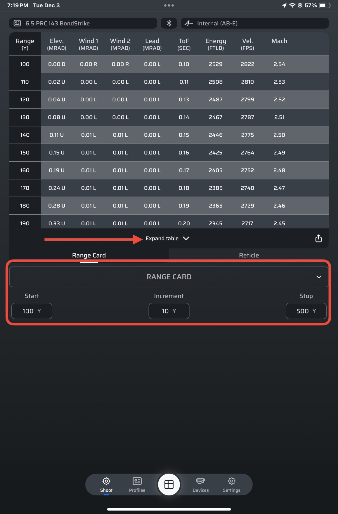

Is there a way to look at a drop chart like the old app. That shows drops in like 10 yard increments? All I can do is get it every 100 yards and it just goes to 1000 yards.

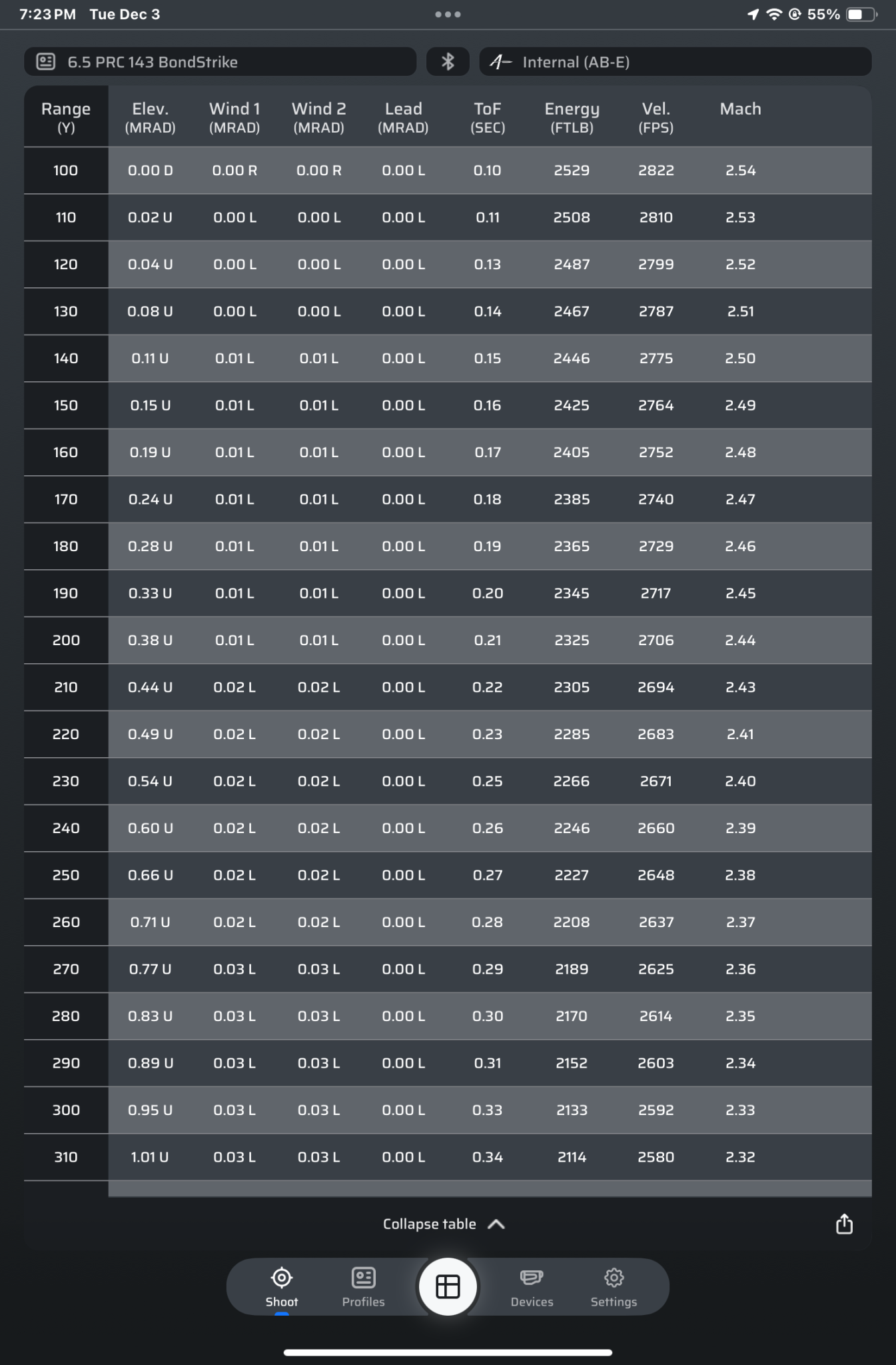

Go to the center drop down and hit range card. You can then “expand table”.

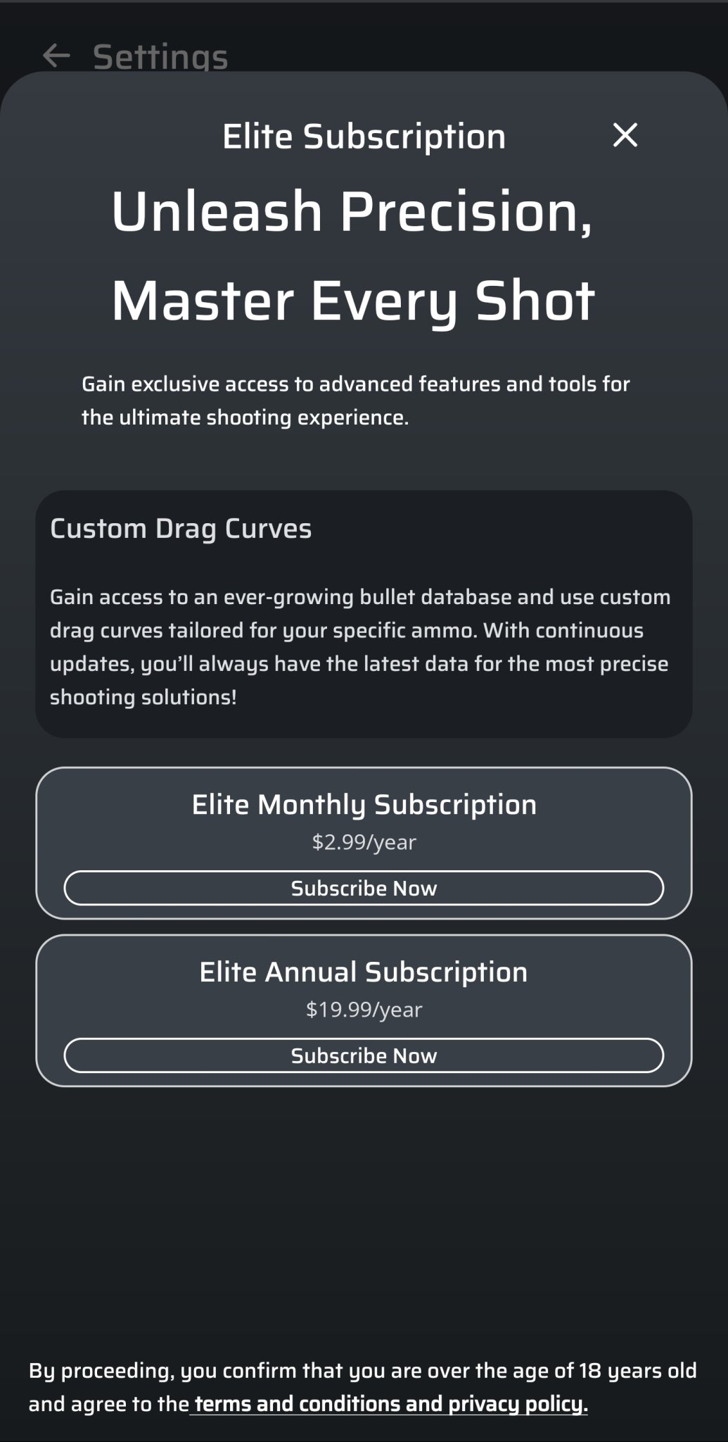

Found a typo... The monthly is 2.99/YEAR lol

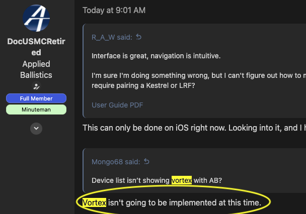

Also.. Will the Vortex Furys be compatible?

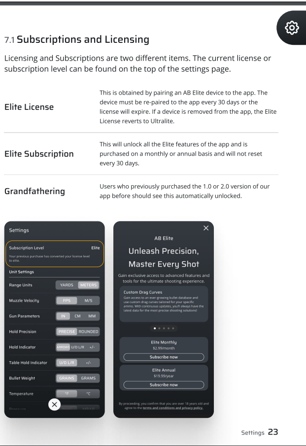

If you already have an AB Elite compatible device or paid AB mobile app, you should be grandfathered in and it's "free" (technically you already paid for it) for Elite, for a lifetime.
If you have an AB Elite compatible device, just pair it up with the app once and the subscription level should change to "Elite" in the settings. Also "lifetime" as long as that AB Elite device is paired up in the app.

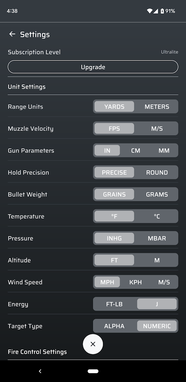

So I have a Kestrel 5700 that I upgraded to AB Elite status. I noticed in the device option that Quantum will not recognize the 5700 until January. Does that mean that I will have access to Elite features, instead of just lite, in January when the 5700 is recognized?
Try turning on the Kestrel and go into Quantum and scan for devices. Quantum won't be able to find the Kestrel let alone connect to it but for me, it changed my subscription level automatically to Elite.
AB Quantum user manual

Does the Kestrel have to stay connected to keep the Elite status?
I already purchased the annual subscription but I’d like to not have to pay for it again
If you connect any Applied Ballistics Elite device the Elite status stays for 30 days without ever having to reconnect. Past 30 days and you have to reconnect to refresh the 30 day time limit again.
I tried scanning but it didn't seem to find my Kestrel.
Yeah it won't find it but check the settings and see if the status changed. I'm also signed into Cloud Sync, so that might be a factor as well. Mine changed from Ultralite to Elite and I didn't do anything other than sign onto Cloud Sync and tried and find the Kestrel. I think I let the app search for devices for like 5 minutes without anything happening before I realized Kestrel connectivity wasn't implemented yet but I noticed the subscription level changed anyways.

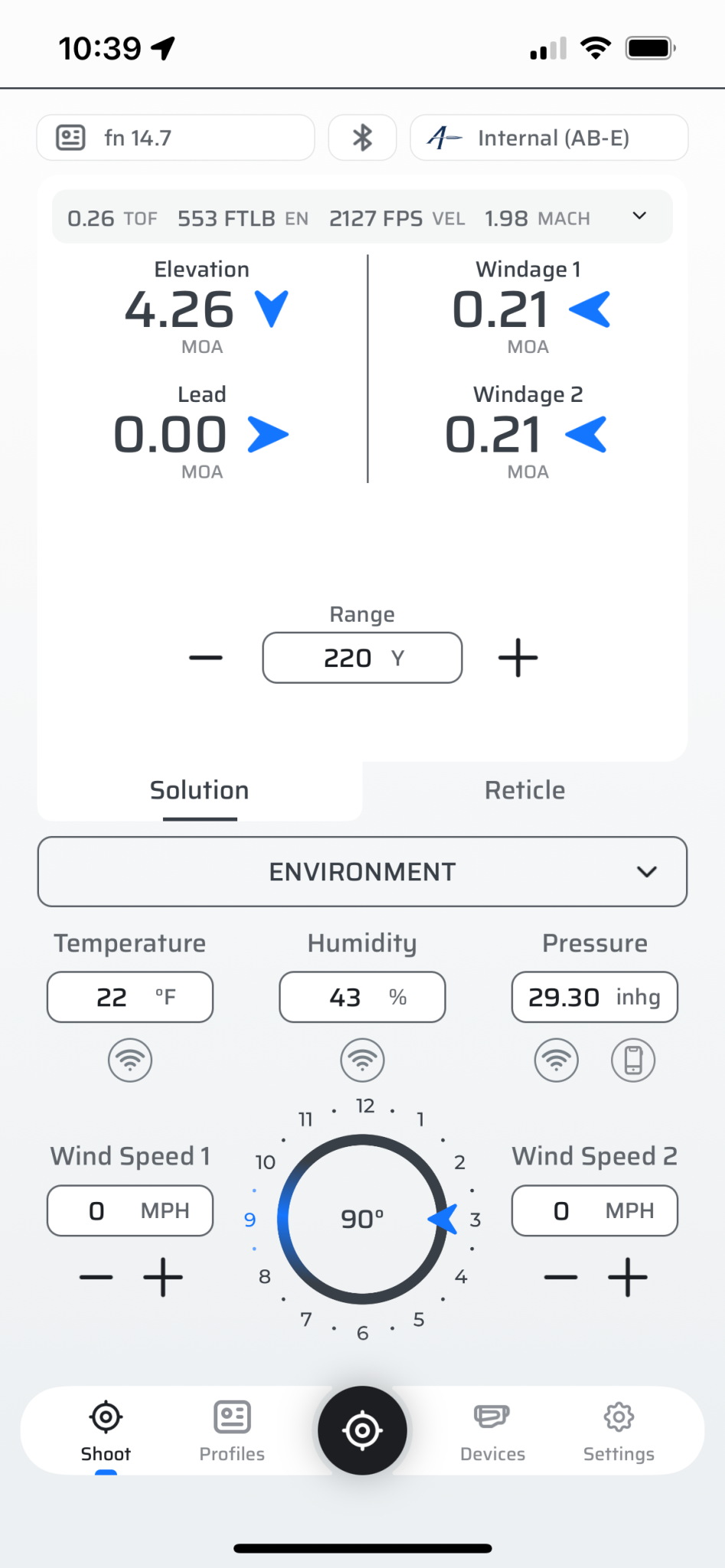

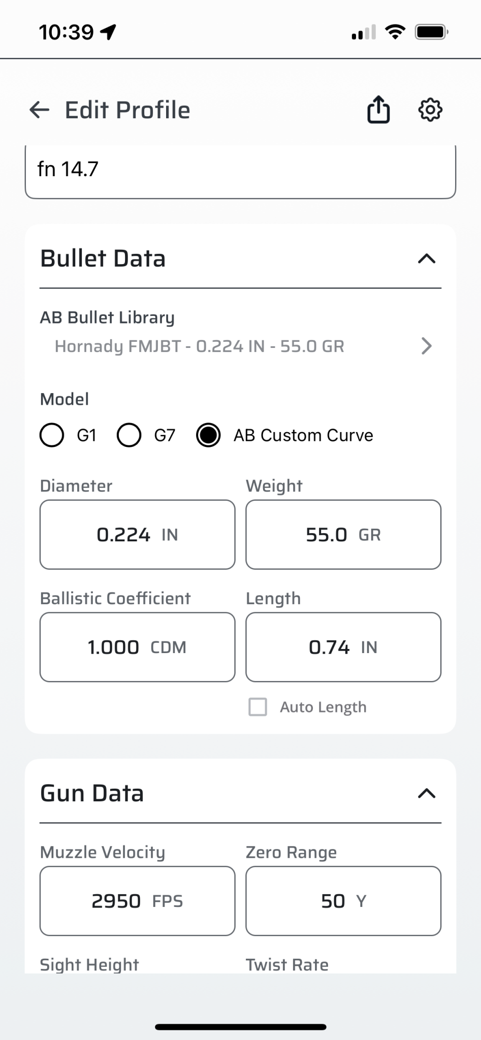

What am I doing wrong with this? The drops are all over the place and in no way correct.
I’ve gone back through and checked everything that was transferred over and it won’t give me a correct or even consistent solutions.

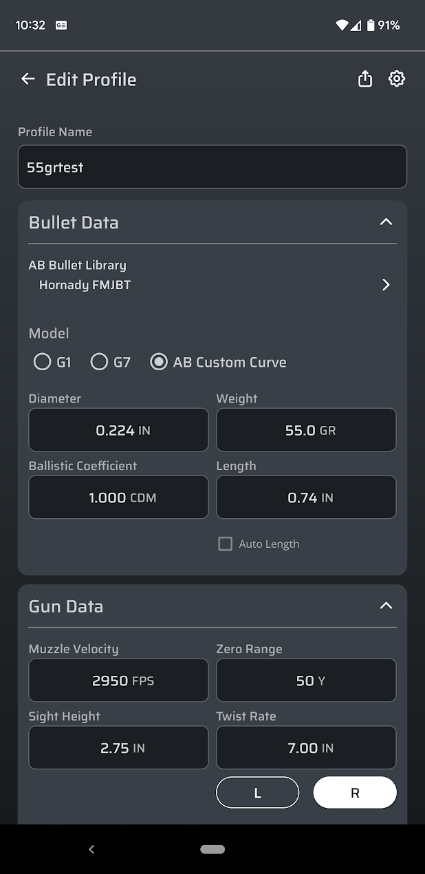

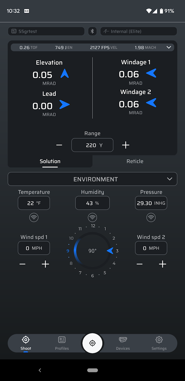

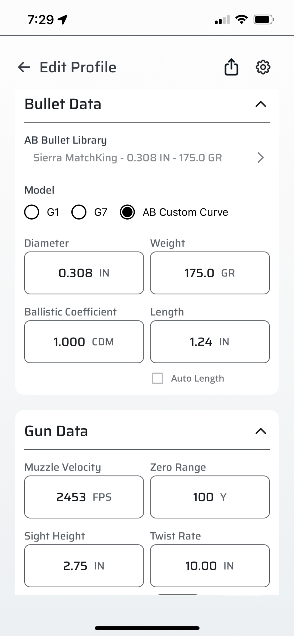

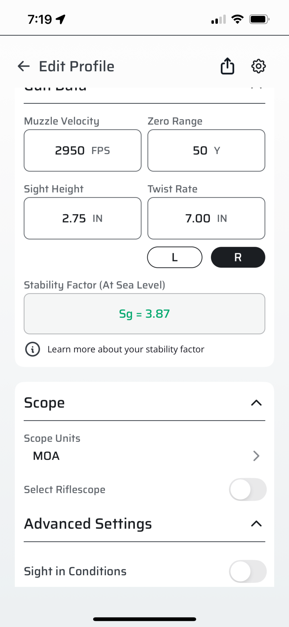

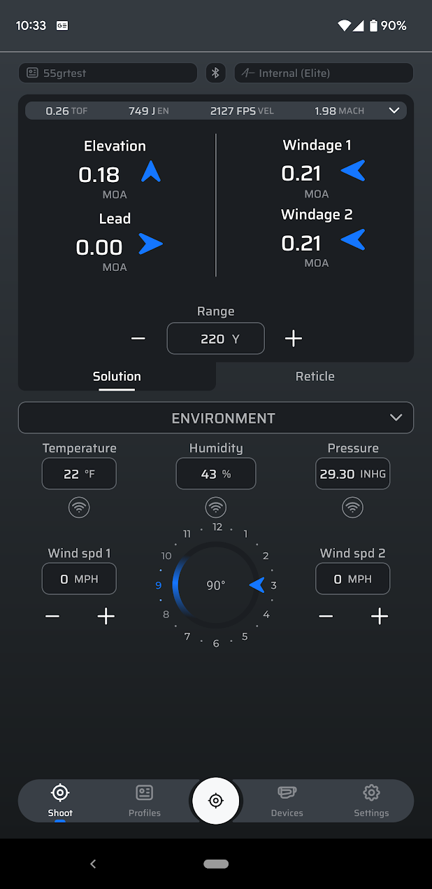

The first pic shows the solution it gives and the second is the inputs. It’s telling I need to come down from a 50 yard zero. I mean it should be nearly zero at 220. All of my profiles are like this. They were all brought over when I updated and I’ve gone through and checked everything.
What’s your sight heigh and twist

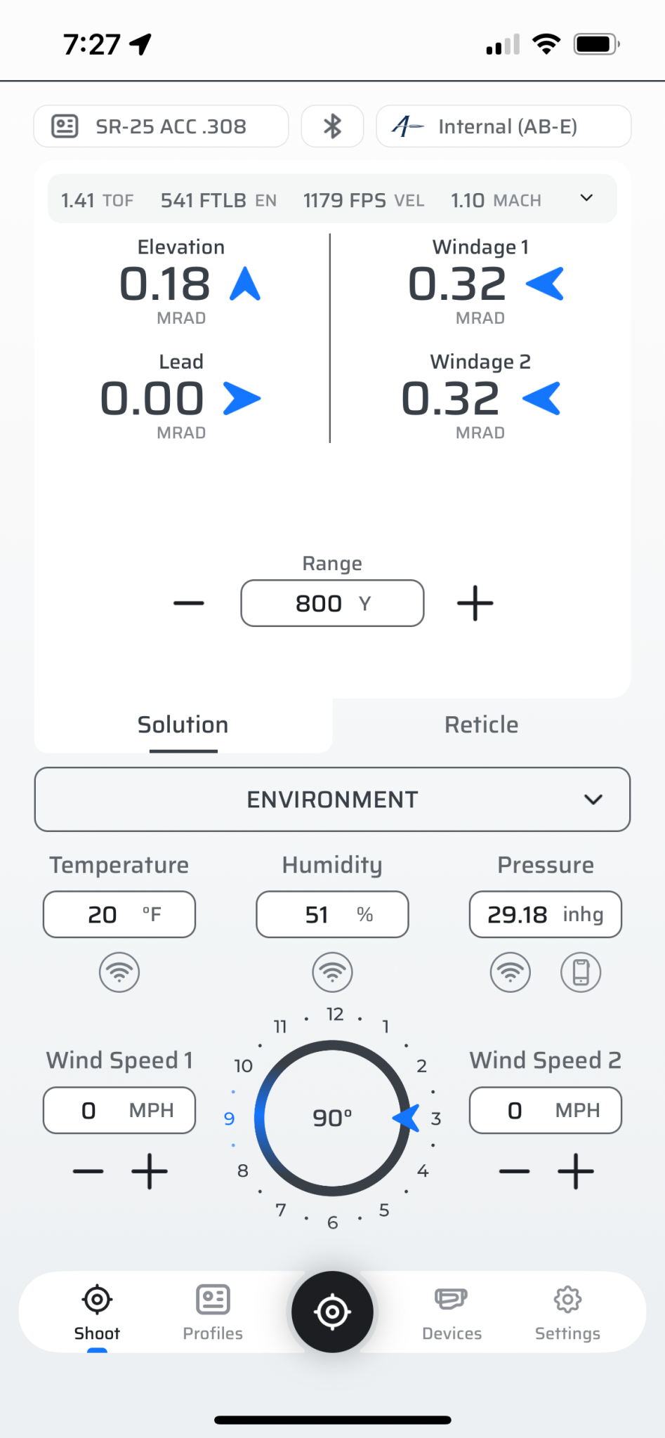

IMG_1153.pngIMG_1152.pngAnother example, only need to come up .18 at 800 from a 100 yard zero. I’m going to try and deleting the app and reinstalling it again. I’m also going to try it on my work phone to see if I can get it to cooperate.

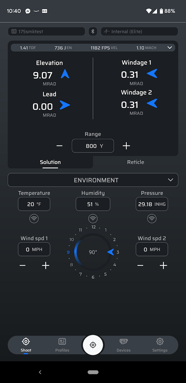

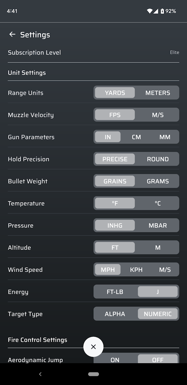

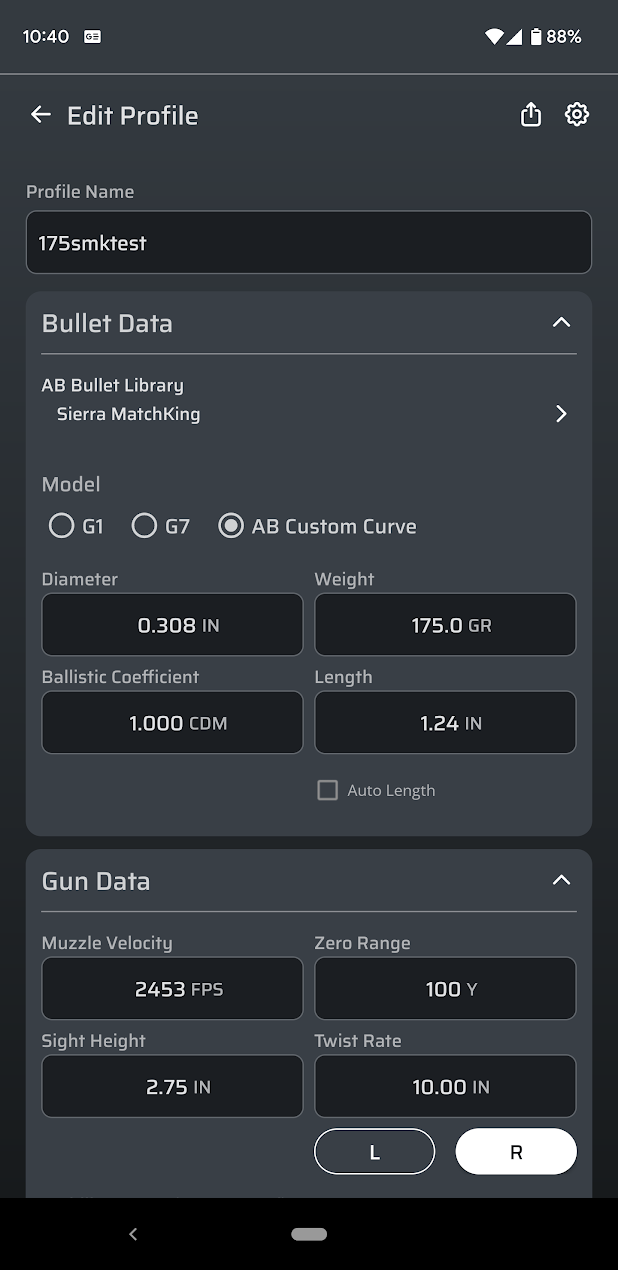

I tried your inputs for the 55gr and I got different results. Shown in both MOA and MRAD. Aerodynamic jump, spin drift and coriolis - ON
Edit 175smk test -

Found a bug right off the bat. Windage values aren't always getting updated automatically when I change the distance. When this happens, I need to touch the wind clock to get it to update them.
