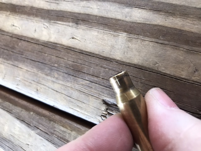

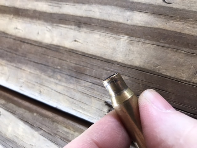

The marks are normal, the case neck is making contact with the barrel extension locking lugs.
