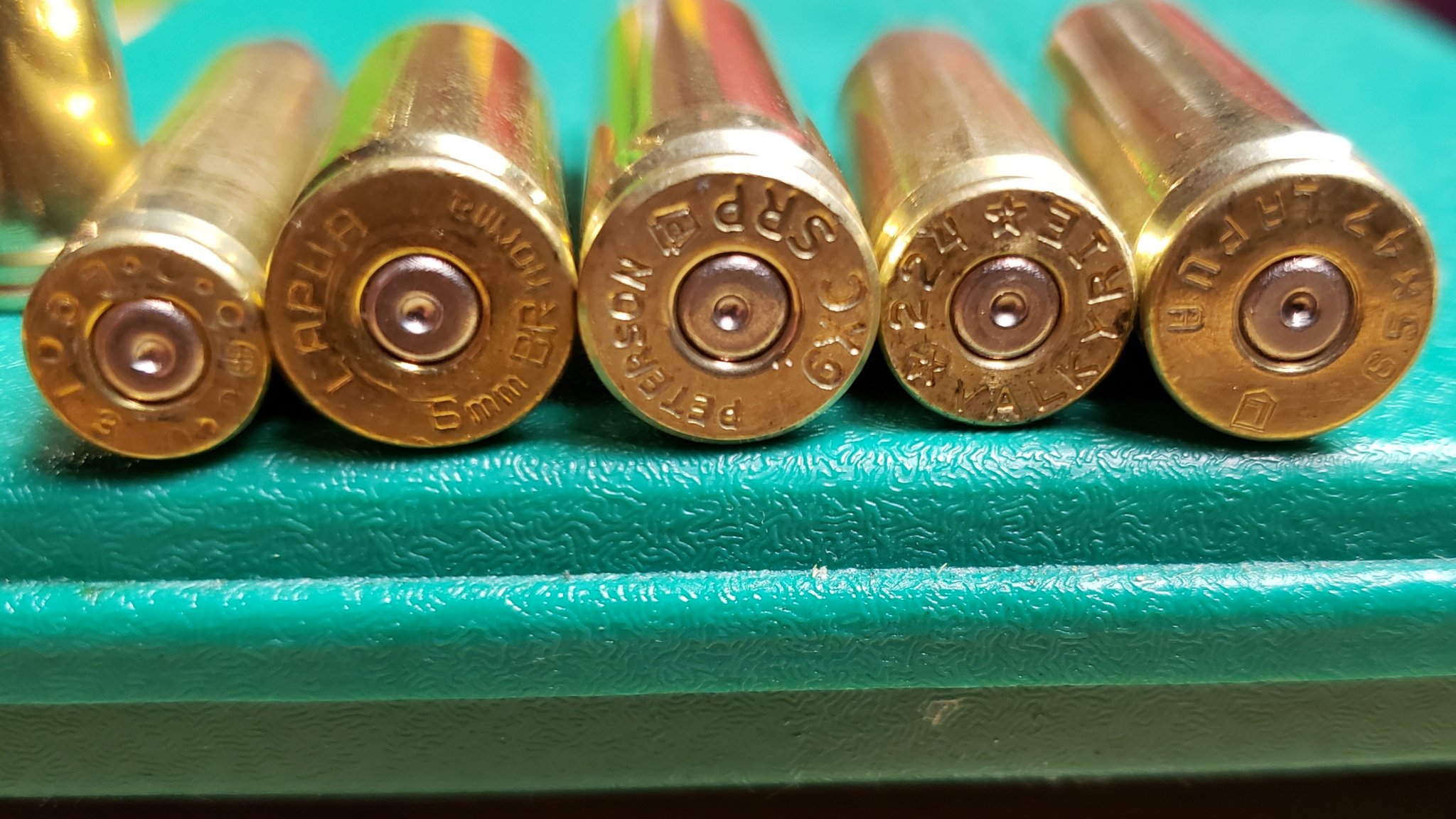

Thats what all of mine look like, they are from a Surgeon 591 action that the bolt has less than 1500 rounds on, when I switch to large primers everyone of them goes off.:rolleyes:

For reference I guess this what I got..still working on old dark blue boxes. Surgeon 591, Rem 700 and 2 dif lowers. TT diamonds on bolt actions. CE on one ar and a 667s on the other..

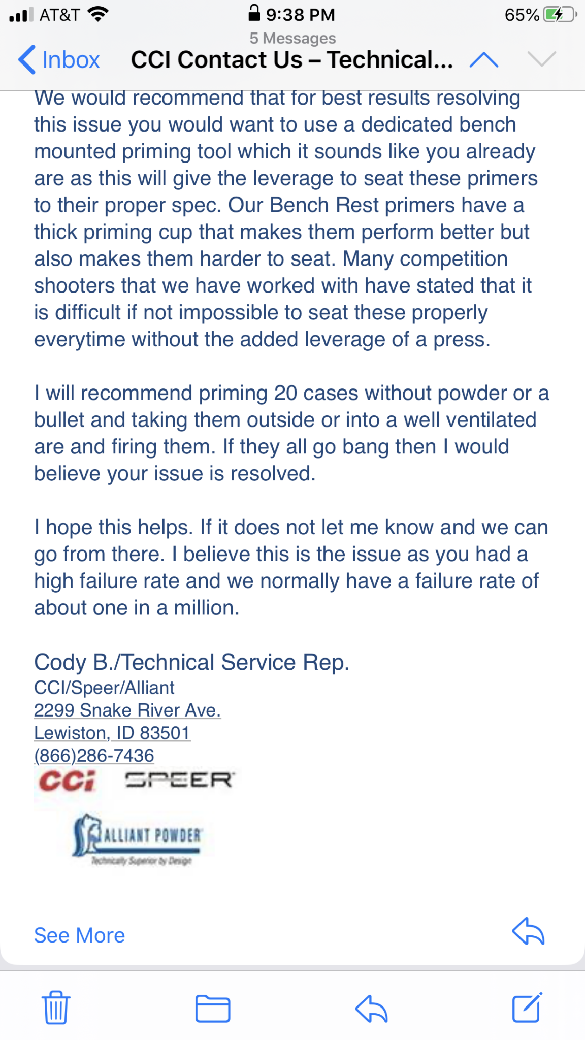

multiple emails to Cci and they said we didn’t know how to reload.

So I sent my rifle back to WTO they check everything and said that it was gtg. I went ahead and had Clayton bush my firing pin and put a Tubb spring in it, got it back and had 5 FTF in 50 rounds. I called CCI and they sent me a return with the instructions to prime 15 cases and send the 5 that didn’t go off. I will update the thread when I hear back
