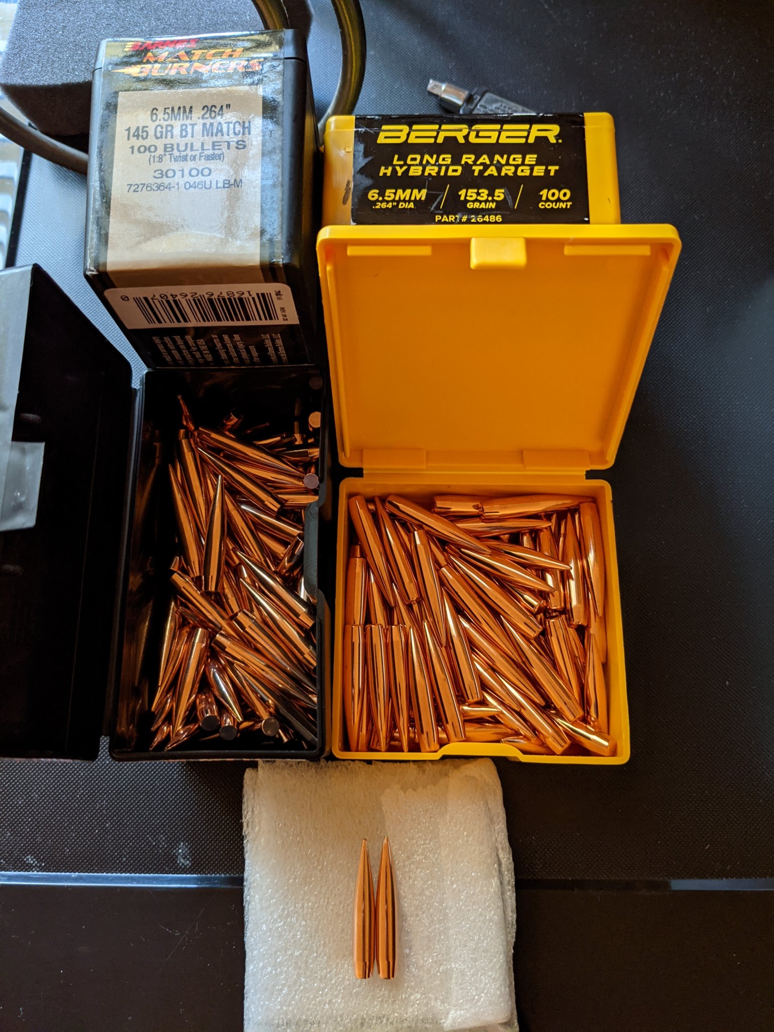

Ordering from Midway---
I ordered 2 boxes of the 100 count bullets (the max allowed) and two days later tried to order two more 100 round boxes but was not allowed. I called customer service and was told I had to wait 8 days before I could order more. I went out today and did some load testing with the bullets and was very happy. (smallest 100 yard 3 round group was 0.153 inches-largest was 0.75). I went back to the Midway site tonight and was able to order the 500 round box.

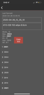

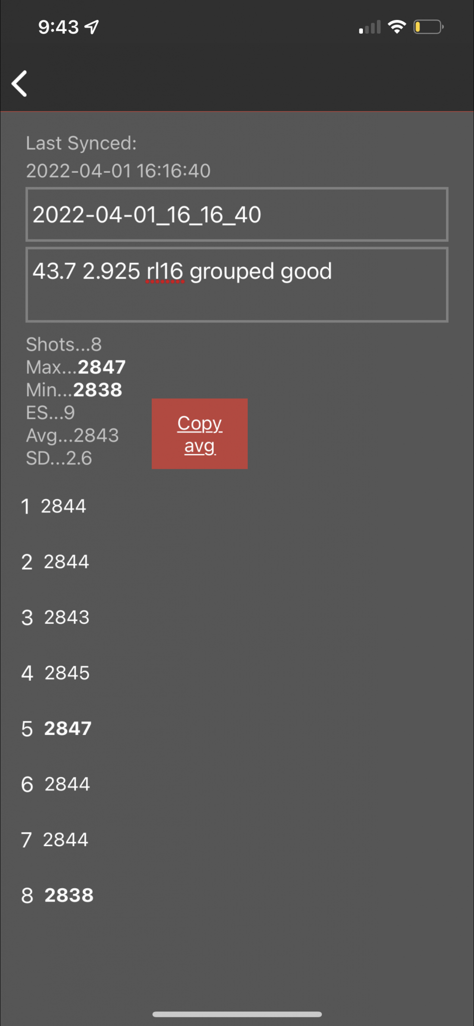

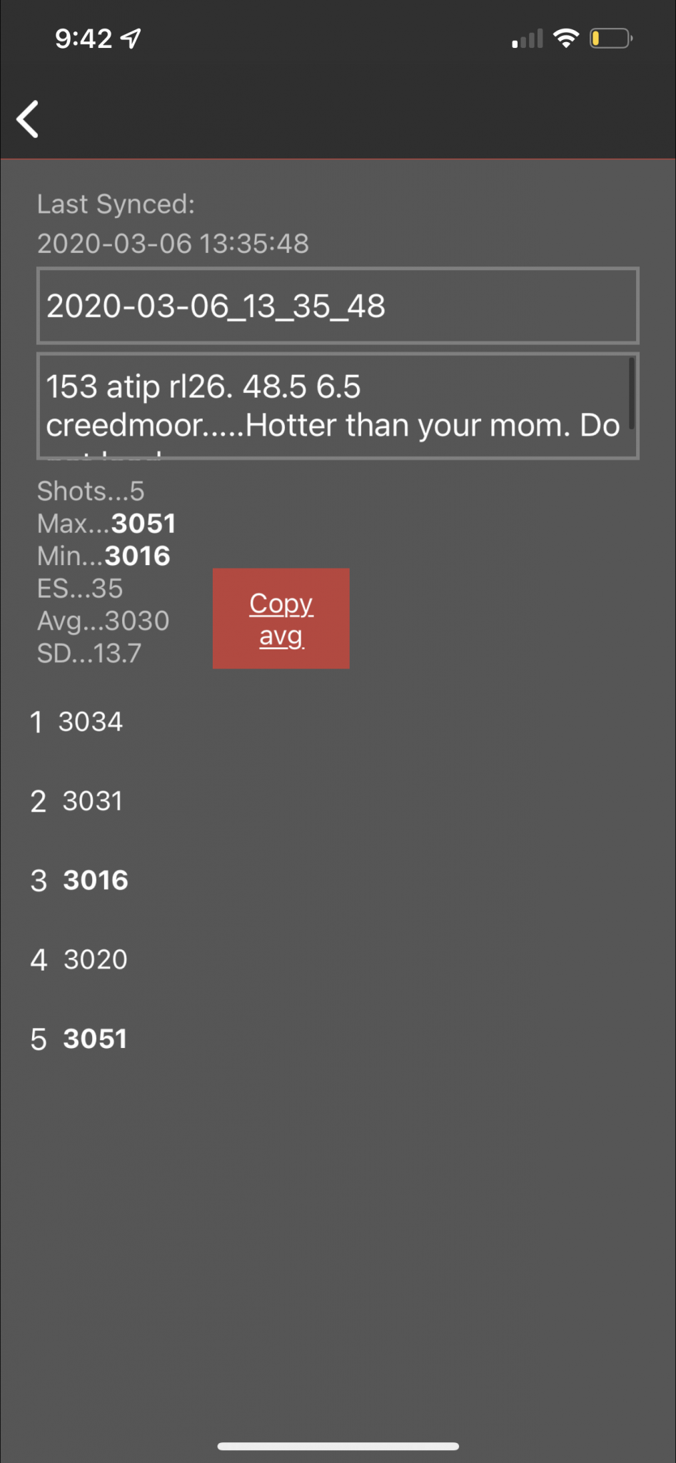

Suspect? I agree that I wouldn’t reccomend everyone pushing them as hard as I have tested them. That being said I know how to read Pressure on my rifles, one of the reason I pressure tested this to the max because I wanted to know the stages of Pressure in this rifle and how far it can go and what that Preasure would look like. I use quickload and grt I know where I am at. I have been running this rl16 load for years now and the 2910 have both been water tested no issues. However the 2910 load with rl26 I do not prefer when I can get a better load out of the rl16 in general.
The last screen shot is the Preasure test I did with the 153s and rl26 where the pressure was extreme and way over pressure, super heavy bolt lift and all those issues. However I know that if it can go 3050 fps without any sort of critical failure I know for a fact I can run 2910 without issues.
My barrel is 26inches.
At the end of the day I don’t let the sammi pressure numbers or quick load estimates dictate my loads, I let me experience loading and testing make my judgements, over pressure loads are easy to diagnose if you know what you are looking for. I don’t care if my loads is over sammi pressure, I care if the load is unsafe if that makes sense. Just my process and it’s not for everyone that’s for sure. But I can tell you the two loads I run at 2840 and 2910 are safe (in my gun, might not be in others)

Safe when? In the summer when its 100* or when its raining and chamber pressure shoots up.
At 70* 43.7 Gr of RL16 out of a 6.5cm @ 2.925 with a 153 grain bullet is over 76K PSI. Its also a compressed load.
That is not wet or Hot.
You are delusional if you do not understand the danger there. Just make sure you don't let other people shoot your gun, would hate to lose everything when they fuck themselves up.

Yes, where I live I shoot this load in 110 degree weather, and I have also shot this load in the rain. I even purposely tested a slightly damp round. for the rl16 load anyway. No my load is not compressed. Its close to it though, I don't get a crunch and can hear the powder.
Also if you are using quickload the rl16 data for the powder is a bit off. I forgot where I got it but someone posted the correct calculations for the powder and uploaded it. When I run it with the corrected rl16 numbers its not THAT high. I can't remember off the top of my head.

Zero trouble believing every word of this. I am less than 70 FPS behind you using Staball 6.5. i can see in my manuals that RL26 produces higher velocity than Staball, so it makes total sense to me. Also shooting a 26" barrel.
