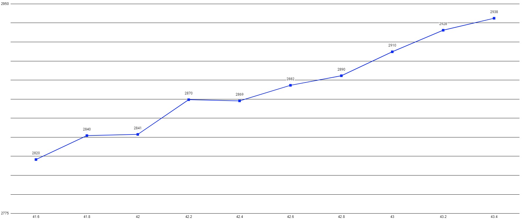

New Berger 6.5mm 144gr LRHT
That’s a lot of data. It’s interesting how linear the velocities are. I think a lot of people do ladder tests over chronographs with one round per charge, and then see flat spots on the graph that they think are nodes but are really just random fluctuations.
Yah I ran this a few times, just because those fluctuations are there. I think it’s worth it, at least for me... I’m still learning what to expect so the extra data helps me see that.

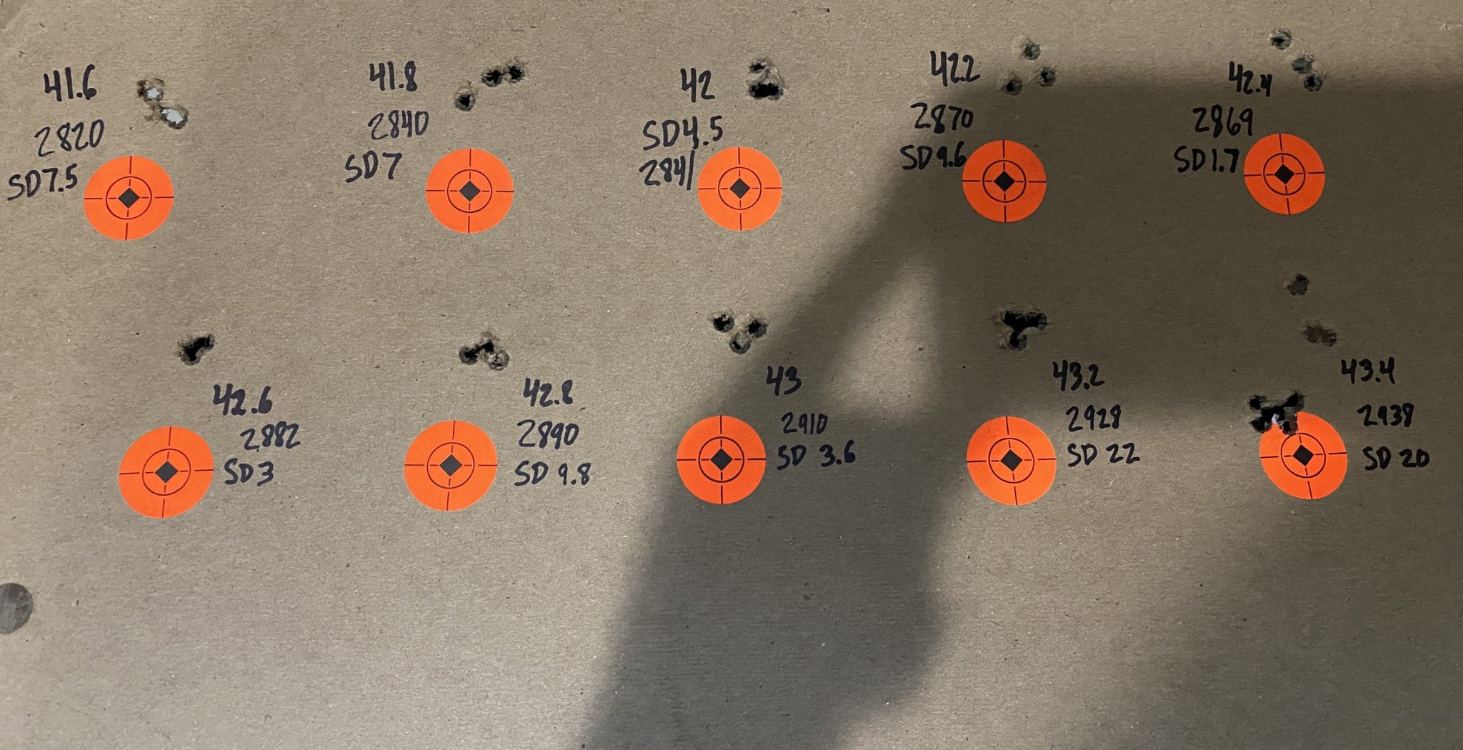

Picked up 100 of these to try as I just swapped barrels so seemed like a good time to swap bullets.
Lapua brass 1x fired
R16
CCI450
28” Bartelin 6.5CM loaded to about .010 jump and that was 2.92 COAL for my rifle
Loaded 3 shots for every charge weight to get more data than the single shot provides.
Was shooting pretty fast not really looking at groups just shot paper because I was curious about POI shifts
Saw no pressure signs for the entire string
What do you guys think?

I’m really thinking these guys don’t like as much jump as I originally thought(6.5cm). My damn chamber is cut to deep to stay mag length even without a binder plate. I’ve run these at 1 match so far, (48 thousandths jump) .3-.4, 5 round Moa, they did very well. They handle the wind very well also. Most of what I can compare it too would 142 smks, and it’s about 20% less wind hold. So far I’m very pleased with the round.
I called Berger on Friday and they stated that I should try 5 -15 thousand for seating depth in my 6.5x47. Testing will being this week.
Hmm that is quite the difference from when the Hybrids were first released and Bryan suggested .015 but said it did not matter and that was pretty much my experience because I shot them all the way from .010 to .150 in three different 6.5 creeds and noticed little to no difference in groups with the 140s.
R16
CCI450
I just ran mine this weekend. 6.5 CM, 28" Bartlein, RL16, CCI BR2 (better results over Feds), Peterson Brass (LRP).
Very similar results. Although I was seeing primers just starting to flatten at the 2920 range. I am going to run the 2840 to 2870 range again. Better SD's and easier on components. 50 FPS is not worth the effort, not alot of difference at a mile in my calculator. I also tried N560 and H4831 SC, I was hoping for more but they landed around the same speed running 44-44.5 grains, so going back to RL16.

My first real "ladder" test. From my results what would you suggest? I was thinking 42.3gr but also 41.9gr could be just as good. As far as the order of operations if I was going to try them at like 500yrds to see grouping at distance should I do that first or do a little seating depth testing first? Was thinking .005 .020 .040 and .120 - just because I have personally run the 140s at .040 and .120 before and had great success. I know some will say its a large jump but ain't nobody got time to be testing 5 shot groups at .005 or less change. My end goal is just 0.5MOA with sub 8 SD for ELR.
@dntworry I would just shoot the 42 load. I don't buy into the graphing method. Too many variables, esp if your load process is not 100% spot on with everything you do. I have gone to shooting until I see signs of pressure then backing off 2.5 grains and shooting in .2 grain increases for 1 grain. I just did 4 rifles, they all landed in that area. It is a lot faster method. Bryan Litz told me about it at Shot Show this year. I reviewed previous loads for multiple rifles, and they landed in that area too. I am running these at .025, it is where I do all my load development. If I have to do a seating test, I will start at .010 and go to .035 in .005 increments. I load a bunch at .010 and use a Lee hand seater at the range. I rarely have to adjust seating though. Your 42 group looks nice with a good ES/SD. I would run it. Shoot it at distance, get more chrono data as you go too, but that looks like the load.
Reactions: NamibHunter
I am game for anything that means less rounds used for load development. Using that method where did you end up with these?
I am not done yet, but looking like 41.6 @ 2865 is going to be it for me. I only shot 41.8, I was testing H4831sc and N560 at same time. RL 16 produced best results. 41.8 of RL16 produced a decent group @.68" edge to edge, running 2877 with ES of 15. I will back of a little more and run a test from 41 to 41.8. All the powders I tested produced good groups between 2850 and 2870 and again on the high end around 2920, but that is running hard, harder than I would like. Barrel life, brass etc.

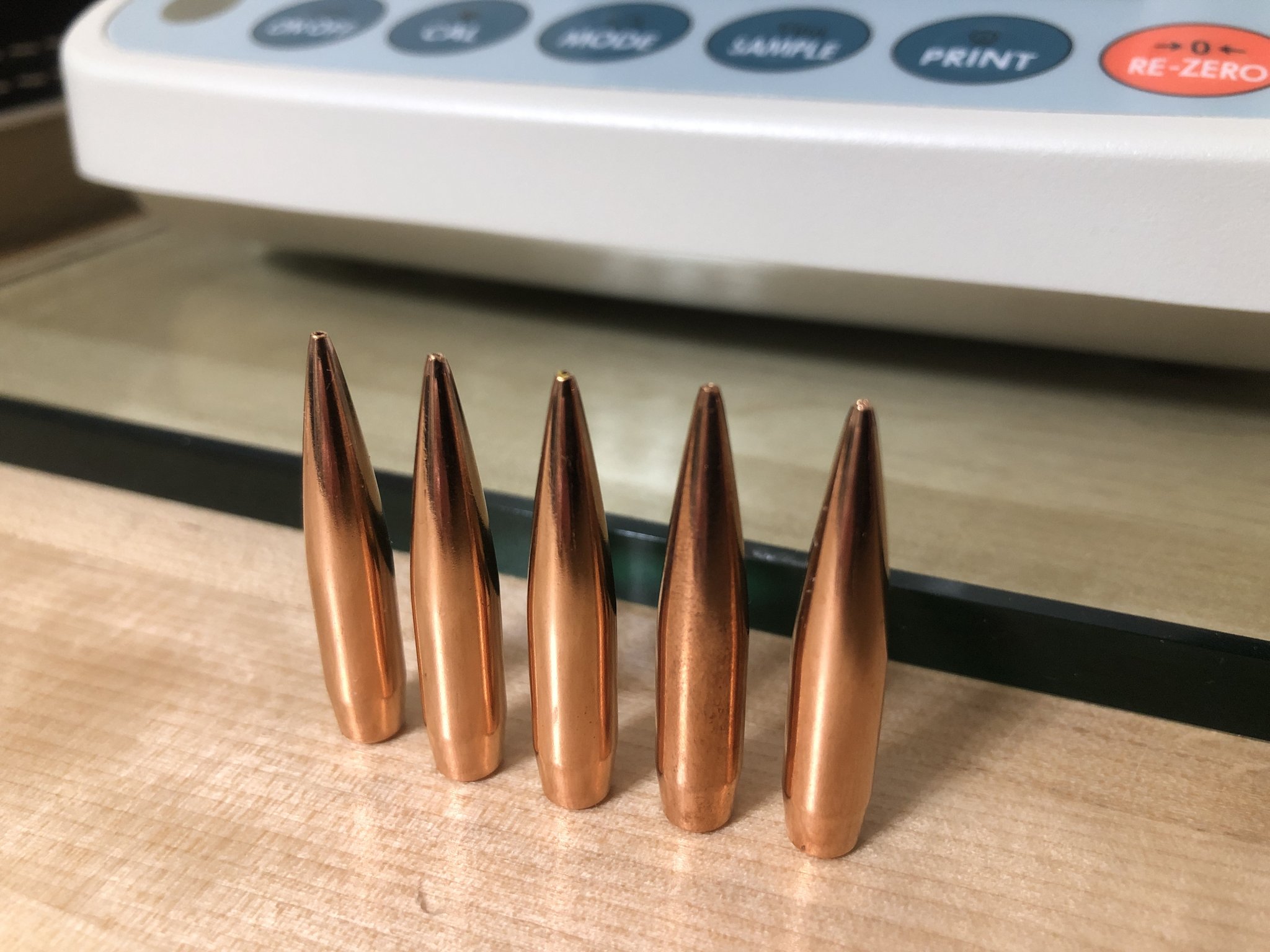

This is very good news.
Has anybody measured weight and base to ogive length, any SD or ES numbers to report?
.667” BTO
143.98 to 144.10 gr
1.410”-1.417” length
much shorter shank than my 142SMK

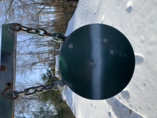

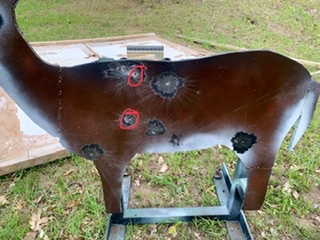

The round plate is 1000yds during load development, Reloader 16
The deer is 1760 yds. Circled in red.

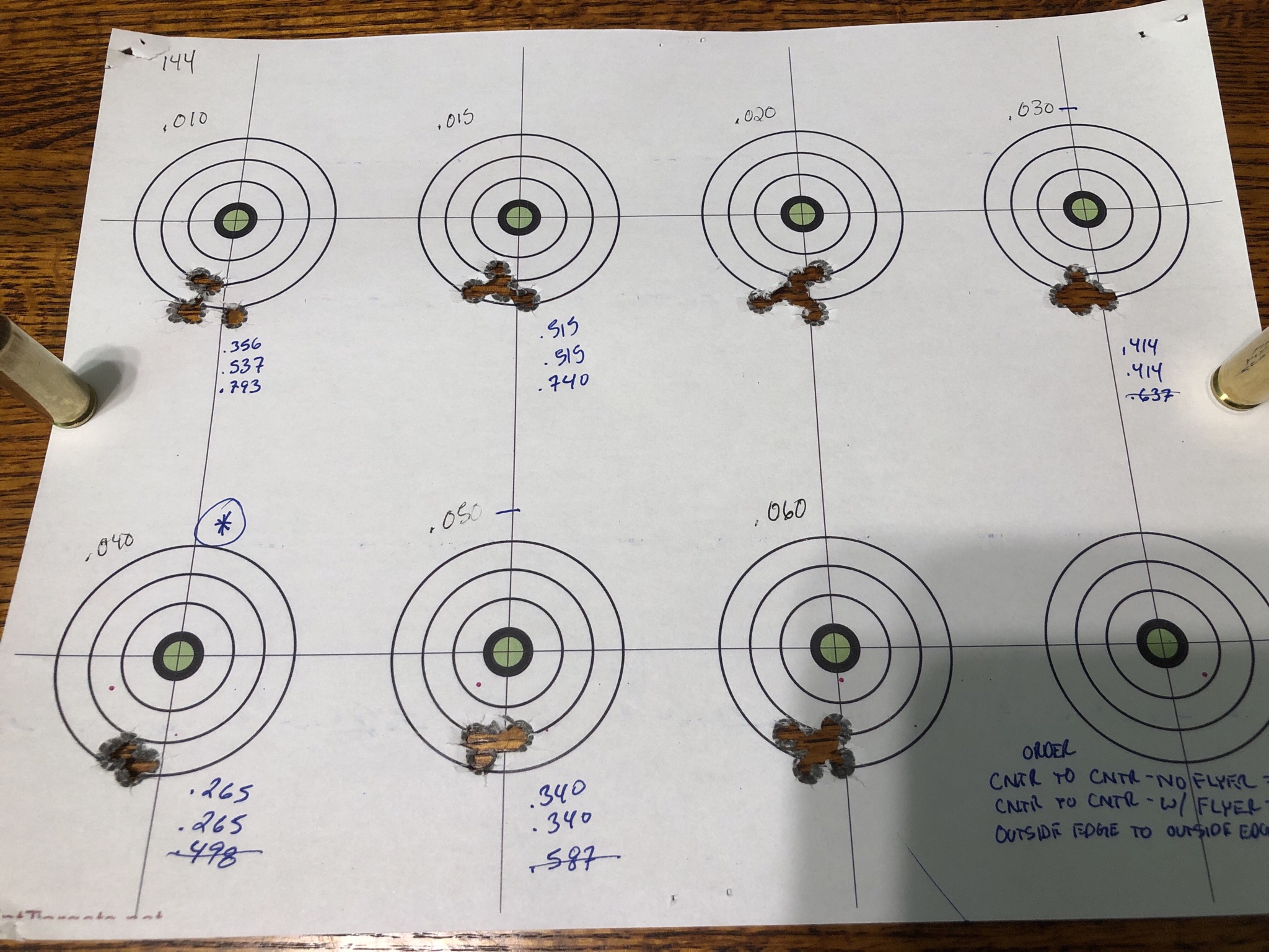

Trying these out in a new 6.5x47
5R Bartlein barrel, no turn tight reamer with .163 freebore - started at .010 jump into .060 at .010 increments. 1/4" target dots.
.040 jump gives me a COAL of 2.797 - with a cartridge base to ogive of 1.983 using the new SAC 6.5 bullet comparator.
Meplats are all perfectly even (no angled trims etc.) with a smaller opening than the 140's - there is a slight sudden angle around the entire circumference at the end of the nose to the tip, which is also extremely consistent - pretty easy to tell which is a 140 vs. 144 if you got a couple bullets mixed up.
Very little deviation in bullet weight, usually right around 140.02 to 140.04 for the majority, with an occasional 140.06 or 139.99x
Static safe charge of 38.8 with H4350 (only chronoed 1 round, 2nd shot through the barrel was 2675)
I'll do velocity testing next at .040 jump and see how fast I can get them moving.

Finalized the load at .040 jump and 39.8gr of H4350
6.5x47L - 27" Bartlein 5R 1:8 twist with an average MV of 2809
Wide jump node held at .030 to .060 with .040 still being the tightest and shooting bugholes.
Powder/velocity node from 39.4 to 40gr of H4350 (approx. 2784 to 2820 fps)
Started opening up at 40.1 through 40.3gr (approx. 2836 to 2848 fps) with 40.2 being atrocious; 40.4 tightened back up, but 40.6 and 40.8 (approx. 2866 fps) were also terrible.
