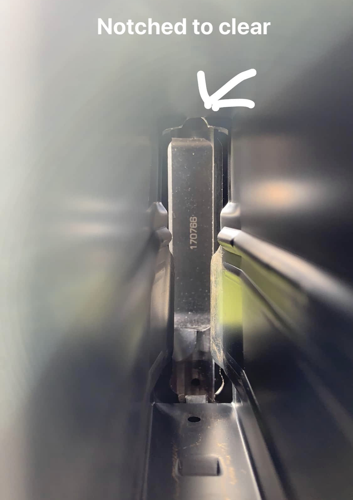

And a boring rem 700 can run that long if you notch it with a dremel.
