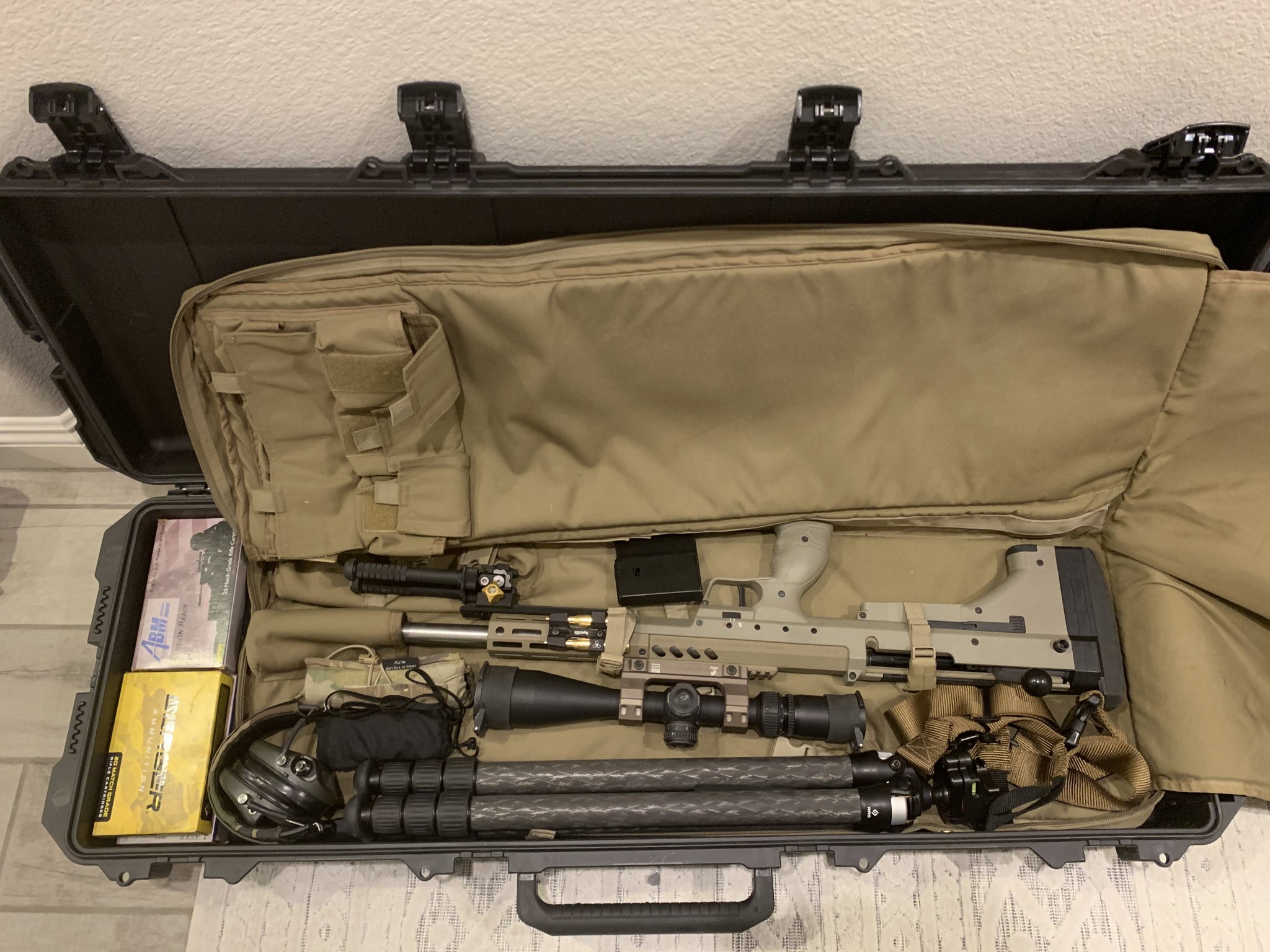

I have to be honest and say that I didn’t read every word of your original post because it’s a massive wall of text. That said, I was in the same boat a few years ago and ended up with the Desert Tech SRS-A2. Small package, easy barrel swap, great trigger, and shoots lights out. Not the lightest, but with a vortex AMG on it, it’s a bad ass hunting rig.
