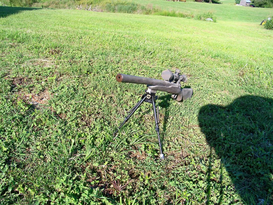

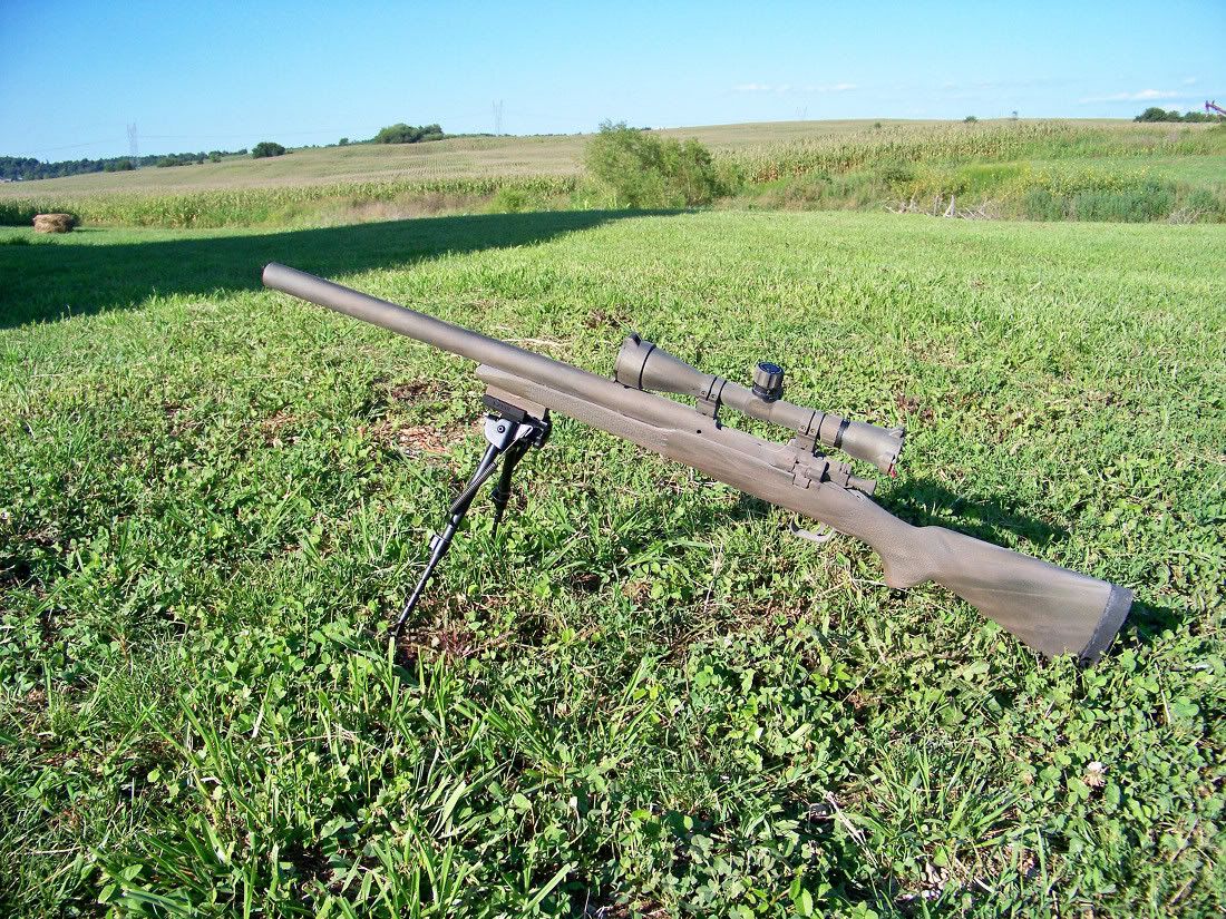

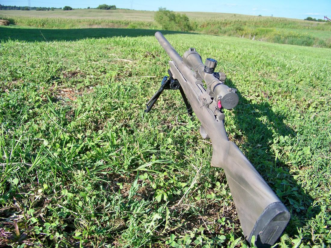

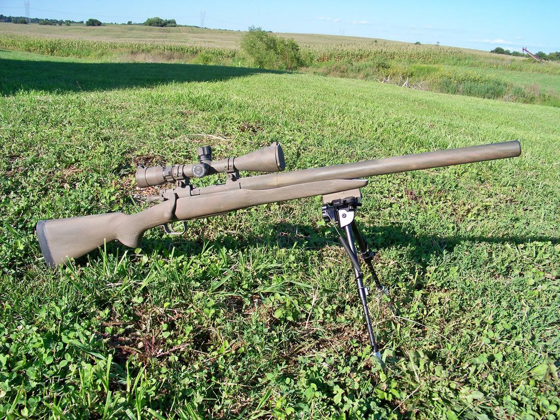

I just got my first precision rifle back from the gun smith and ran a few rounds through it.
It started off as a 7.62x51 Mann Accuracy Device from CMP. After a little machining a Bell and Carlson stock and Weaver Grand Slam Tactical was thrown on with a little paint. And it has already picked up a name, "The Heavy Bastard." Yea, I know I should have started with something simple like a 700, but whats the fun in having a normal gun?
I ran a few rounds of Hornaday Steel Match through it to sight it in and my best 5 shot group was 3/4" at 70 yards. This is my first really accurate rifle and I need some practice.
After the combine makes its rounds, my range opens up to about 600 yards.

I didn't shoot it before it was modified. As far as the barrel harmonics, my assumption was that its a 1.25" stainless bar stock with a little hole down the center. It shouldn't flex very much. The smith opened up the chamber and cut a feed ramp in it to aid in feeding.
