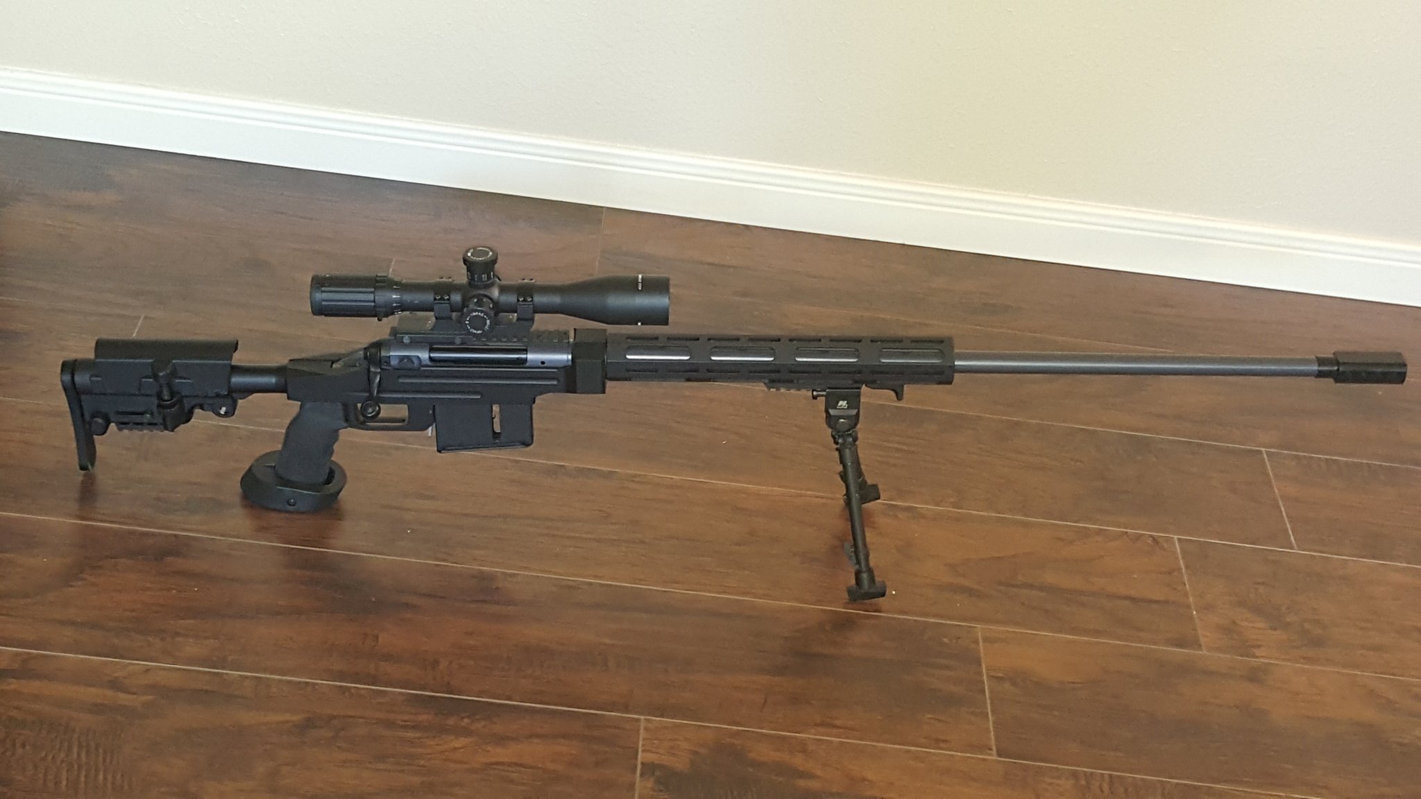

This is basically a fun mess around shooting gun, that is entirely too heavy for a serious hunting weapon. It sure shoots good and smooth though, like a big overgrown 22-250.
XLR chassis very nice! I have one of their carbon chassis that i put a Tikka 223 into. Very comfortable chassis and definitely not light.
Reactions: Bigdave1977
Yes, this rifle was my first one to put into a chassis. I have put a few more into a couple since. They are all better off the bench to me than a traditional stock.
