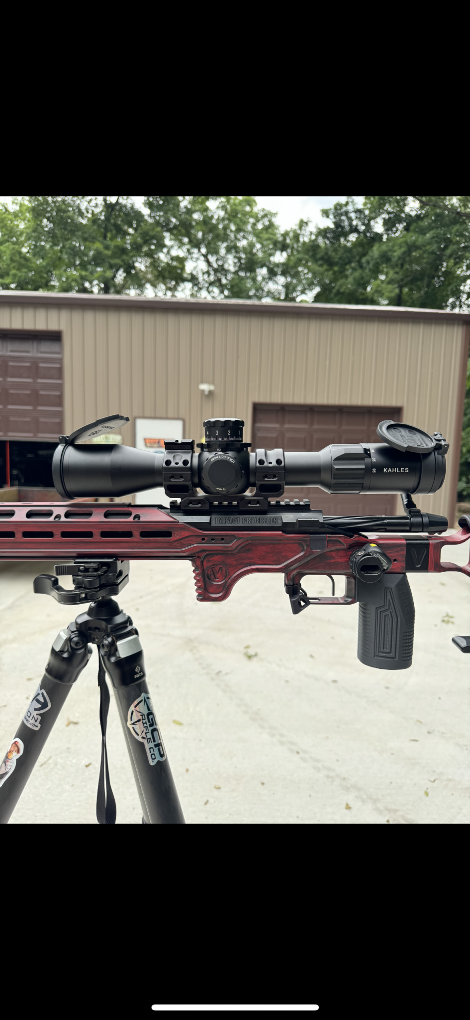

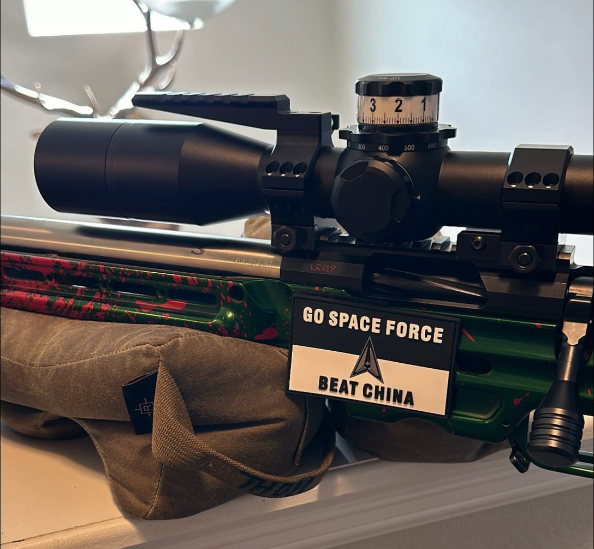

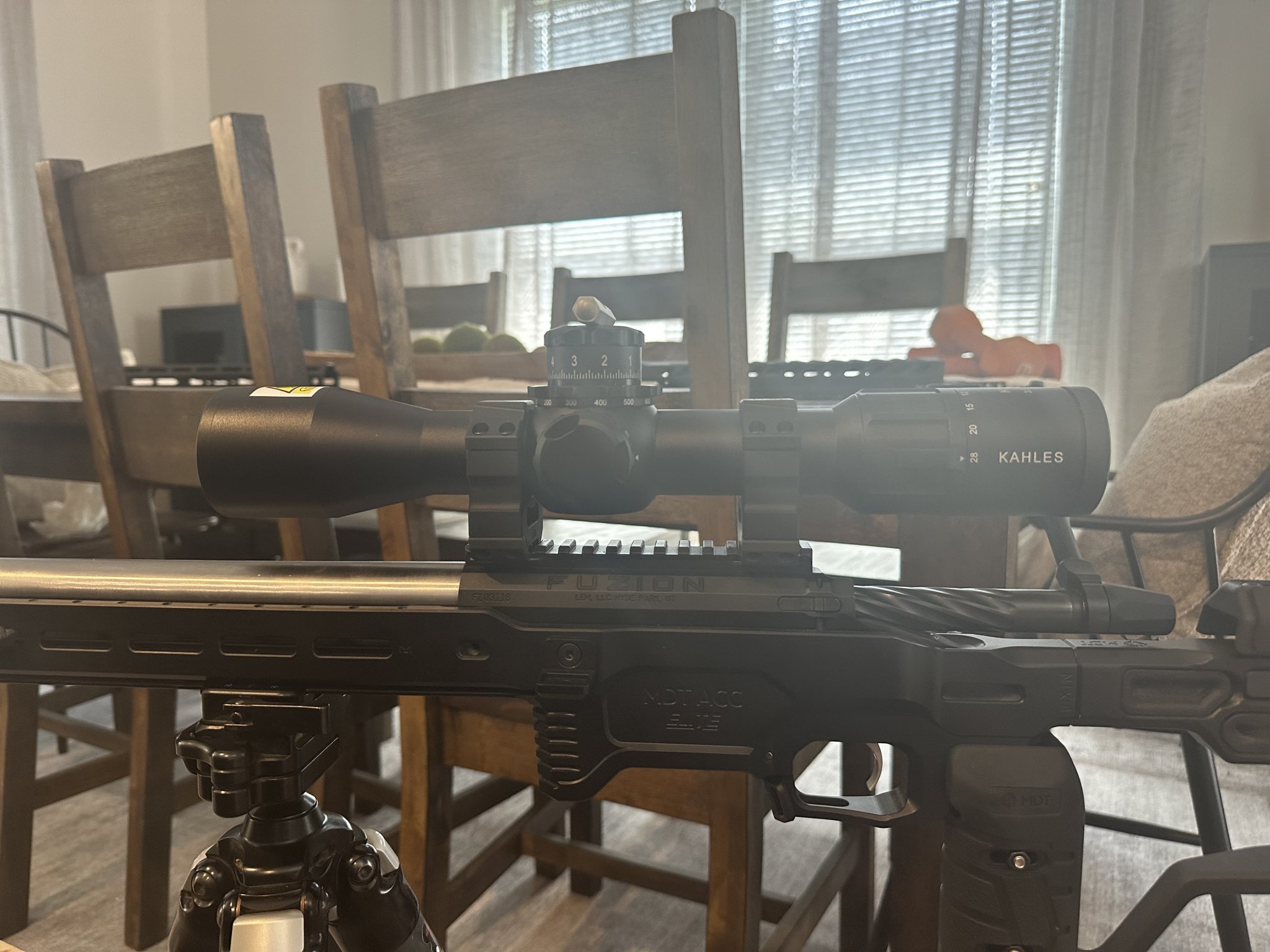

For those wondering what type of mount to use for this scope, here are a few examples of how I have mounted mine.
Spuhr 6001 (36mm 0mil 30mm height)
The k328 barely fits in this mount as there is a tiny clearance between the mount and the bottom of the scope. The canted version of this mount does not fit at all as it touches the bottom.
For actions with a short picatinny rail like an impact, lone peak or defiance this mount will not work for most people. However for those with longer picatinny rails that extend beyond the action it can work.
Area 419 one piece mount (36mm 0mil 32mm height) Not the cantilevered version.
Due to the placement of the fastening clamps this mount can work for most actions. I’m running this mount on a short action impact and have one available slot in front.

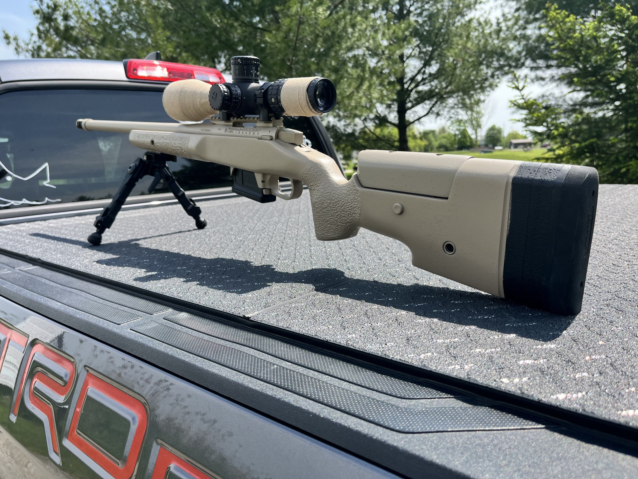

I was shamed into buying the K328i by my shooting buddies as I have an Arken EP5 on my McMillan
But if it shoots 1/4” groups with the Arken was my rationale

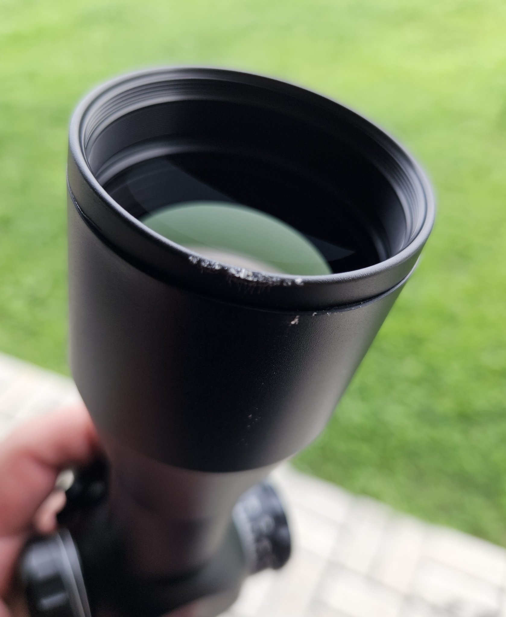

After 30 hours of 3D printing, 2 failed prototypes, and 1 dropped K328i later I managed to get a few ok pics.
I had a print an adapter for my phone holder.
I learned 2 things trying to get these:
  1. I make a terrible scope photographer
  2. The 328i handles a drop on concrete like a champ

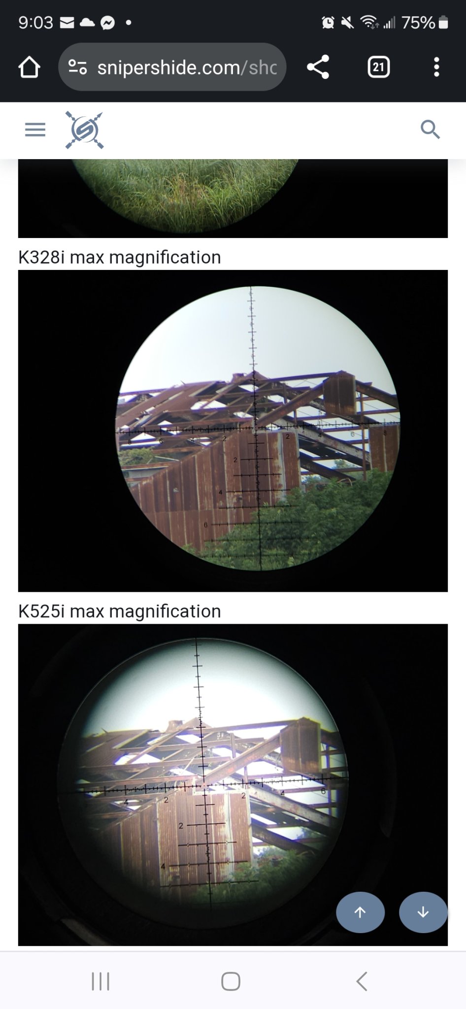

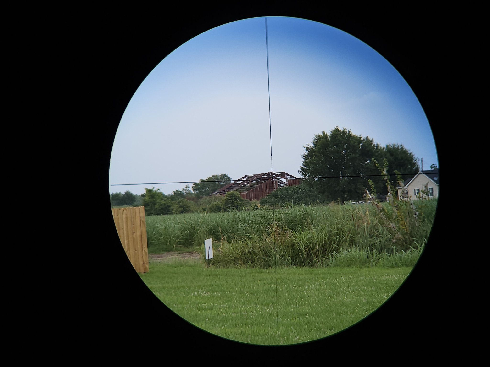

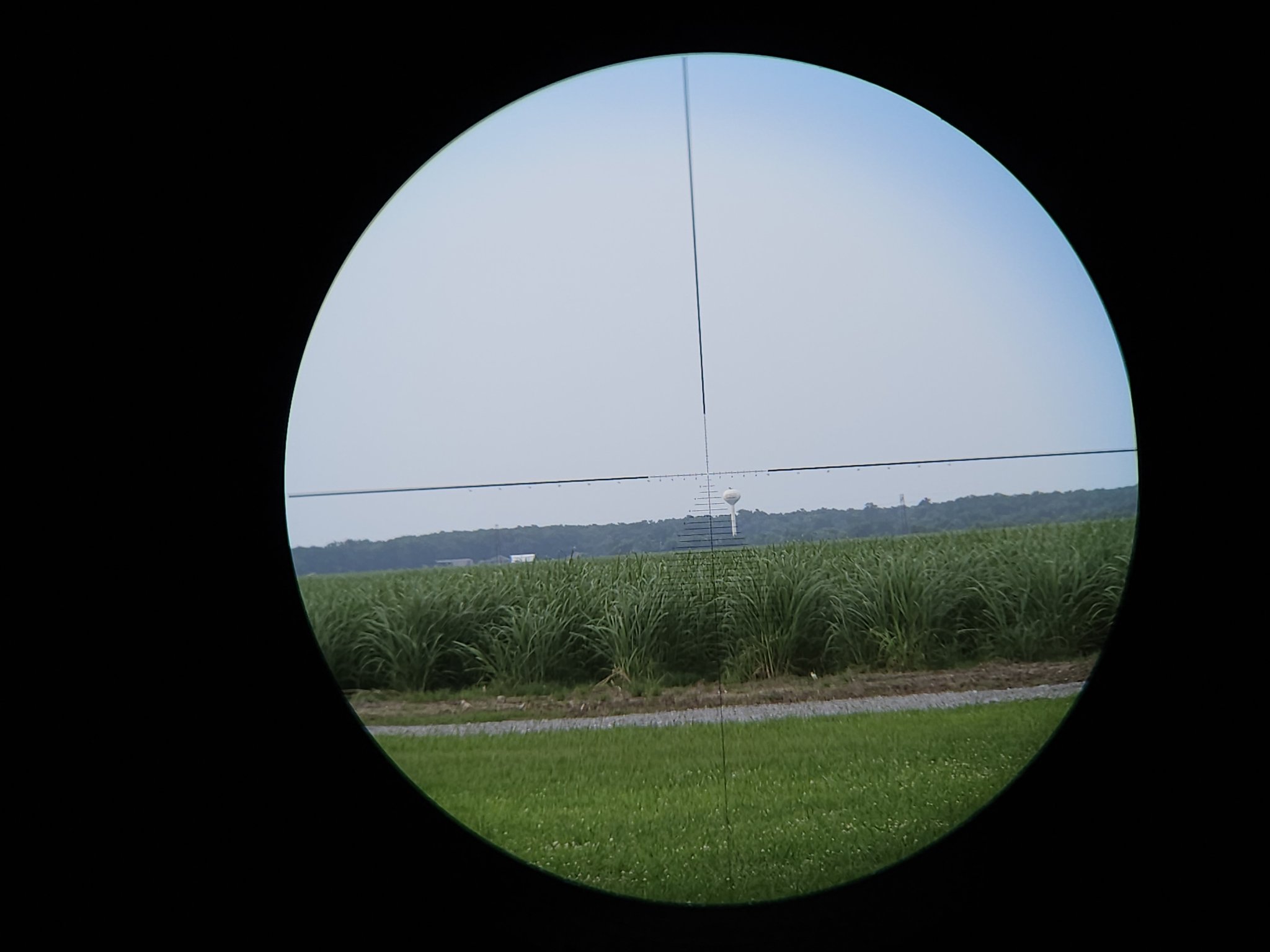

I'll echo what has been said before the FOV really is astonishing. Swapping between it and my 525i the FOV on the 328i quickly became the standard and became a feature I was “missing” in my 525i.
In addition the turrets seem to have a noticeably more tactile feel to the clicks and the DLR really helps get to that dope number quickly.
I also noticed how smooth the parallax adjustment was in comparison to the 525i and I think a parallax spinner would not be a necessity but maybe just a nice to have.
The eye relief seems to be more generous as well especially on greater magnification.
So that's my quick .02 here are a few pics.

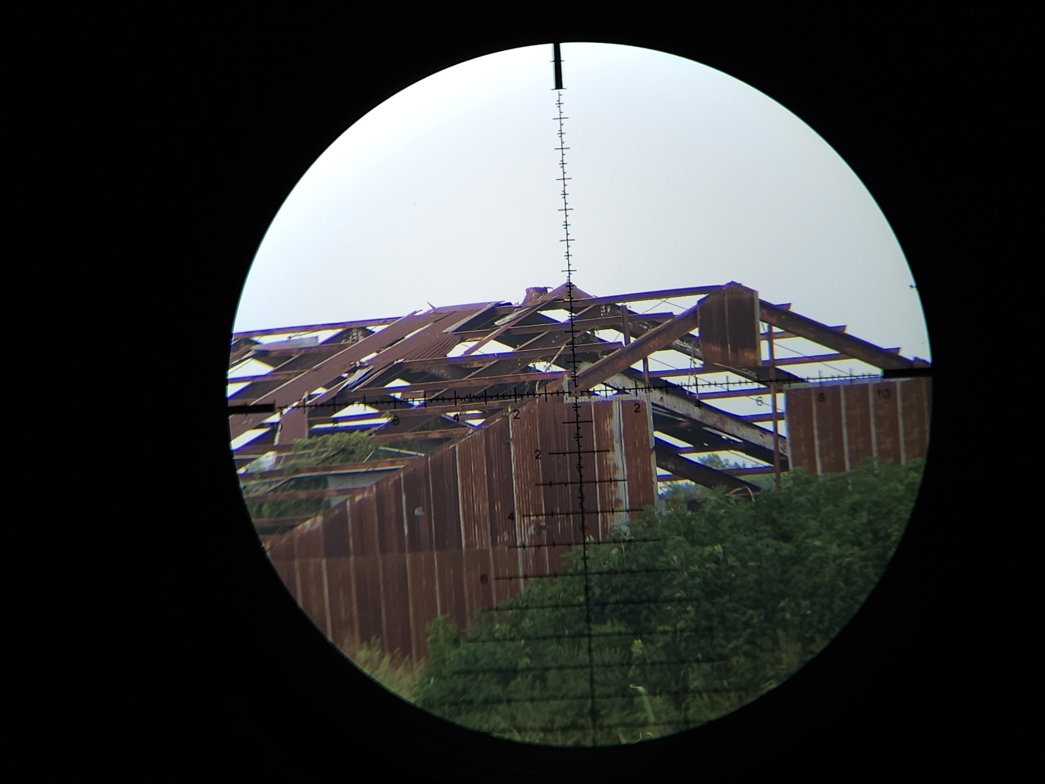

K328i min magnification, building @ 700yards
K525i pointed to the same location min magnification
K328i max magnification
K525i max magnification
K328i min magnification, water tower @2000 yards
K328i water tower max magnification, water tower @2000 yards

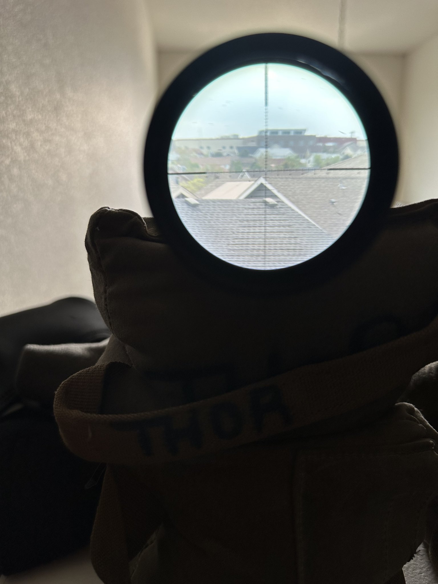

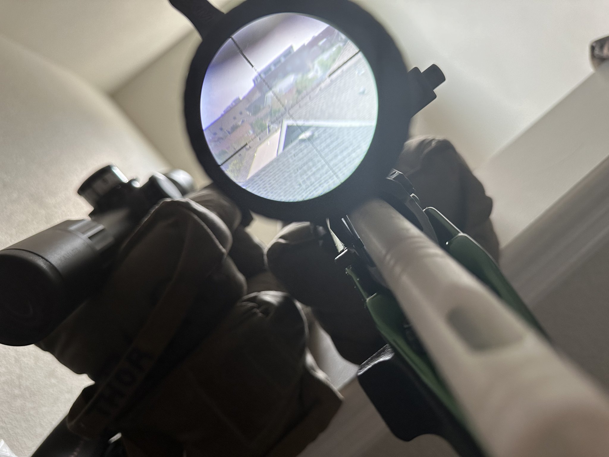

Is it just me or does the max mag pic of the building look like the 525 has more magnification? Almost like the FOV difference is because the 328 isn't actually 28x but like 20x?
Call me crazy but that pic through the 525 sure makes the building look bigger/closer at 25x than the 328 does at 28x
No. Pick some objects that are easily measurable. They measure the same mil through both scopes
And the center point to the 6ish mil mark is the same part of the building. But there's way more FOV on the 328
The camera also looks much closer on the 25x. If it has 40% more FOV, then why is the picture of the 328i smaller than the 525?
Its just an optical disparity. The math and physics make what you are saying impossible, unless he was not on 28x.
