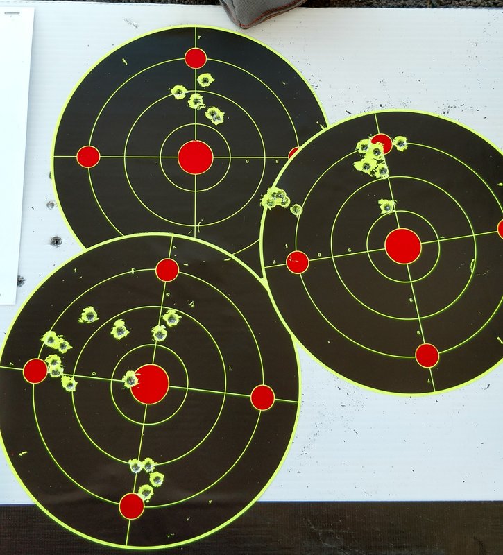

Today's Range Trip.....
The sun was out today so I decided to hit the range again this time I mounted the LaRue muzzle brake, did NOT clean my barrel from last Range Trip, and I also got a few boxes of that new Hornady 123 ELD black ammo. IMG_20170816_164447758_HDR.jpg
Target on bottom left was more of that cheap wolf gold 120 grain ammo, I had to re zero my scope due to the point of impact shift from the muzzle brake. Groups shifted up about 1.5 MIL and 2/10 MIL to the left. The group at 6 was my best group yet with the cheap Wolf Ammo.
Target on the top was shot with the New Hornady 123 ELD BLK ammo, it was just as bad as the cheap Wolf Ammo.
2434-FPS
2458
2471
2465
2463
Target Right group at 12 O'clock was shot with Hornady Match 123 A-MAX ammo, not too bad of a group just shy of .5 MOA
2510-FPS
2531
2525
2548
2527
Target right group at 3 O'clock was shot with my handloads. .5 MOA
2382-FPS
2393
2388
2385
2407 ( left this round in the chamber cooking due to a ceasefire for 5 minutes, was also my flyer)

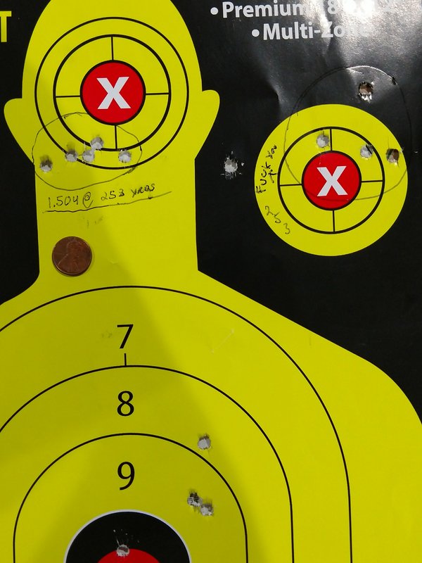

Dragged a Target out to the furthest berm which was at 253 yards, used center-mass to get my dope then shot the Target on the right of the head and finished up with a nice 1.5 MOA Headshot Group.

My upper hated that new 123 ELD Hornady Black ammo, and it did not perform as advertised, take a look at my Crono reading's. The Muzzle velocity stated on the box is higher when compared with the Hornady match 123 Amax ammo. But the results from the chronograph are quite the opposite.
Interesting. All of the other posts I have read elsewhere state that the ELD-M performs great out of these Larue uppers.
Well you can add me to the list of being underwhelmed. 123 ELD black did not shoot well, and neither did Alexander Arms 123 Scenar. I loaded up some lapua brass, 123 Scenars and AR Comp from 26.0 to 28.6 (one round each) and it "grouped" more consistent, lol.

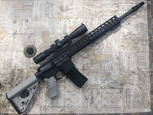

I ordered the 6.5 Grendel kit and I am really impressed. The way the rail connects to the upper receiver makes it feel like a monolithic upper. It was noticeably more solid feeling than my last upper. I have really only had the chance to function test so far but I am looking forward to getting it to the range. Apparently LaRue will be offering lowers to the people who purchase the kits. This is on the spikes tactical lower for now.
Also, they're now offering a similar kit for large frame. .308, 6.5 Creedmore, .260 Remington. Base price is $1200 bucks. Lowers will be offered 'soon'.
MSTN I ordered the 6.5CM kit in FDE, but after looking closely at the pictures on LaRue's website, it looks like the upper kits that are being sold were not originally designed with LaRue's own lowers in mind. They look much more similar to KAC uppers. After seeing that, I think I'll mount the upper on one of my SR-25 lowers instead of my LaRue FDE lower. The only saving grace is that LaRue will be selling stripped lowers at some point down the road, and I hope they match up with these uppers.
Without having to go and research it, what is the barrel and gas path length? It is certainly a well finished rifle.
18" mid length.
That's what I'm running right now. A decent mix. 1K is no problem with it. But, I would go back to a rifle gas length on my next Grendel build. 20" on the barrel though. No need to go to 24", you don't gain anything.
