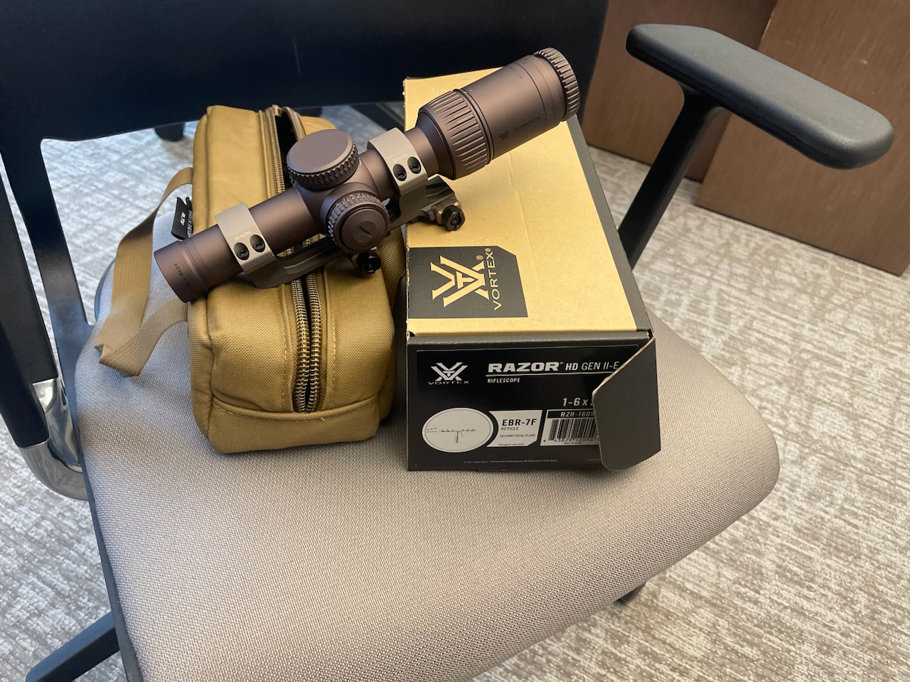

This is a really cool kit...Vortex Razor HD Gen II-E 1-6x24 EBR-7F MOA SFP Riflescope w/ Reptilia Mount & Armageddon Bag RZR-16099
These are super limited and once they are gone, they're gone. Currently in transit to us Due 3/28
**UPDATE** 4/3
There was misinformation about this unique optic. It is NOT a reptilia mount. The mount is a specifically designed Vortex mount.

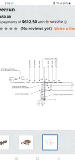

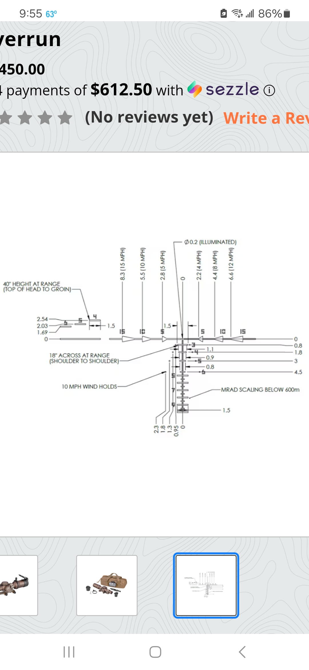

That's a very cool version. The illumination in this is diffractive, like in the Gen3, except it is in the second focal plane. They originally developed this version at a specific request of a military customer. Very few ever went out to civilians if any.
With diffractive illumination instead of a fiber dot, you can have an etched reticle with wind holds below center and more complicated reticle features.

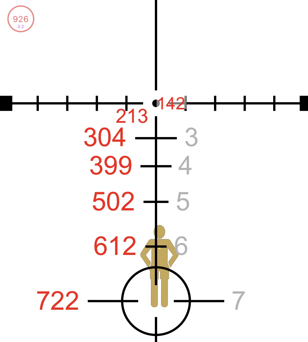

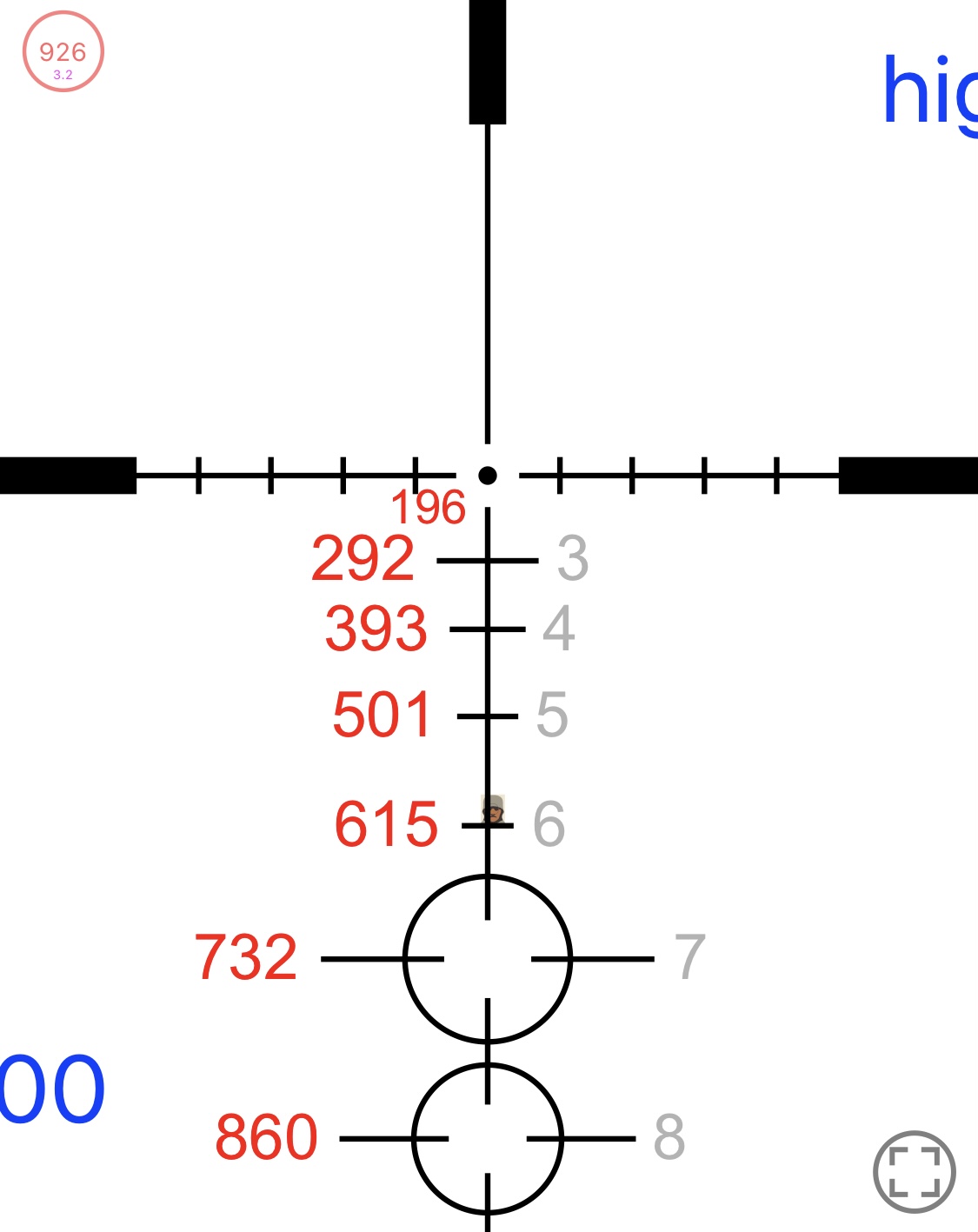

Why does anyone care what the turrets are in? It's a BDC for M855A1 out of a 14.5" M4. For this optic and rifle setup whatever you're doing can and likely should be done on holds. The turrets were likely specced as MOA for commonality with existing optics for ease of zeroing. The Aimpoint T2, Eotech EXPS3, and Elcan SpectreDR used by that unit all have 1/2 moa adjustments, so it does not make sense to issue a rifleman one optic that doesn't adjust like the rest. The mil scale below the BDC exists because with the intended weapon setup, you can't guarantee a BDC will line up well in all conditions at longer distances.
One advantage of the dedicated BDC over a LPVO mil grid reticle like a Nightforce FC DMX or the Vortex EBR9 MRAD is that you don't have to do quick wind math because the reticle has your wind holds in mph already, and you are unlikely to engage using the wrong row of dots because it's not laid out in a grid, each row is visually distinctive. Disadvantage is that you likely won't be able to get the BDC to line up well with other barrel lengths and projectiles besides 14.5 and M855A1 or M855. The distances for the BDC are specced in meters (expected for the Army) so it's slightly inconvenient if you're accustomed to thinking in yards.

Yeah, I agree it's a BDC and has all the consequent downsides. I use it with M855 (not A1) and the trajectory matches adequately (I have "trued" it out to 500m), the ammo groups adequately (consistent <2moa for 5 groups of 5). I'll be the first to say this is a critical limitation of the scope - none of the advantages of the reticle apply if you can't get it to line up with your rifle and ammo. Fortunately Eurooptic was able to get Vortex to publish the exact MRAD subtensions so you can run the #s in AB or 4DOF.
Environmental conditions vary but people seriously overthink that aspect of BDCs - for a 1-6 LPVO if it's cold out / high air density, favor high on target and hold more wind. Hot out / low air density, favor low and hold less wind. The BDC has some other advantages, because of it, they were also able to put mover holds on the main horizontal stadia (which is where the intended zero hits out to 200m) and simplify those engagements as well. It's essentially a very fast point and click reticle for the intended setup.
Also, look at the MRAD reticle Vortex offers in the commercially available version of this scope. It's not terrible but because it's a wire reticle, they couldn't number the hashes and there are no wind dots - it's more prone to error. It's just that for a 1-6 LPVO (arguably the fastest one on 1x) most people aren't worried about that stuff.

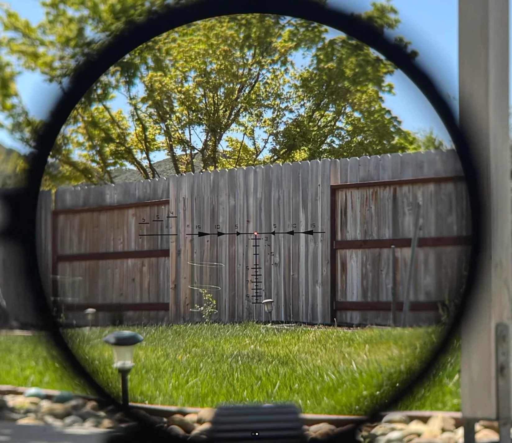

I appreciate any opportunity to nerd about about this scope and the reticle design, in my opinion it's been somewhat overlooked because buyers have been fed the line that they must have mils at all costs and that any BDC or BDC-style reticle is the devil. Most people are not shooting blind stages for speed (or similar outside of match context) so they are accustomed to having time to range targets, prepare elaborate dope with wind brackets, dial dope, and memorize a series of holds in advance. As a result they don't realize how much simpler this is where you can drop down into position, range a target through the scope (staying in your firing position) and know your wind hold just by estimating wind in mph vs doing math.
Even for non-military shooters there are intelligent ways to get some of these advantages in a scope that will match a variety of setups (i.e. tremor 8 style reticle or tremor 7) but they don't seem to be catching on. In my opinion for a <=16" 5.56 gas gun, the mil grid reticles in many LPVOs are somewhat overkill.
