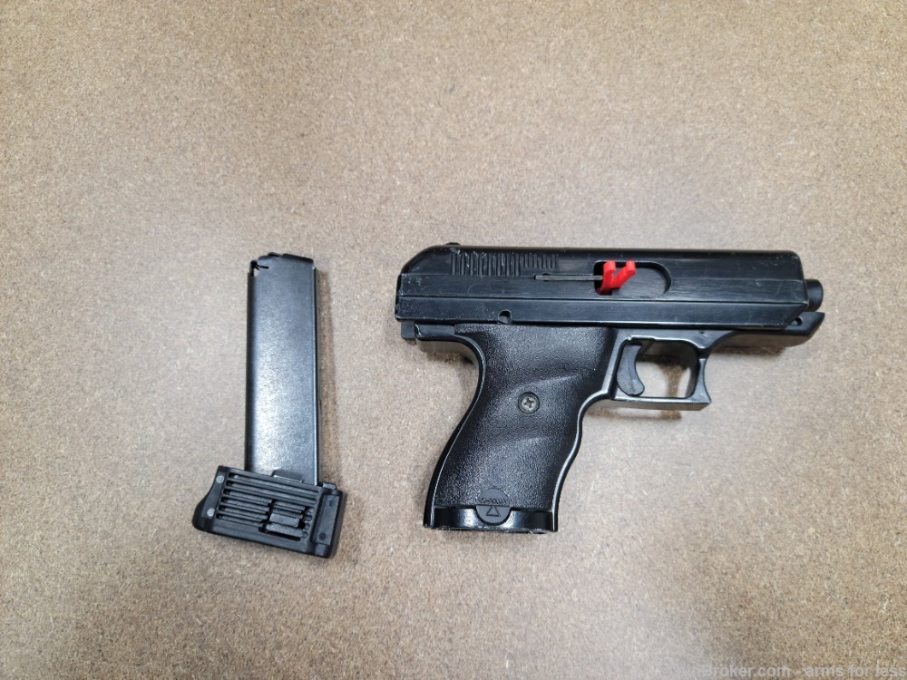

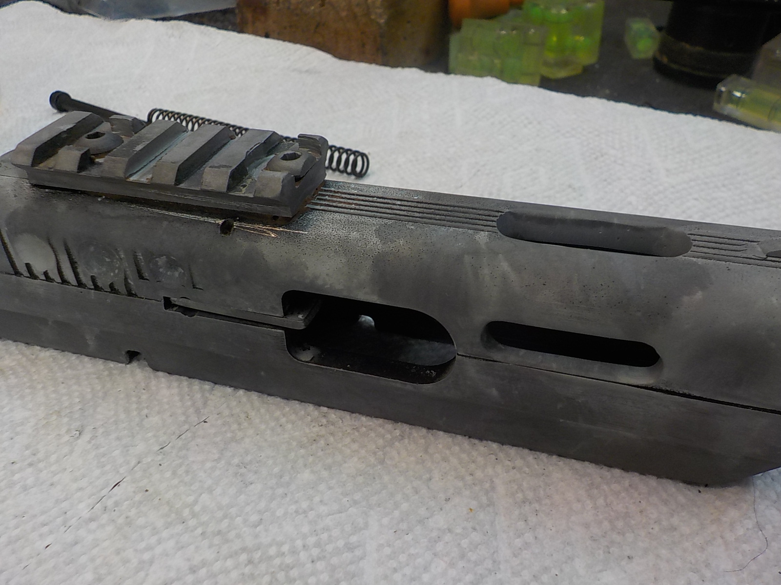

    I bought a vintge Hi-Point...serial number 001103...and I'm going to see what improvements can be made. Hideously ugly and clunky...but works every time and an interesting design. Paid $100 from a pawn shop and the gun worked fine. II Ddd find a bent firing pin upon disassembly. Hi-Point customer service is great...they answered the phone, got me a tech because the gun is so old, and are sending me a new firing pin assembly and some other parts, no charge. So, drill and tap for a picatinny rail for an optic, hone the trigger, lightening cuts in the slide, open up the trigger guard, maybe port or put a brake on the barrel, new grips, and custom Cerakote are on the to-do list.

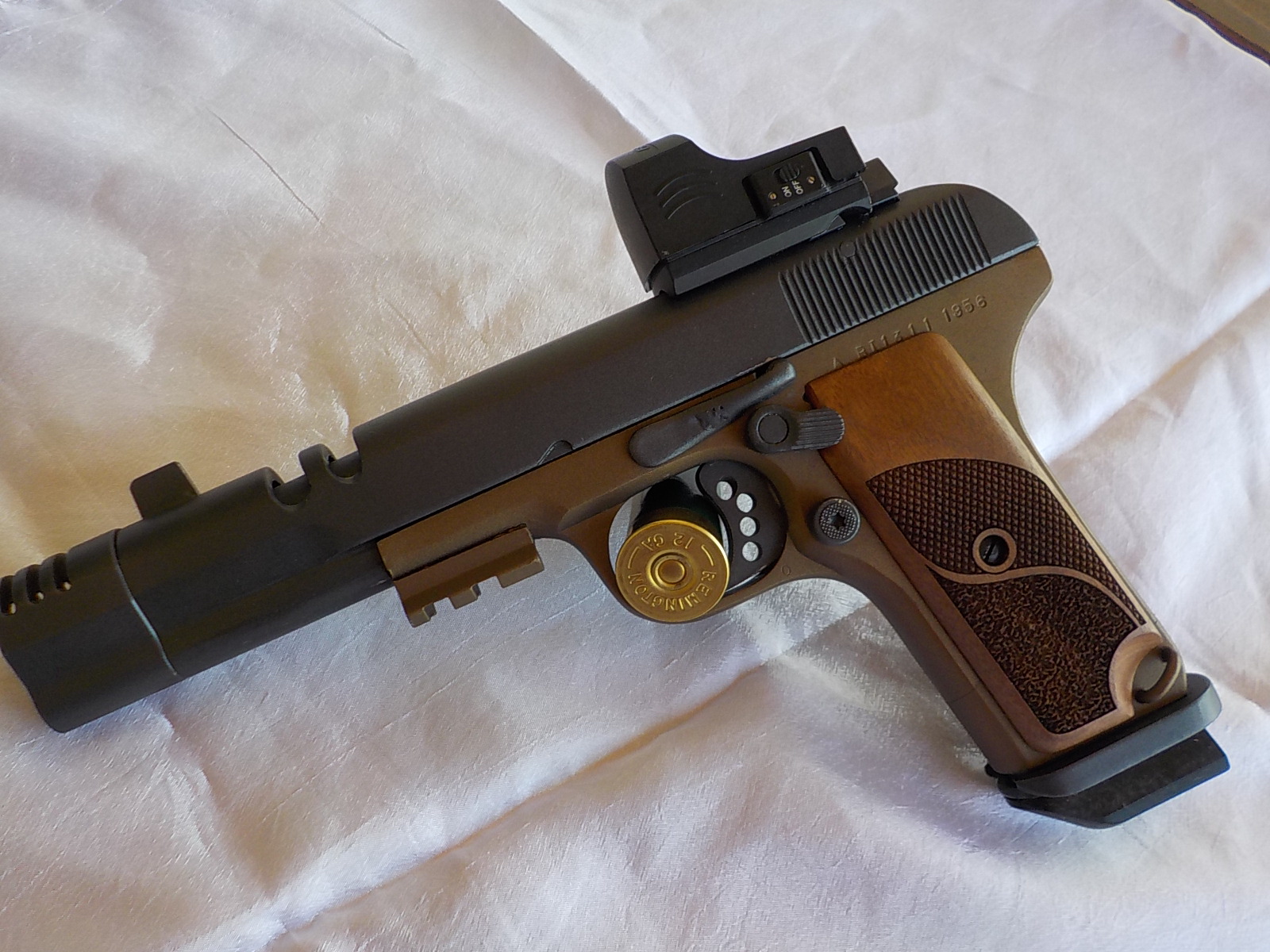

    Here's a Tokarev TT33 I modified. Sold this for a ridiculous amount of money. Buyer was in his 20's and I suspect a call of Duty player.:)💰

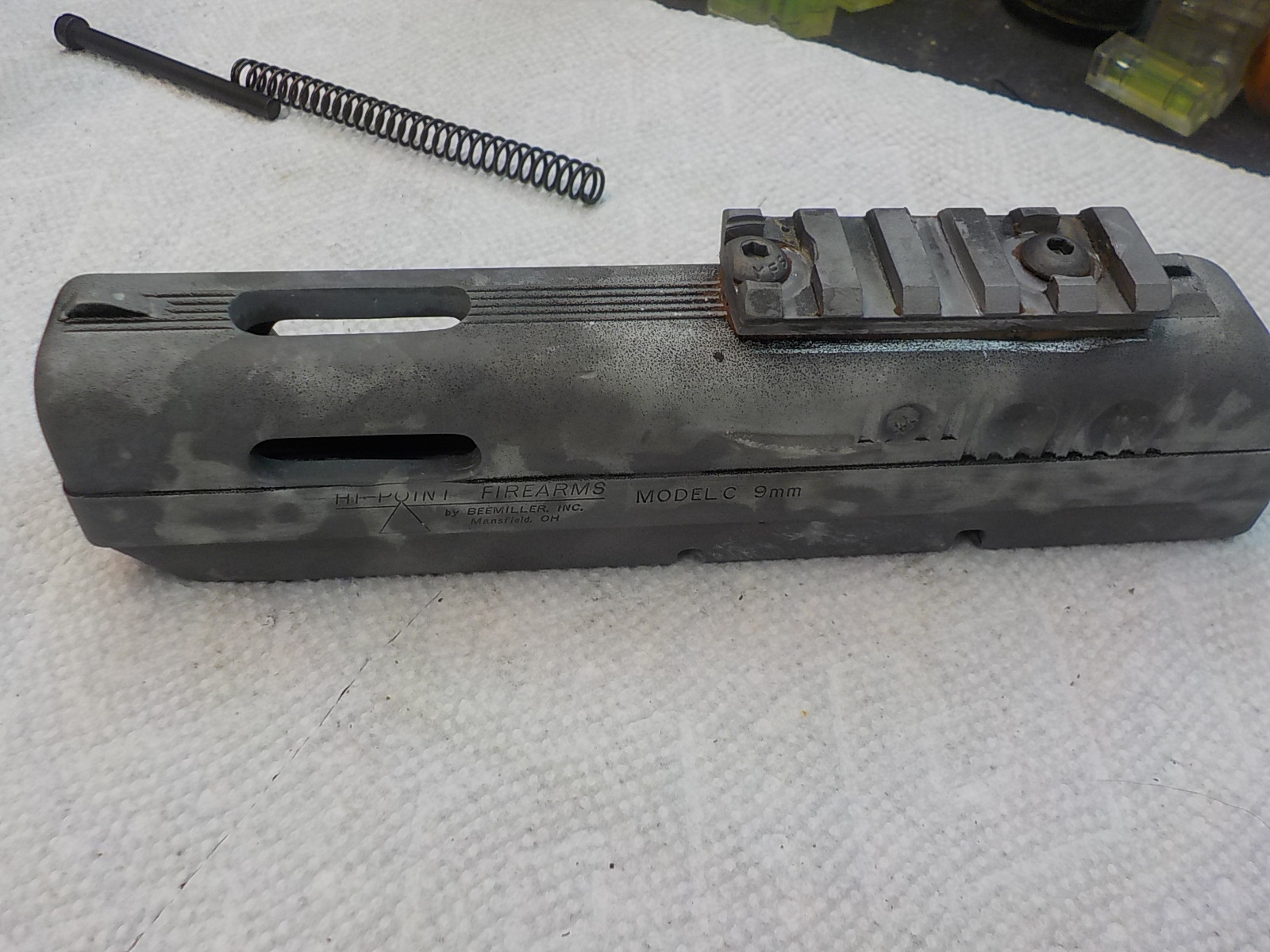

    Slide cuts done, picatinny rail mounted, sand blasted and ready for cerakote.

    Yes, the pot metal they are made of is crap...that's why everything is so thick...and that it's straight blowback. When I drilled and tapped for the picatinny rail, the threads stripped right out when I tightened down the steel screws. .I had to go to a bigger thread and re-tap. I still had to fill the threads with acra-glass to reinforce the threads.

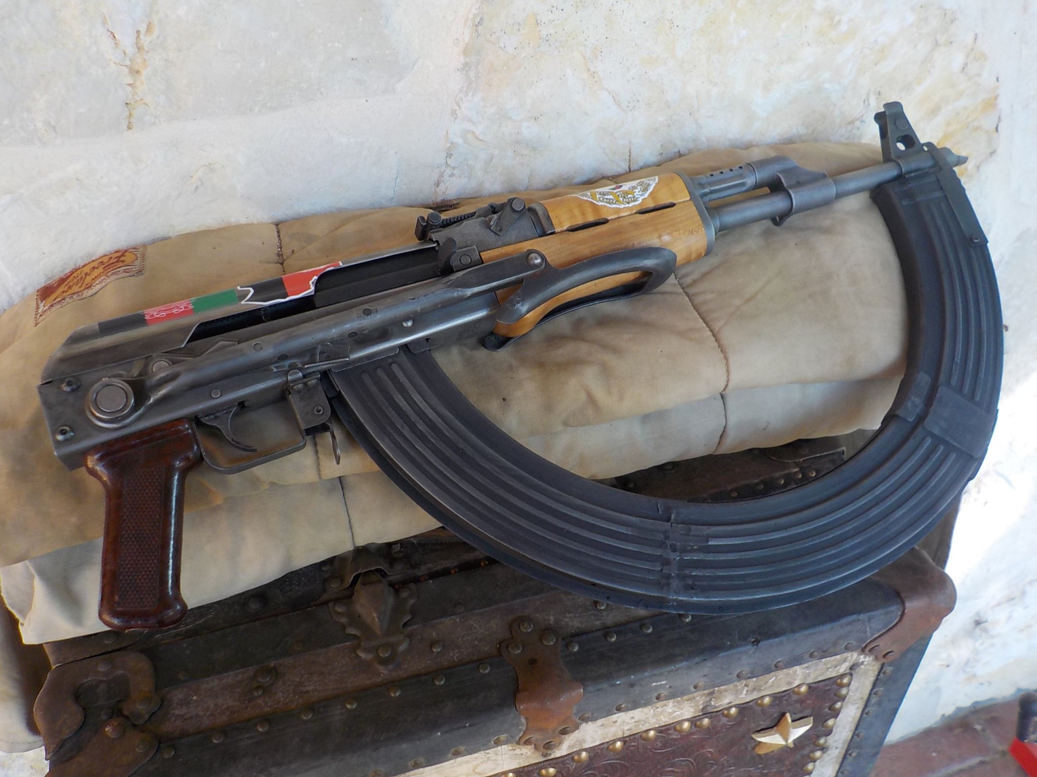

    You make a good point, and in retrospect I should have kept in original condition and just bought another...too late:(:cry: As for the Potato Digger...I'd give it an ACOG, folding stock and SBR it in a Minute! Just like this 1918 BAR:

    Did you build that mag or is that something that's available in the wild? Not that I'd ever want one....oh no, oh no.
    I built it. I welded 3 mags together. Only the first 30 rounds are functional. The originals were a single piece of stamped metal. I could have spent a great deal of time smoothing the inside to take all 90 rounds but I really didn't see the need. The type 7, 100 round magazine was a real thing.

    To be entirely fair, the only STUPID things on that BAR are the optic (and lack of irons but that's par for the course with Call of Duty when you put optics on guns) and the extended magazine (which didn't exist until OOW made them and the actual mag looks a bit different). The rest is feasible for the 1940s.

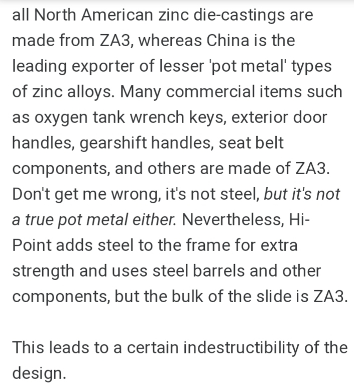

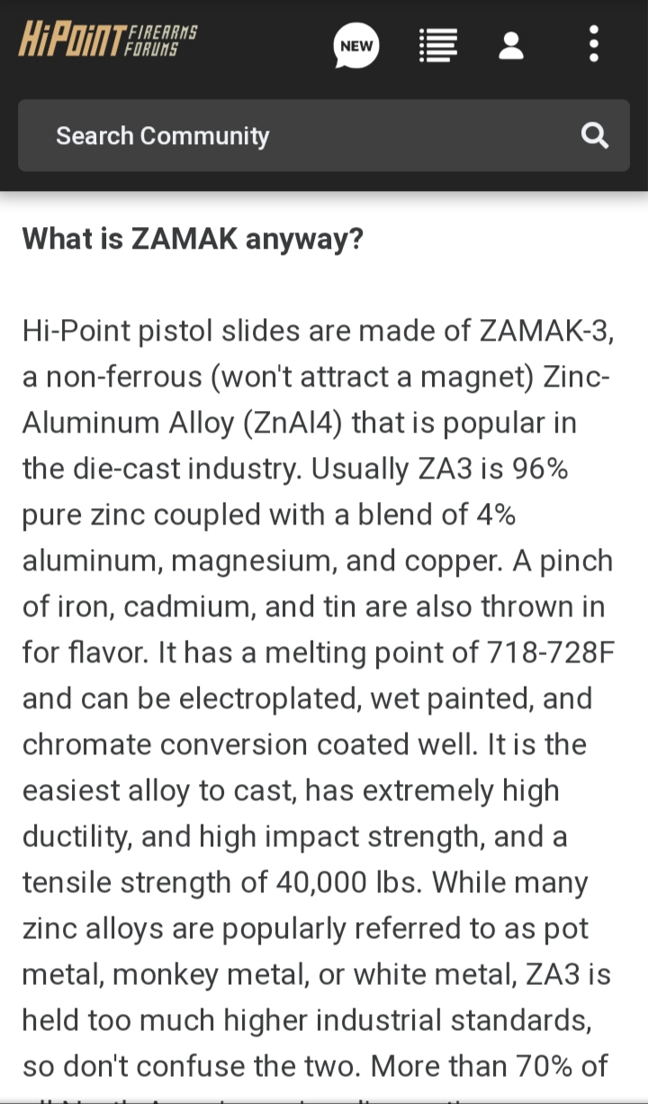

    Yes,Pot metal, but HP goes to great length to make it clear they dont use just any old pot metal.
    They use the North American ZA3 variant in their slides, which according to the article posted makes it premium pot metal.😁

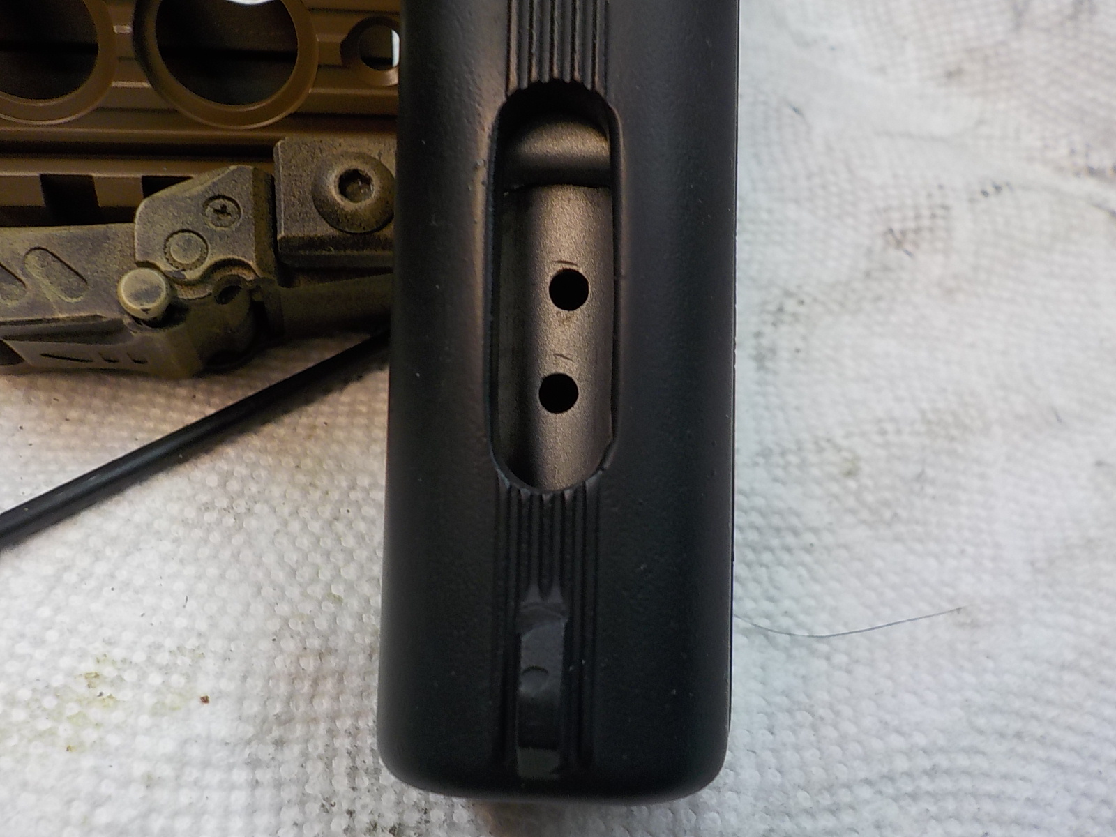

    Barrel port function video. I'm going to compltely chop off that triggerguard and fabricate a new one. I'm also going to make a new trigger out of aluminum and lighten the sear spring to get a better trigger pull.
    A couple of those could be used as coaxial skids on a Lahti L39...
