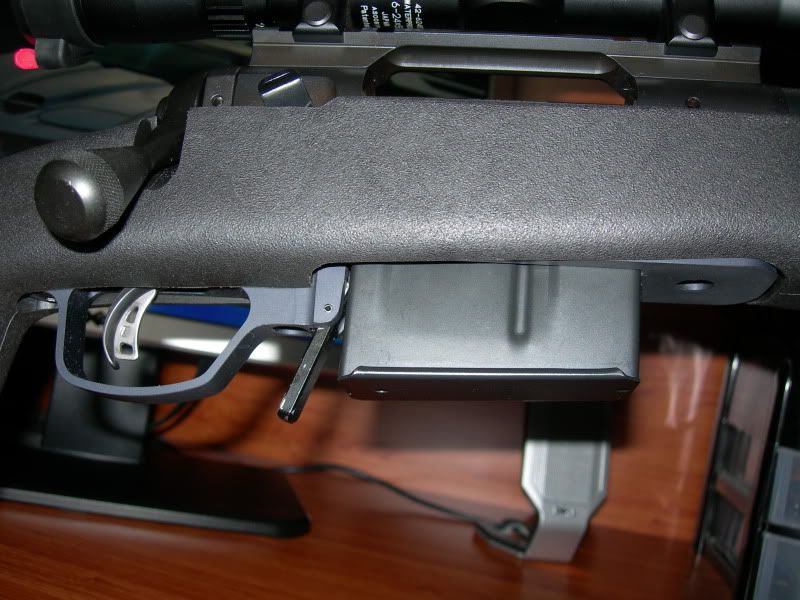

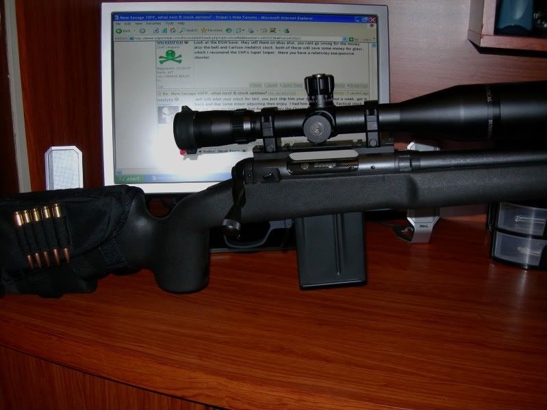

Jeff will inlet your stock for $60, you just ship him your stock, wait about a week, get it back and due some minor adjusting then enjoy. I had him do my Choate Tactical stock for me. Just my two cents but for the money the Choate stock is hard to beat, I really like it.
Figured I'd snap a quick pic.

so after he inlets the stock, i can install the bottom steel myself? it just fits and bolts in and there is no adjustment to get the mag to work? i saw that you have a new knob but cant see if you have an accu trigger. i like the look but the mags are pretty high. ever see them cheap?

Yes after he inlets the stock, you can install the bottom metal yourself, with just a little adjusting. You have to cut down the front action screw (he provides both new action screws with the purchase of the DBM system) it sticks up into the action a little bit and needs to be cut down then you may or may not have to adjust the mag feed lip, which he provides a diagram of. Here's a little better pic of the DBM system.

<div class="ubbcode-block"><div class="ubbcode-header">Originally Posted By: AXEMAN</div><div class="ubbcode-body">that stock is a choate? havent seen that model before. its isnt flush with the stock, is that common? </div></div>
Yes, it's the Choate Tactical.
Choate TACTICAL Stock for Savage Short Action
As for the bottom metal being flush, if you look in the first pic you can see that the stock angles upward as it gets closer to the forearm, so there's no real way to get the bottom metal exactly flush with the stock.

nostyta, what type of scope is that?
