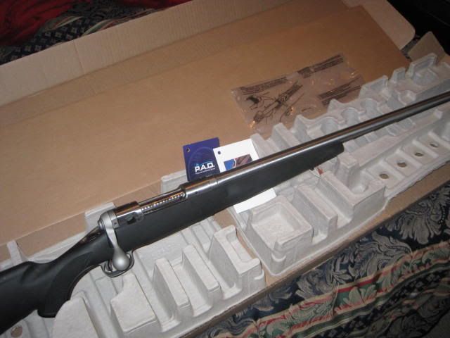

New rifle arroved today, it's a Savage 12 FVSS in 308. I need some suggestions in the mod department. I'm thinking a detachable mag setup (CDI unit), I plan on fluting the barrel, threading 5/8 24 and possibly shortening it a bit in my shop, it's twenty-six inches now. I can't afford a nice new match barrel so I use this one up before dropping some more $. How much do you think the rifle will suffer with the shorter barrel. I plan on making this into a 1000 yard hitter. Stock choices in the price range are the Bell & Carlson. Give me some advice..

No it's not the Accustock, I figured that I be changing it out and just went with the basic composite (plastic) stock, no need to waste money on something I be swapping out. I can tell you that this stock is very cheap. I believe that I'm going to start a thread on this build.
