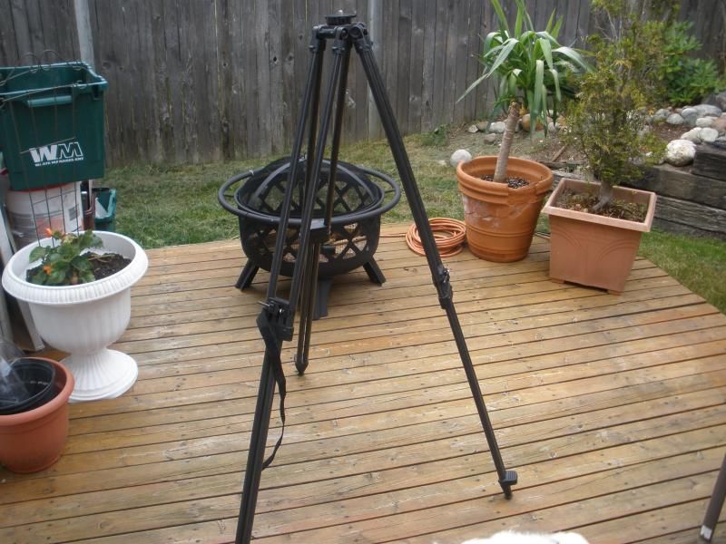

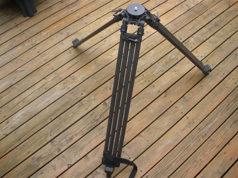

I have been working with a local manufacturer on a design for a custom tripod. Their current tripod designs are geared for road survey equipment and high end photography, these things are solid and designed to support some serious weight. I have narrowed it down to a few designs, but I am looking for input for heads and rifle cradles. The tripod in the pics below uses fiberglass legs with injection molded plastic for the attachment points, top head is aluminum, height adjustment latches are quick throw levers. Legs will be made of fiberglass as well as a carbon fiber model, this model has a adjustment range of 32" 54". The feet options are currently rubber bottom, and spikes for softer terrain, other foot designs will be discussed. I will get some info on weight of the carbon fiber models vs fiberglass as well as estimated pricing and update the thread as things progress.
This is a opportunity to have a tripod made exclusively for shooting with input from Snipers Hide on the final design, if there is interest.
