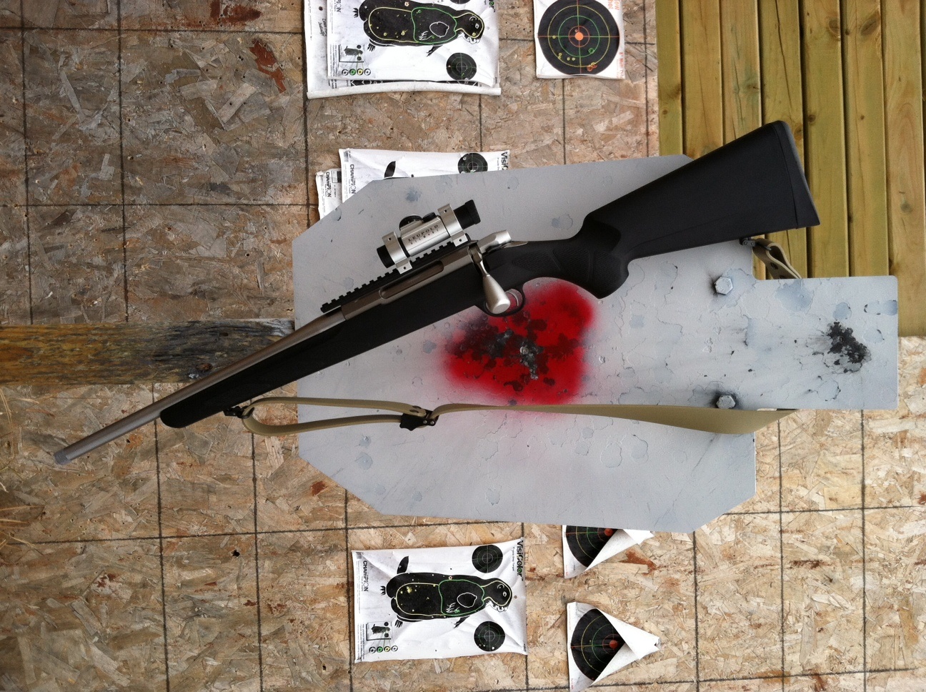

From my pics, looks like the LSS is flatter than the Tactical.
