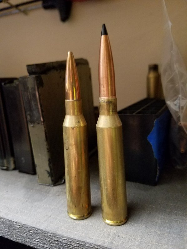

- yep, hit a deer with my 338? Just means less meat I have to pack out. Jk! Im using Cutting Edge 300gr Lazers. Using 96.5gr of H1000. Leaves a tennis ball sized exit wound on a deer. I tried them with coyotes. They unfortunately dont have enough mass for that bullet. Just pencils in and out.

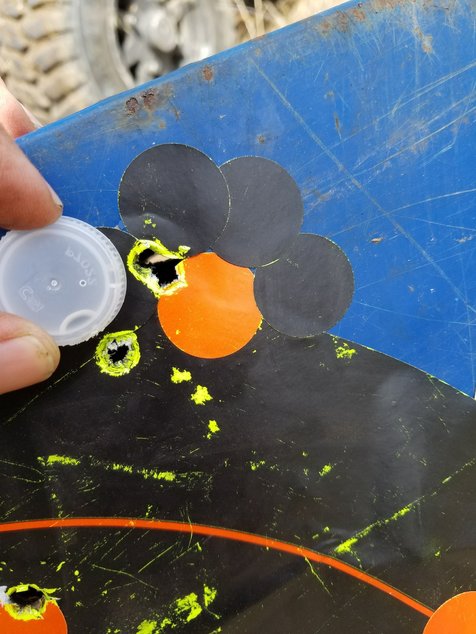

Pick is with 300gr scenar next to the Cutting Edge. I have to single feed the round. Pic zeroed at 200yards. I flinched on the 3rd shot for grouping. Not going to lie...its a punch in the shoulder. (Trying to not make this a 338 thread, after this answer lol).

You're worrying too much. The accuracy that you're getting right now is perfectly sufficient to deer hunt out to at least 400 yards. If you're trying to hunt past that, your whole process has been optimistic.
If you have time to tinker, free float the barrel by relieving the stock and verify that the recoil lug is seated well. It would also be worth your time to double-check the hardware on your scope.
You shouldn't need to chase a better factory load, as I've never seen a Hornady 6.5 Creedmoor shoot poorly in a proven gun.

Send it back . It is a mile off where it should be. Faffing about with ammo brands is not going to take that error out. It is worth trying out a scope you trust but after that its warranty time. I know lots of guys over here with Tikka's and that is not normal out of the box behaviour. Most of them are very very good. Sounds like you have been unlucky
Agree 100 percent. It should shoot, no questions, no grinding, period. Taking it apart and potentially bubbafying that stock could could the warranty, so I would suggest call them before touching it. Before wasting more ammo, you need to contact them.
I have basically the same rifle, 20" barrel version. When I first got it I noticed the stock was touching the barrel about 4" ahead of the receiver. I figured the stock would be the weak point of the rifle but I bought it for the action and barrel. I used sand paper to remove material that was touching the barrel and had it free floating with business cards. Shot great, no issues until one day it got bumped a bit hard while cleaning, next match I shot it was off my zero by a couple MIL.
Took the stock off and discovered the lug sits rather deep into the stock and only gives a small amount of engagement with the action. That bump had slipped the lug out of the action and caused the shift. Chose to bed the action and lug to clear that up (trying to milk this stock before I upgrade it). Never bedded an action before but it was pretty simple and worth the $10 in epoxy. Shoots great now, lug has great engagement and I'm happy. Will hold 0.2" 5 shot groups from a benchrest.
