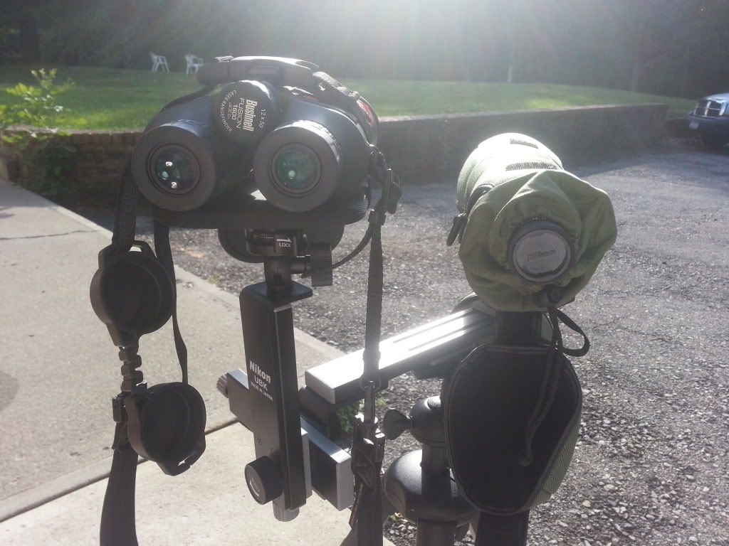

I mounted my Nikon 82 ED yesterday alongside a pair of 12x50 Bushnell Fusions and as seen below there is plenty of room for viewing both. The binos are pushing the weight limit on the weak side and is the heaviest I would feel comfortable with.

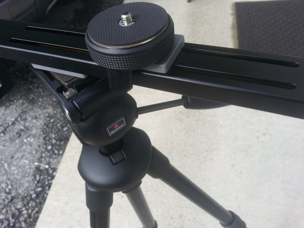

The plate with threads for the tripod is the only thing that remains stationary.

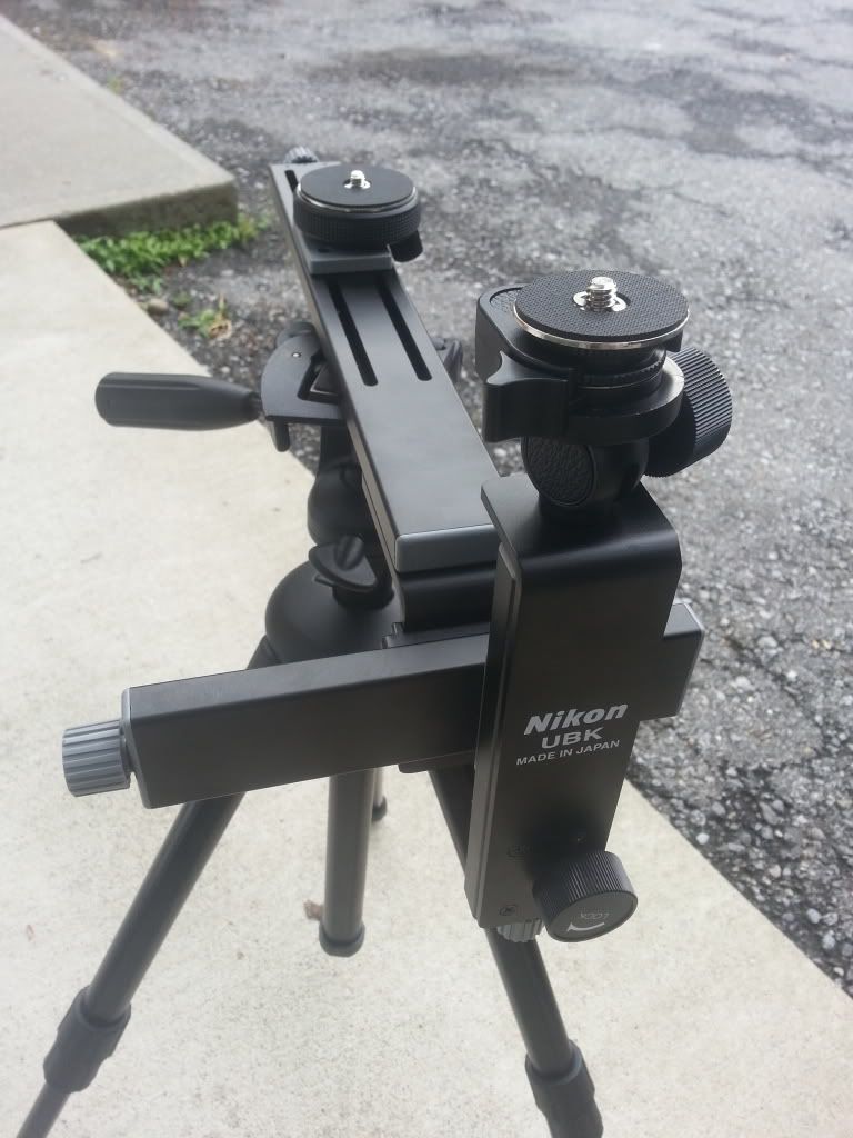

It comes in two main pieces, includes the small locking nuts and the track adjustments are already assembled.
It operates like this:

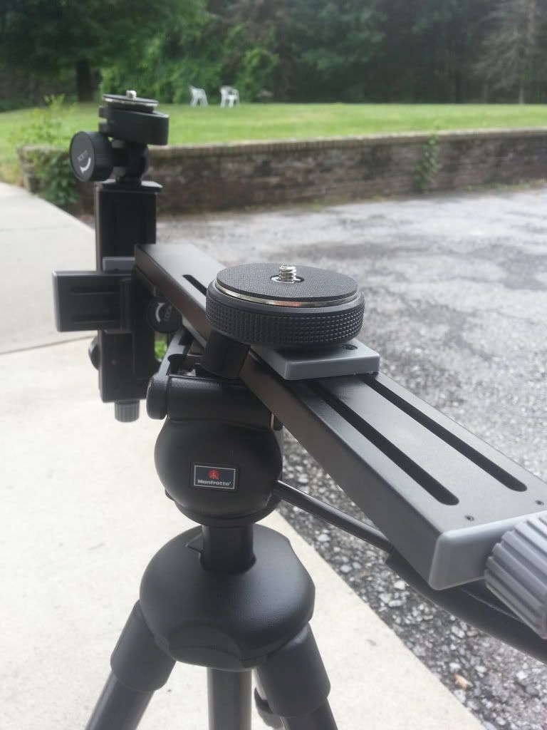

This bar in front is 'L' shaped and attaches directly to any traditional screw you want by a plate underneath. On this bar there is mount for the main optic on the circle shaped plate. The plate itself has a screw attached on the bottom side edge that locks an independent swivel function and turns only left or right (also to easily screw in your optic). On this same piece, the gray screw on the end allows the plate (that holds the optic) to run up and down the track smoothly in fine adjustments. This main piece does not have vertical or tilting movement, that is controlled by regular function of your tripod. The next piece attaches to the cutout on the other side at desired height. Technically the bar with the cutout is separate (i dont know why) but it comes attached and is meant to be permanent.
The second piece locks on at a desired height at the end of the other bar where the cutout is. This height is locked in place and offers a second vertical adjustment for the additional optic. You can see in the pictures above there is a cutout on the first bar for screw placement.
This second pice consists of both a vertical and horizontal tracks, both of which are controlled like the first with the gray adjustment screws. On top of the vertical track lies the ball head for the second optic. It's a two way ball head and travels left/right and tilt (up/down). I don't believe it can pan (side to side). That movement is locked by the larger black screw. On top of the ball head is a recess that holds the plate and screw for the optic. It is removable and locks in place with the black slide level at the very top. The quick release function of the second optic makes breakdown much faster.
The unit can be run with just the first mount. The entire unit, including optics all can be put together or disassembled in less than a minute.

Main body is aluminum. The rest is composed of few different materials. It weighs ~ 2 pounds
