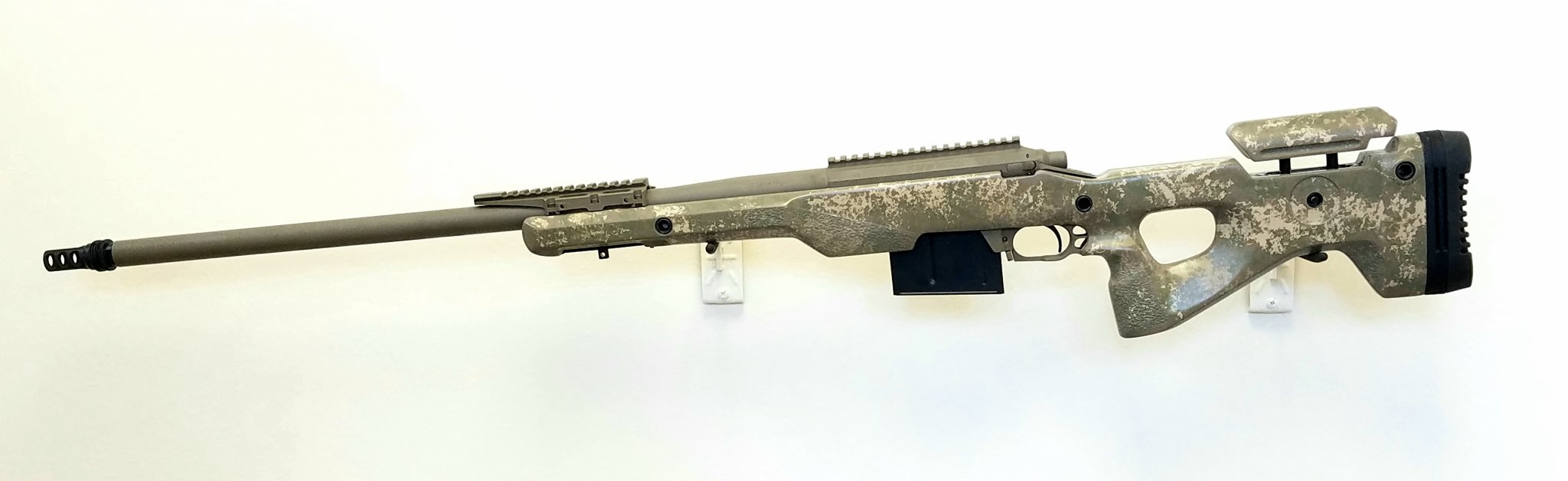

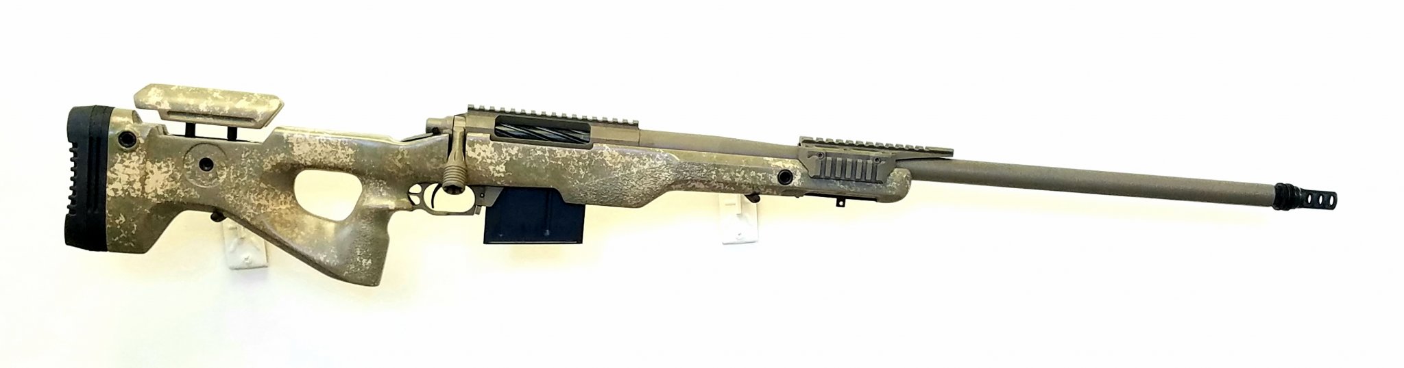

For reference, this batch of LongSword rifles are build on KMW branded Deviants loaded into IMB chassis and Gen II DBM with CIP mags.

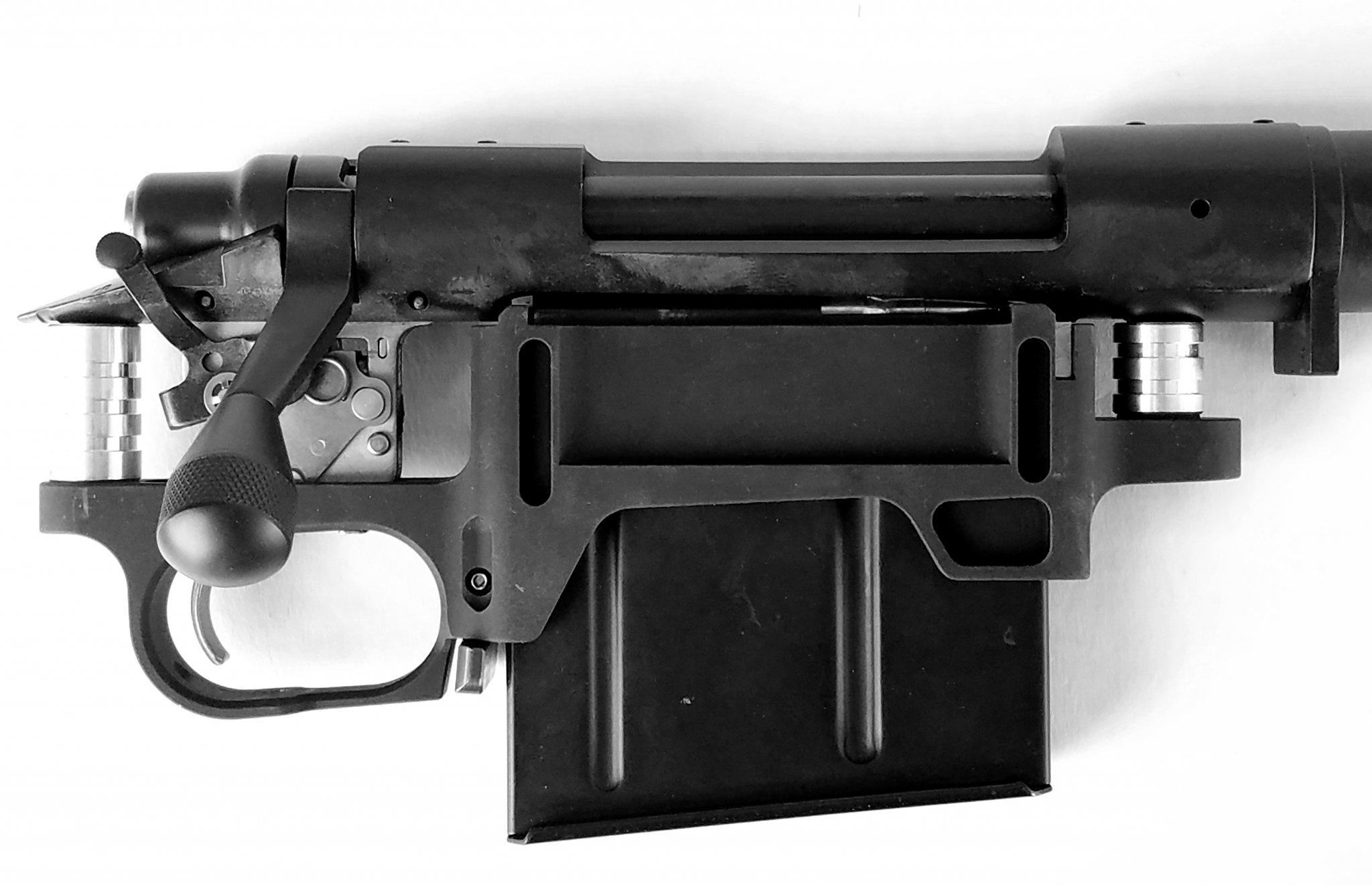

There is also a Mk2 Long Action DBM that Manners, McMillan and Foundation Stocks can inlet for. The Mk2 will work perfectly with your Deviant and CIP magazines. The KMW Mk2 DBM bottom metal for conventional stocks is pictured below.
