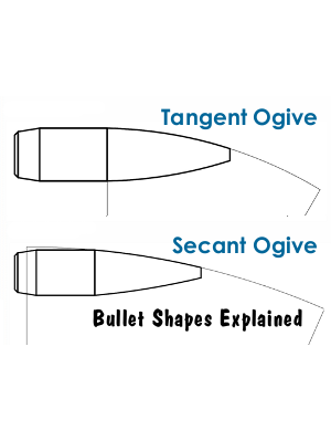

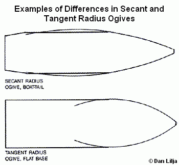

The secant shaped vld bullets are seating sensitive for the most part, so stuff like the berger vld hunting in hornady interlock are a more depth sensitive.
See how the secant vld on top is an angular transitionfrom the nose into the bearing surface vs the tanget of the classic that sort of blends in nicely and smoothly?
In regards to how to chose a bullet based on the throat, thats tough to do without more info. I choose a bullet and find out where it sits with each particular barrel like in this video. A savage will have a tough time doing this test but your rem and tikka shouldnt have an issue with it. This way you know exactly where you are for each particular combo, no guessing around the number.
