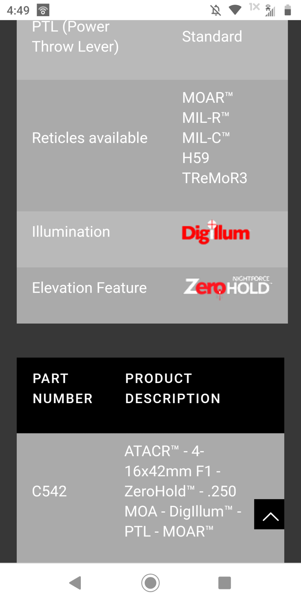

The new NX8 series have the zero stop feature.
To clarify.....
ZeroHold elevation feature found on the ATACR 4-16x42 vs ZeroStop elevation feature
