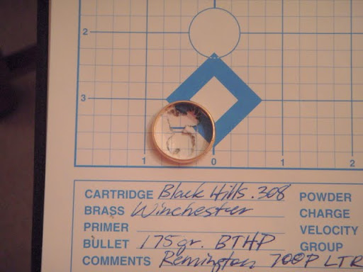

Here is a picture of the third 5 shot group out of the gun today and ever (first time shot)...
Not bad for a stock Remington LTR. However, it did almost take two fingers to pull back the trigger...HEAVY. That is the next evening project.
Thanks for all of your thoughts.
