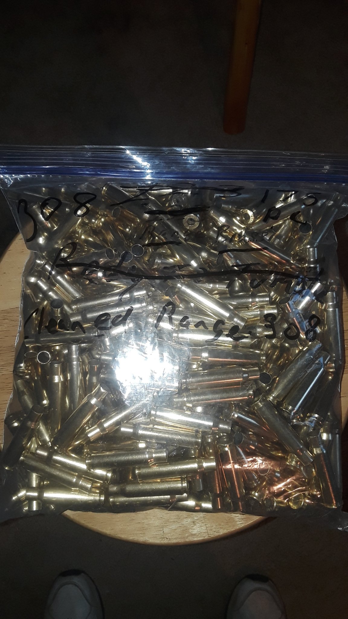

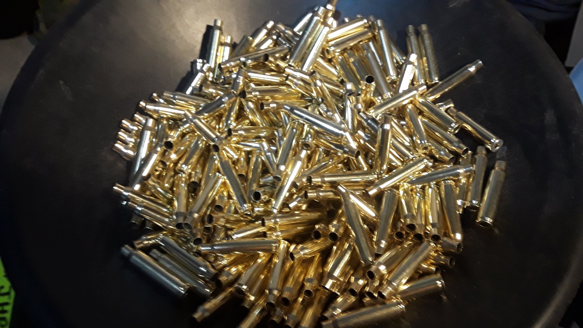

My rifle brass prep includes,
Deprime.
Tumble.
Work primer pockets.
Size.
Tumble.
Trim and champher.
Quick tumble.
This is all rifle brass, virgin, first fired or range brass.
Nothing touches a sizing die till clean and a slight wax buildup for lubricity and corrosion protection including primer pocket.

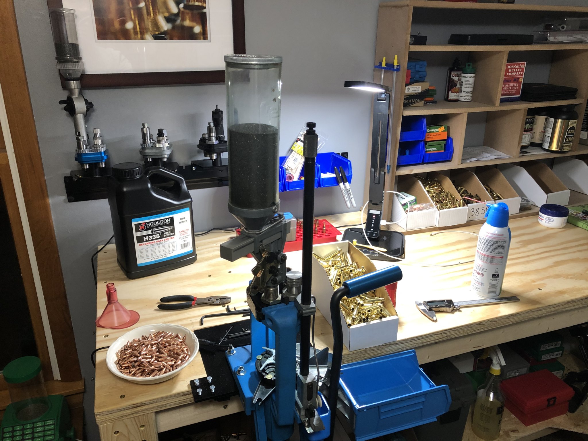

I was reloading some plinking .223 today and was thinking about all the little stuff I have found to be useful on the reloading bench that may help you. This is, of course, in addition to the "must haves"; Calipers, case gauge(for setting up), etc...

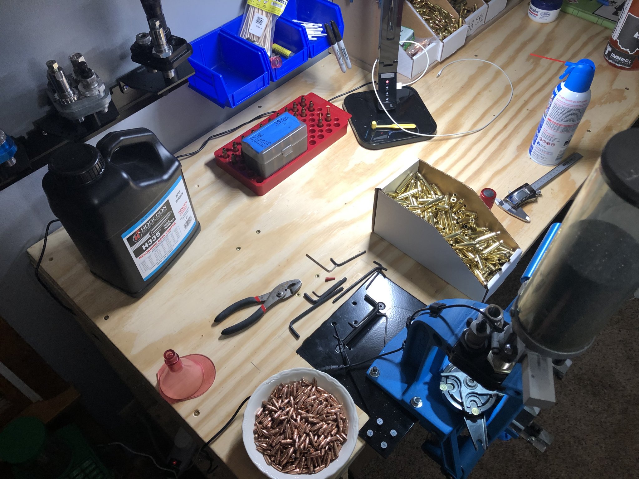

Heres a look at my inside bench set up for my 550 on .223 right now.....
1.) Keep your shit around your press somewhat clean and organized. I thrive in controlled chaos and am generally not a very organized person, but if for god's sake you do one thing, its keep the 1-2ft circle around your press free of extra crap while relaoding.
2.) Something I did when I began reloading was put the powder jug I'm using out in front of my press. Its HIGHLY likely I'll never forget what I'm using, but I've always done it and I think its at minimum a good recommendation for beginners.
Extra "things" that come in handy:
1.) Air duster (like for computers) I use it every 30-40 rounds to make sure my primer cup isn't getting all dirty and keeps my shellplate clean
2.) funnel... I check my powder drop once, maybe twice every 100 rounds. gotta put the powder back in the case.
3.) allen keys for all allen screws/bolts that is anywhere on my machine/toolheads/dies etc. People forget allen keys, then don't lock their die ring down, then their sizing die shifts and wont resize properly and then your shit won't chamber.
4.) LIGHT...more LIGHT, and some more LIGHT. I use a $22 LED stick lamp off amazon (in the picture) and a toolhead LED light.
5.) The cardboard boxes in the picture, that are holding my cases.... love them. 50 of them off amazon for like $10 (can also use acro bins)
6.) I use a small bowl for bullets... can't stand grabbing them out of a box, slows the process
View attachment 7300539 View attachment 7300551
7.) pair of needlenose pliers preferably, but something along those lines.
8.) cheap LED flashlight... for inspecting up close during setting up and if something "feels off" on the press.
9.) Cue-tips... I keep some regular ones and some 6" stick cue-tips
Another thing that most don't talk about is press lube. It DOES make a difference. My dillon runs night and day different between standard motor oil and what I use now (Butch's Gun Oil). Highly recommend it for your guns as well as your press... attached a photo of the bottle for you.
