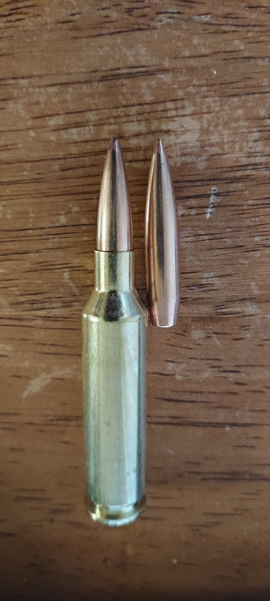

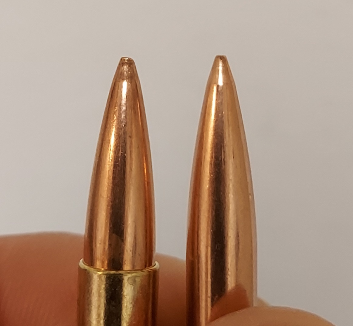

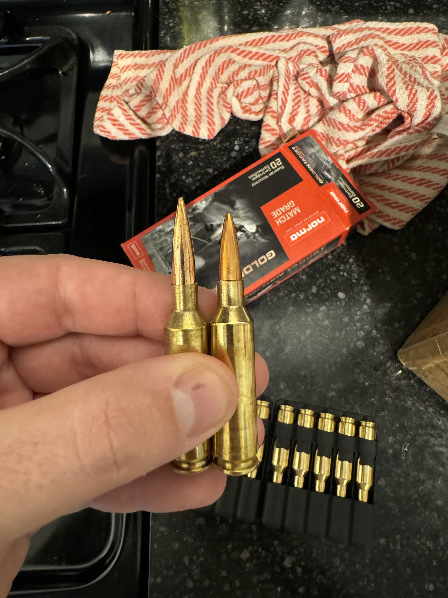

I sent pics, COAL measurement and lot number of this 2.600" junk to Norma on Dec 8, no response yet. Maybe customer service and quality control are the same person. UPDATE: Norma customer service just responded, she has reached out to quality control. I won't buy Norma again. Haven't decided if I'll shoot it as-is. Guessing pressure could be awfully high with bullet seated so deep. Does anyone know who makes the 107gr bullet in the Norma ammo? I don't know if they are Sierra factory seconds or another brand. In the pics, factory pointed 107gr SMK on the right. Tip quality certainly looks better. I'm not going to pull a bullet in Norma ammo to measure and weigh.

Norma acknowledged what COAL should be. "Looks as if the typical length of the cartridge should be 2.745-2.750." No mention of this 2.600" stuff I have (I sent pics and lot # to them). I'll update here if I get response from Norma regarding remedy. I opened another box from the case, same COAL. Would be interesting to know if the entire lot is defective.
Norma is sending shipping label to send this case of 200 to them. Offered refund or replacement, if they have some in stock. Finally resolved.

Ordered 4 boxes to try out and they arrived the other day. Checked mine, same batch as yours and same issue. Guess I’ll be shooting them an email.

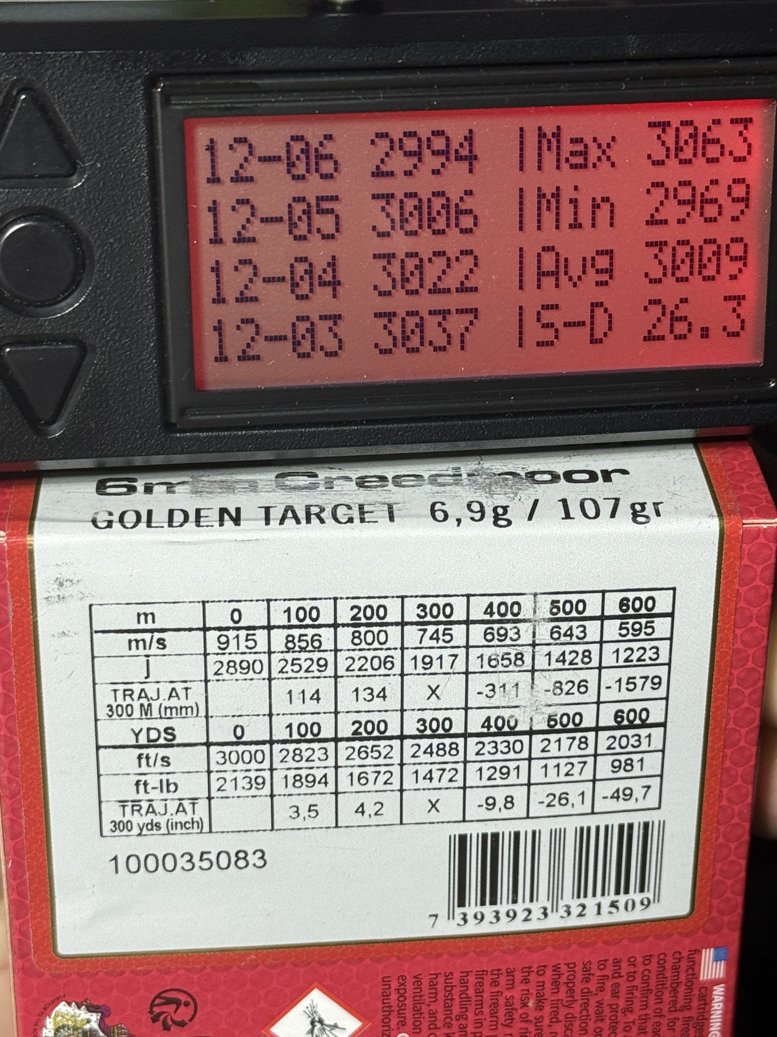

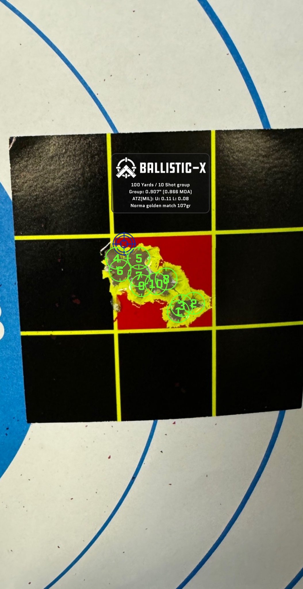

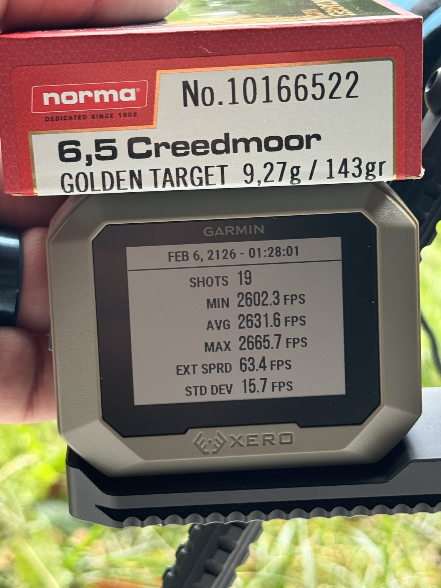

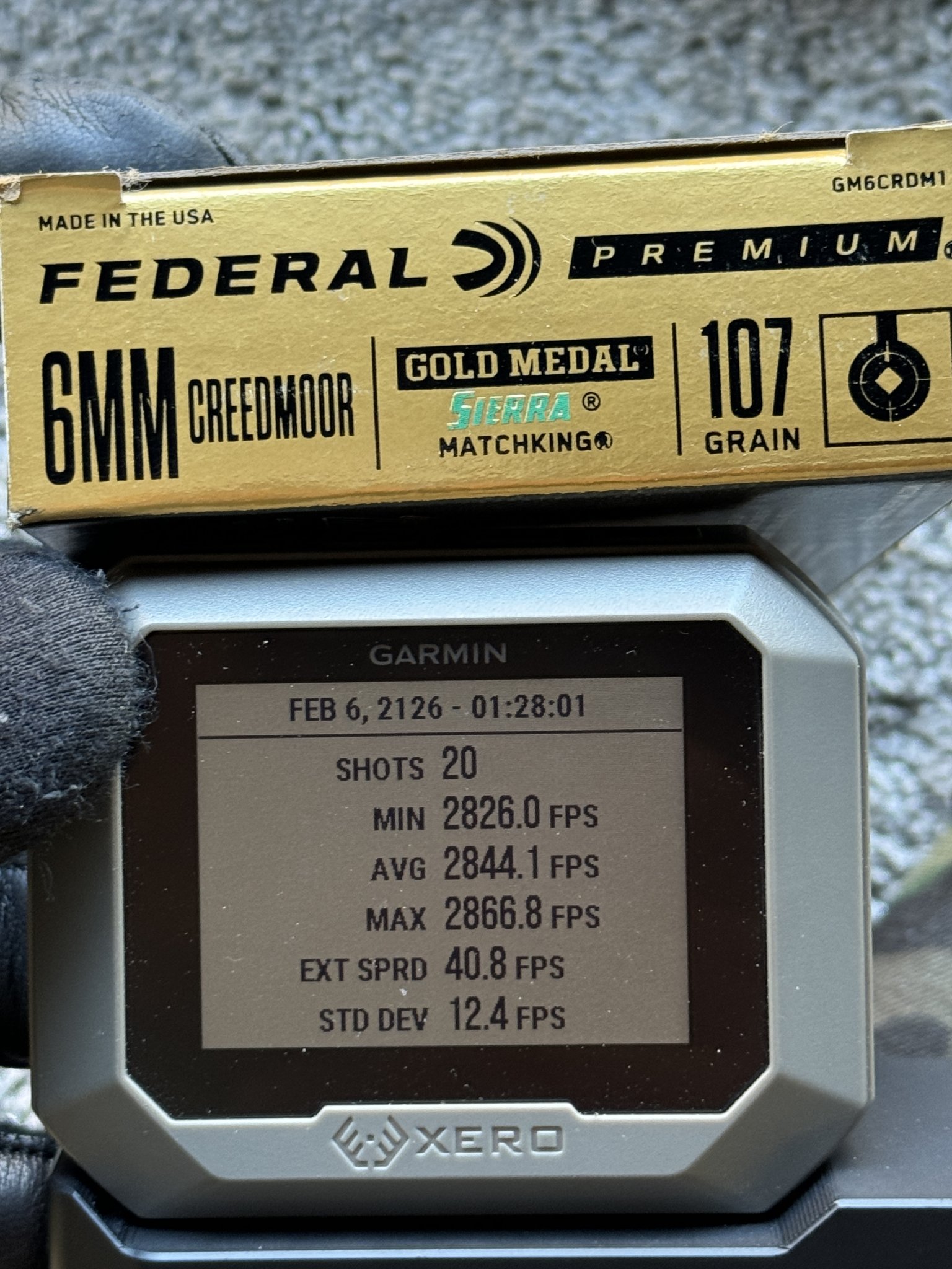

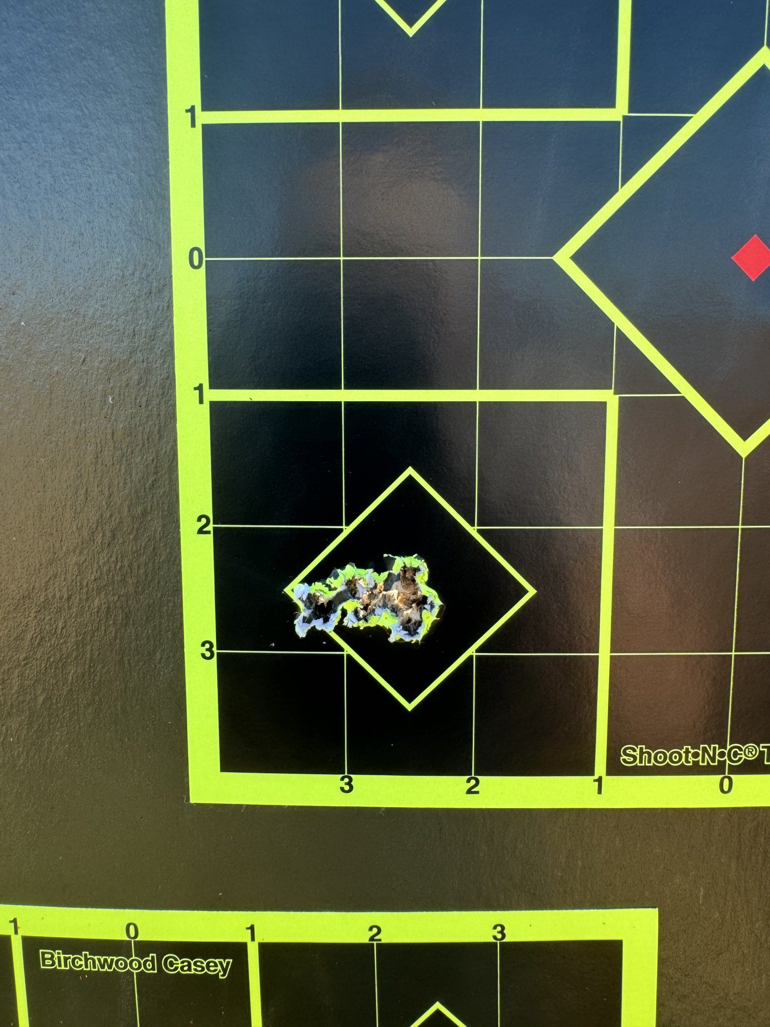

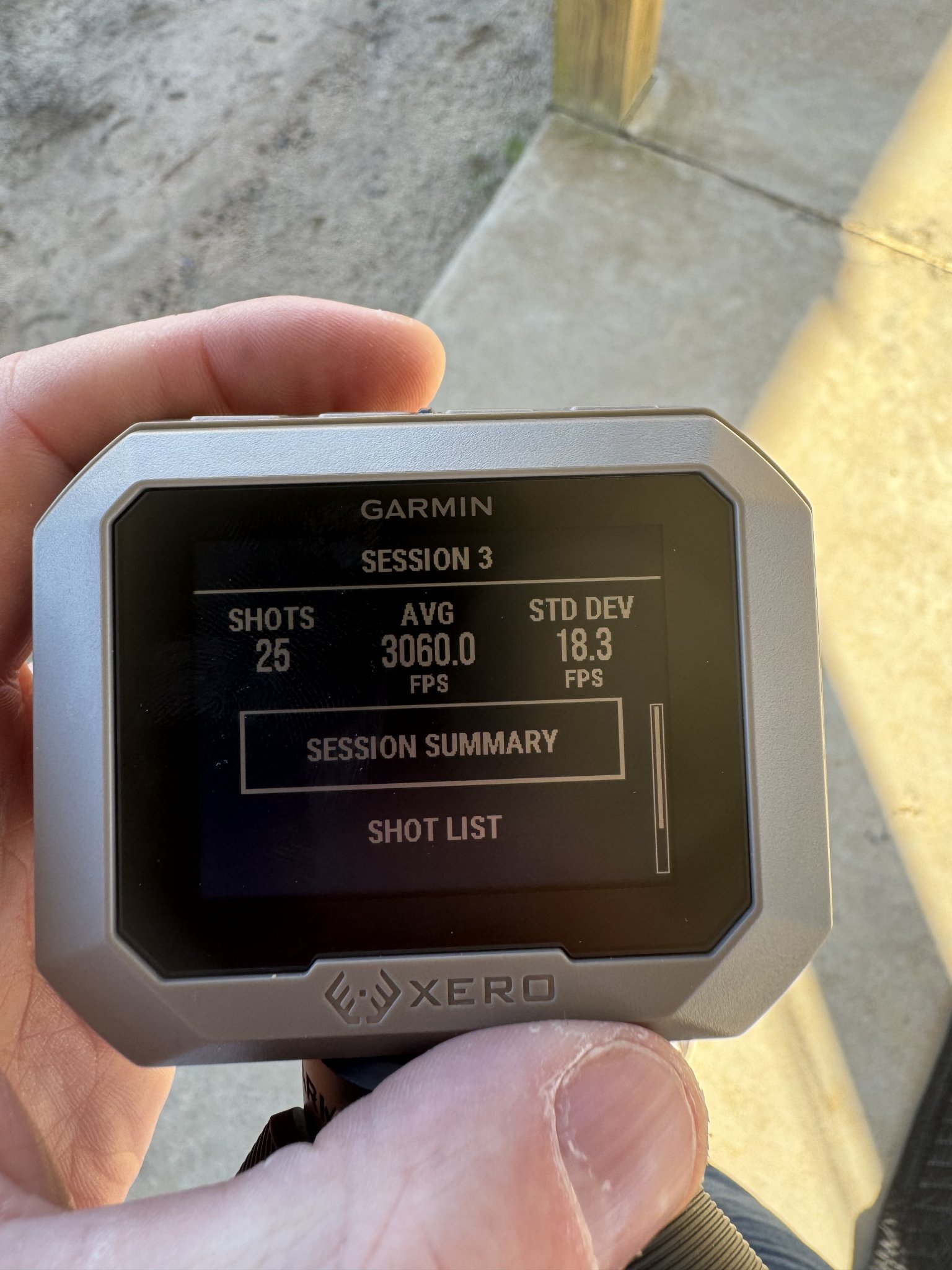

Just wanted to add my experience with the Norma 6mm 107’s.
Shot 80 rounds today on a fresh proof research 26” prefit for the AT-X.
Shot 15 rounds before I turned on the garmin and this is what data I got on the following 25 rounds. Unsure how much this would be affected by the fresh barrel possibly still speeding up, but will test another long string again in the future.
Don’t blame the ammo for the 10 round group, I lost my POA when I shot out the red dot and that is when the Group shifted left. I’m not perfect haha.
Overall I’m pretty happy with the performance for the price. Hope to continue to have good performance with it. 👍🏼

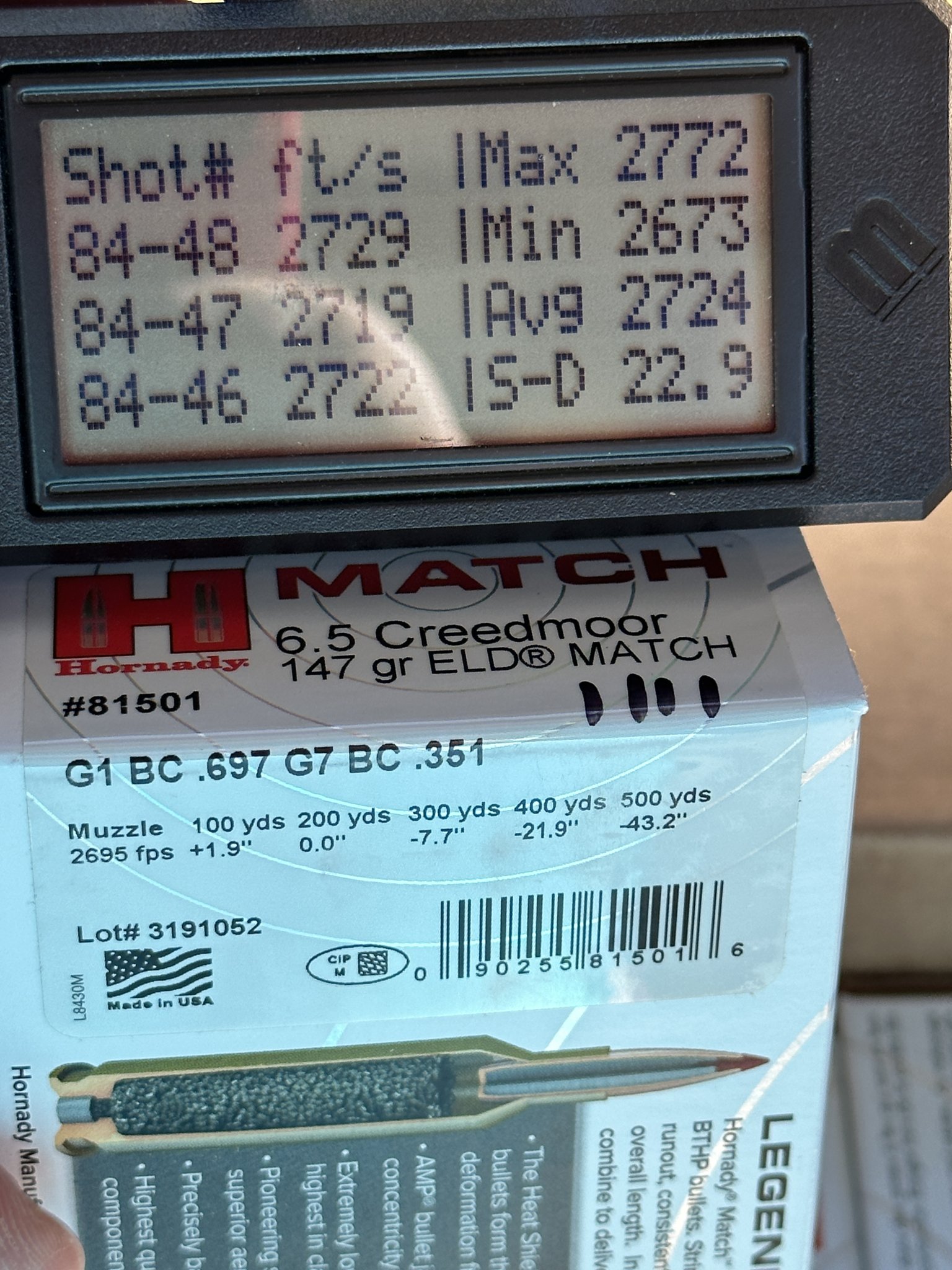

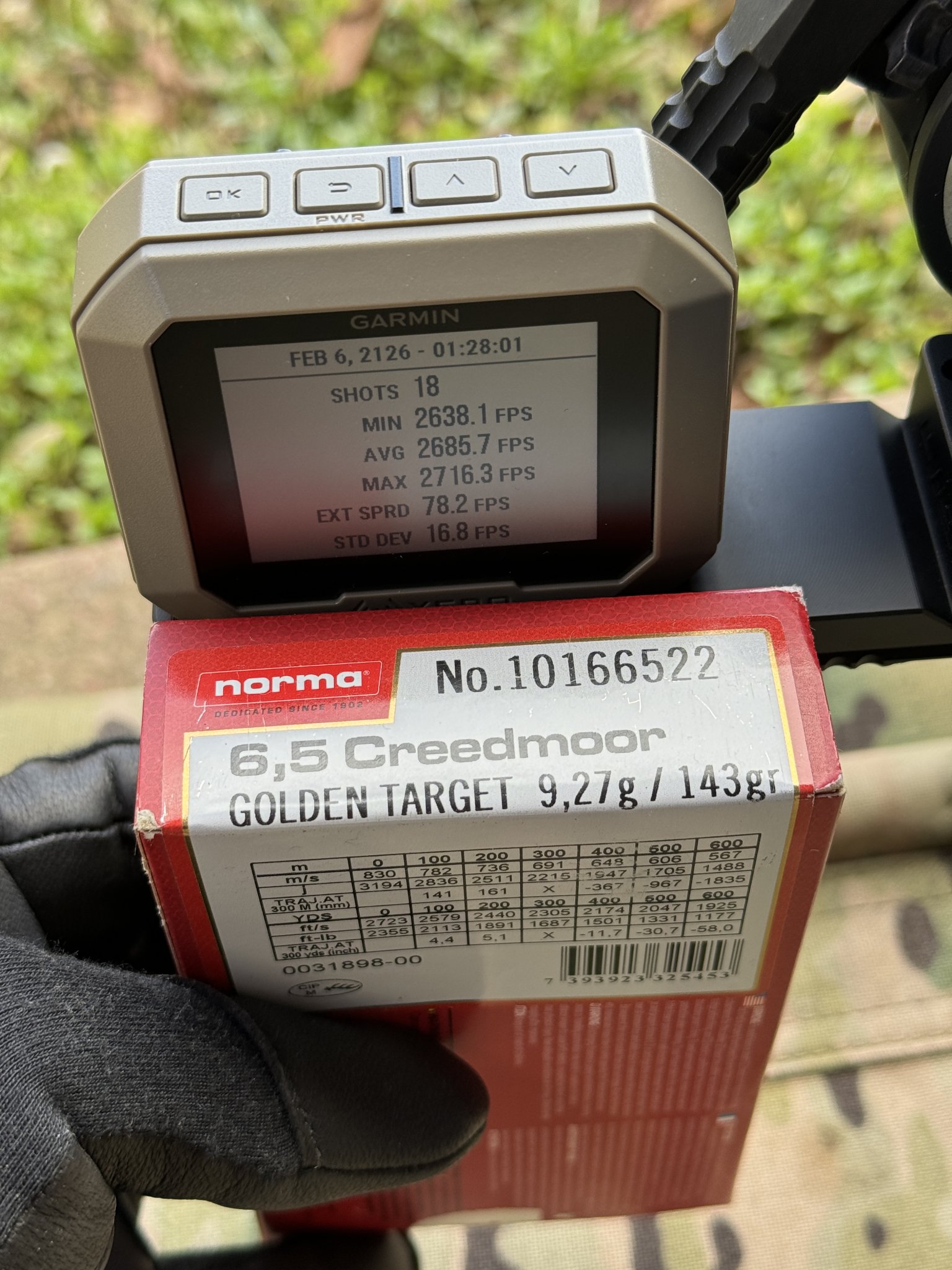

I practice some w/ the 6.5 Creedmoor 143gr loading. It generally groups well in my MPA/Curtis production rig. I have shot groups between .25" and 1", I would guess average is around .75". Velocity is around 2730 (26" barrel) and SD/ES has always been not that great. Last time I had an SD around 20 and an ES of 50. Monster G7 of .321 was accurate for me.
With the SD/ES I would probably shoot a 1-day match with it at one of the ranges that only go to 600 or so, but not a longer range or 2-day.

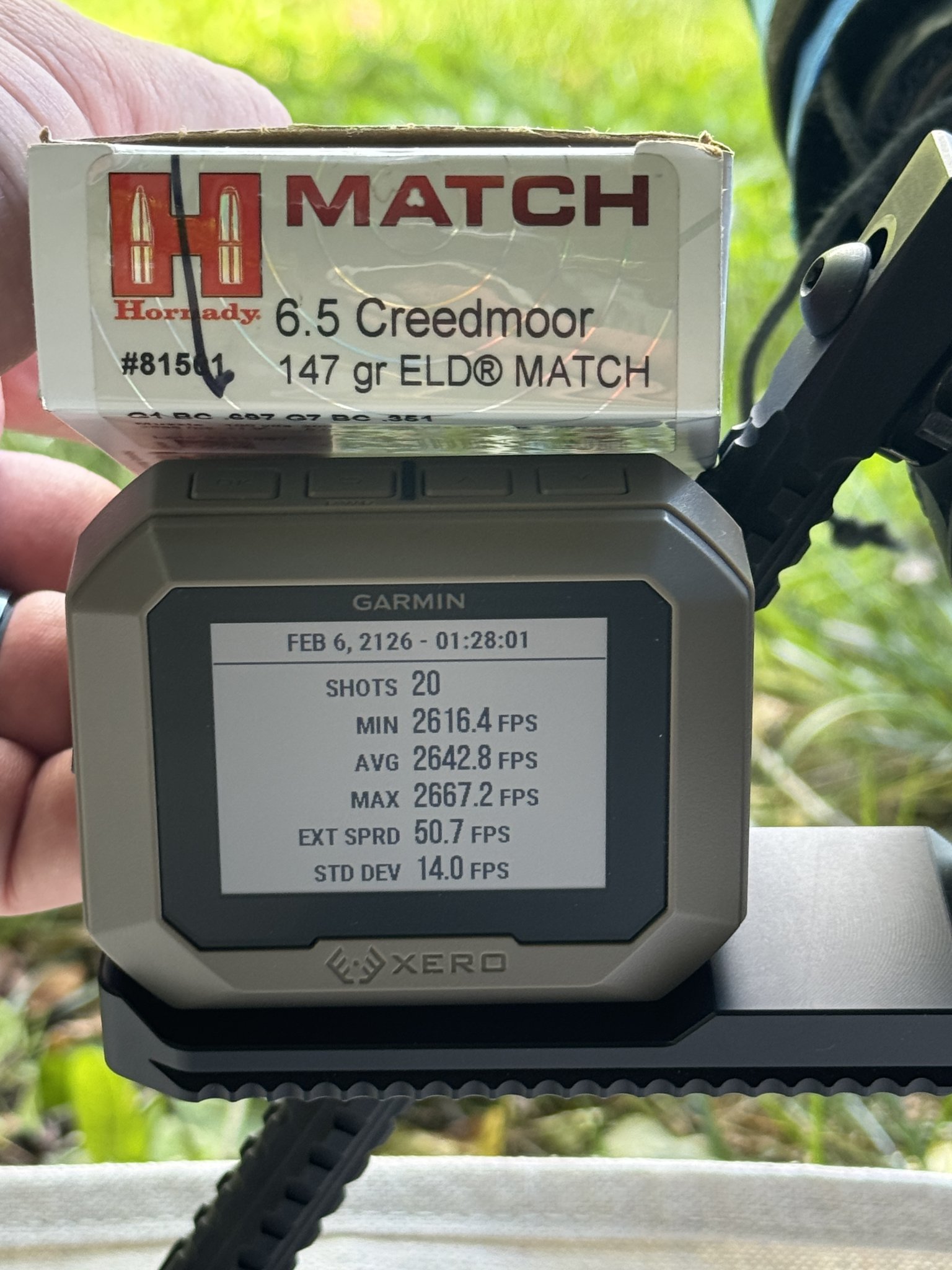

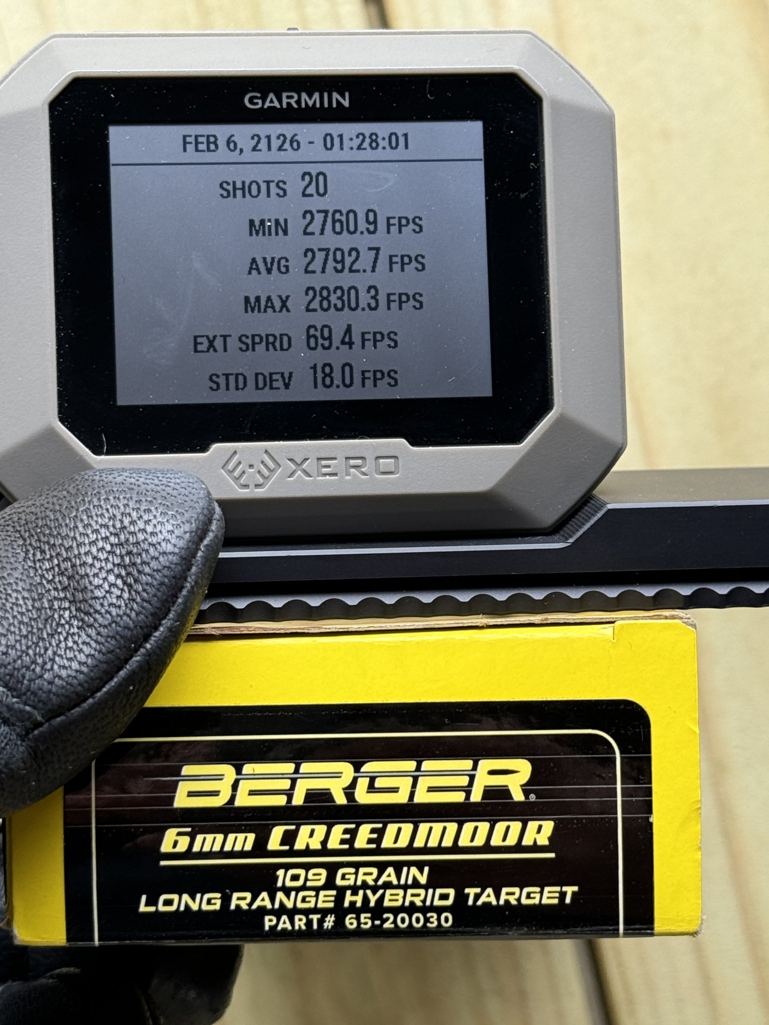

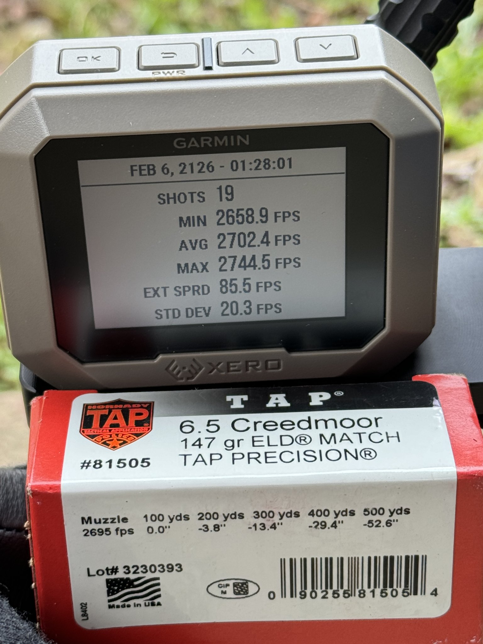

Reviving an old thread. Does anyone have speeds on the Norma Match 6.5 Creedmoor 143 Golden Target out of a 22 inch barrel? Looking to see if I could buy a case and use it for NRL Hunter and make power factor with it?
You don’t need to make power w/ factory ammo, .264 just has to be 130gr
see post 77
We shoot team and think I have to make PF anyway? That said I'd still like to know what speeds people are getting with a 22" barrel if possible. If it shoots as good as yours I can't really see why to load for it even though I have been. It's a spare gun and hopefully never have to shoot it, but I've seen multiple guns go down at the three matches we competed in. Thankfully not ours.
24 inch PVA Osprey:
Different barrels will have different speeds… a 24 inch barrel versus a 22 inch barrel is probably about 25 ft./s difference typically.
