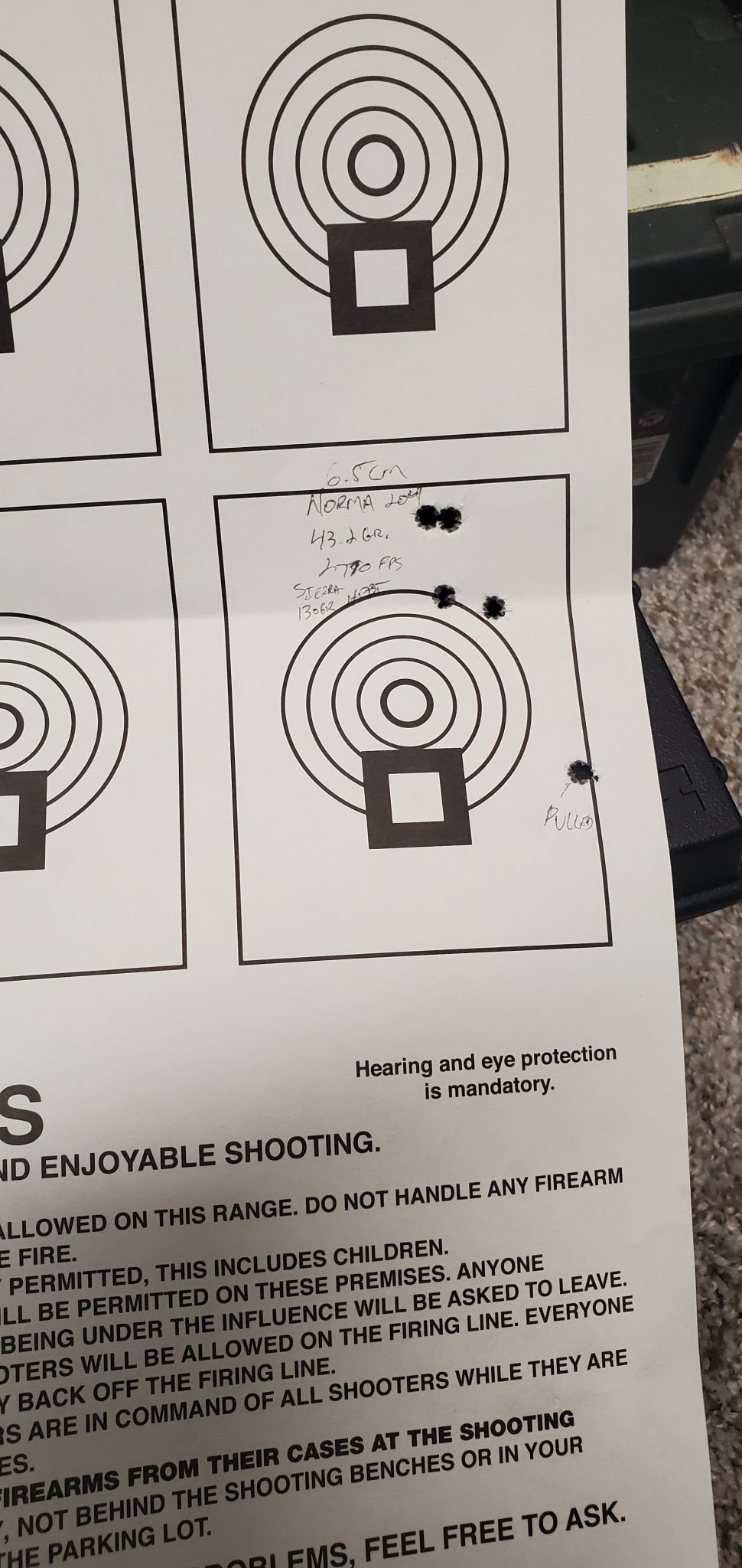

Actually just started working on a load this weekend using Norma 204 pushing sierra 130gr HPBT in my 6.5CM. Currently at 43.2gr, seated to ~2.780 (+-.005) pushing the sierra 130gr. to ~2770fps out of my 22in. JP Supermatch barrel AR10.
Group at 200yds is sub-moa. Gonna go out again this coming weekend and see if I can push it up to 43.5gr. So far no pressure signs at all.
Edit: Also forgot to point out that it seems like the more powder i put behind it, the more accurate it's getting.
Bottom right shot I pulled.
