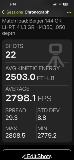

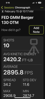

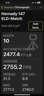

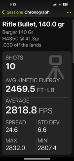

Good morning. I found some older sessions in my garmin chronograph app.
I’m no expert and learning everyday. Happy to help with anything. Pls reach out if I can help.
Please know that these configurations and results are unique to my rifle system. Always follow your equipment’s and ammo maker’s guidance on usage and load development.
One note: the 7.5t resulted in a +1.85 stabilization of my 144’s and 140’s.
Here’s the factory 147 in my 26” proof:
Here’s fed GMM 130’s in the proof:
Here’s when I started to reload Berger 144’s as my match loads in my CRB 26”7.5T:
Here’s the Berger 140’s hand-loads I use as training and backup match loads:

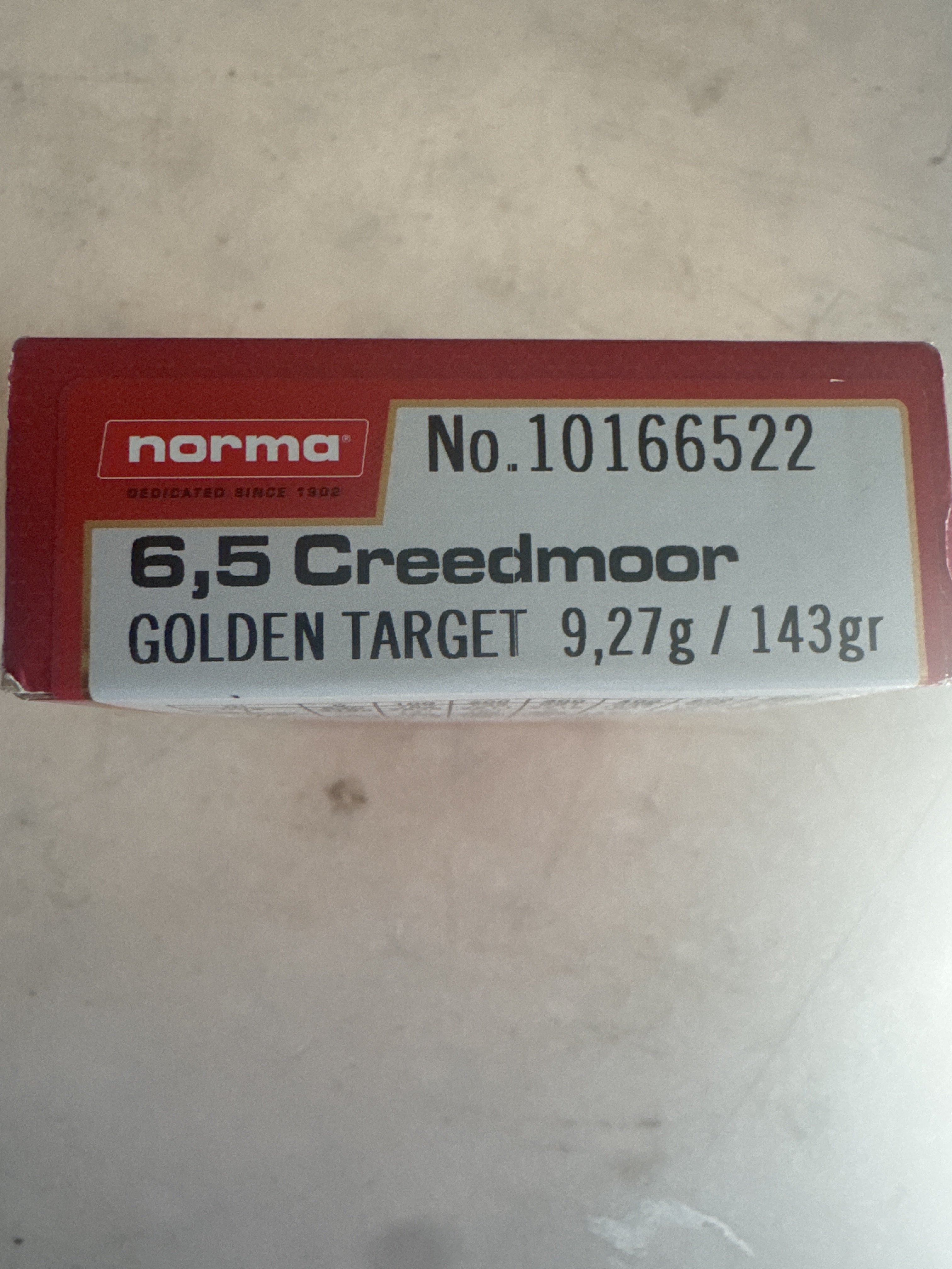

Is this the Norma ammo you are referring to?
That's what I shot in my 6cm. Probably shot 7 or 8 matches with it. I never missed a target due to that ammo, and could buy it for just over $1 per round. It would be my recommendation.
Oh yeah, and the brass is pretty good. I have reloaded some of them 6 times without issue.

Going to shoot this at a one day Saturday. Regional big box store is $23.00 for a box of 20.
