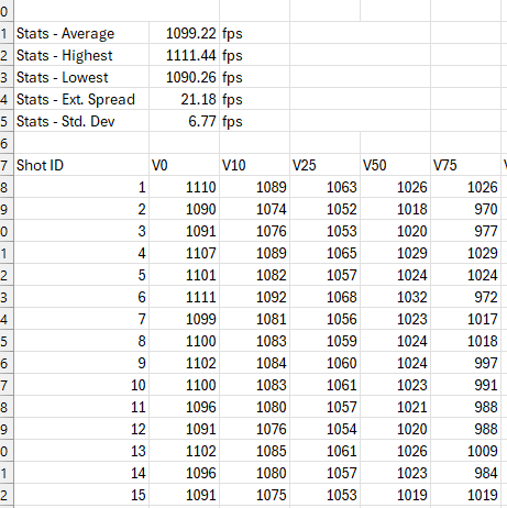

I chronographed the two rounds a few weeks ago.
The Norma Tac 22 gave me a Standard Deviation of 8 Extreme Spread of 22 and FPS of 1093
The Norma (NOT) Match "HIGH PERFORMANCE TARGET " Gave me a Standard Deviation of 17 Extreme Spread of 81 and FPS of 1100
Sorry for the confusion. I had to go and double check my boxes. The HIGH PERFORMANCE TARGET is I believe old stock and in a BLACK box rated for 1100 fps. I see it often advertised as "MATCH" but it is not. The new MATCH is in a RED box rated at 1083 just like the TAC. I Did not Chrono that. Totally my error. I misspoke.

What rifle and how many rounds over the chrony?
An ES of 22 is amazing for 22lr.

The rifle was a CZ457 Varmint, Non-Match, 20" barrel. 25 rounds were chrony for this test. ES22 SD 8 AVG FPS 1093, rated @1083.
I noted above I mis-spoke about the MATCG AMMO, It was the HIGH PERFORMANCE TARGET that I was testing that gave the other numbers. I corrected it above.
Match22 red box that I bought a few years ago shot fantastic, later lots I tried the
ES was around 31fps. It shoots very well but it is luck of the draw.
I imagine the ES would be grow with a larger sample, but if that batch shoots well in your rifle I'd be buying as much as I possibly could.
