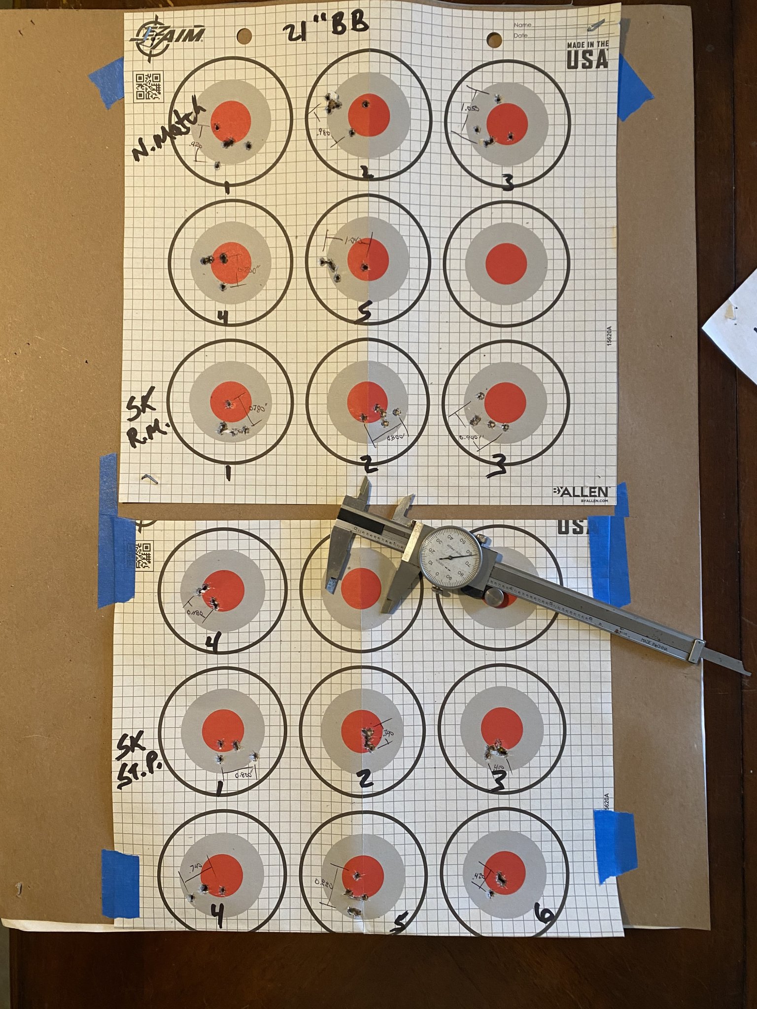

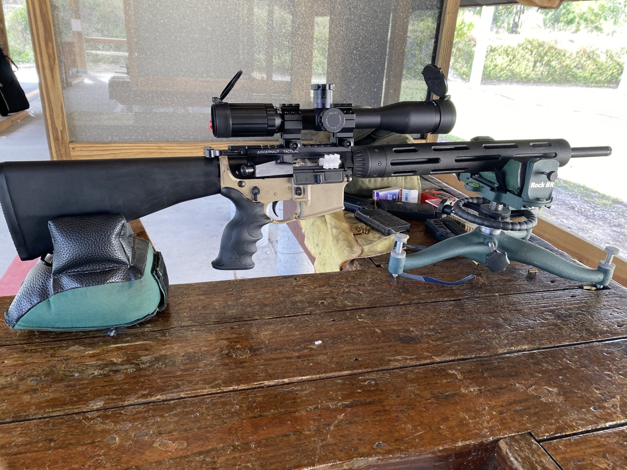

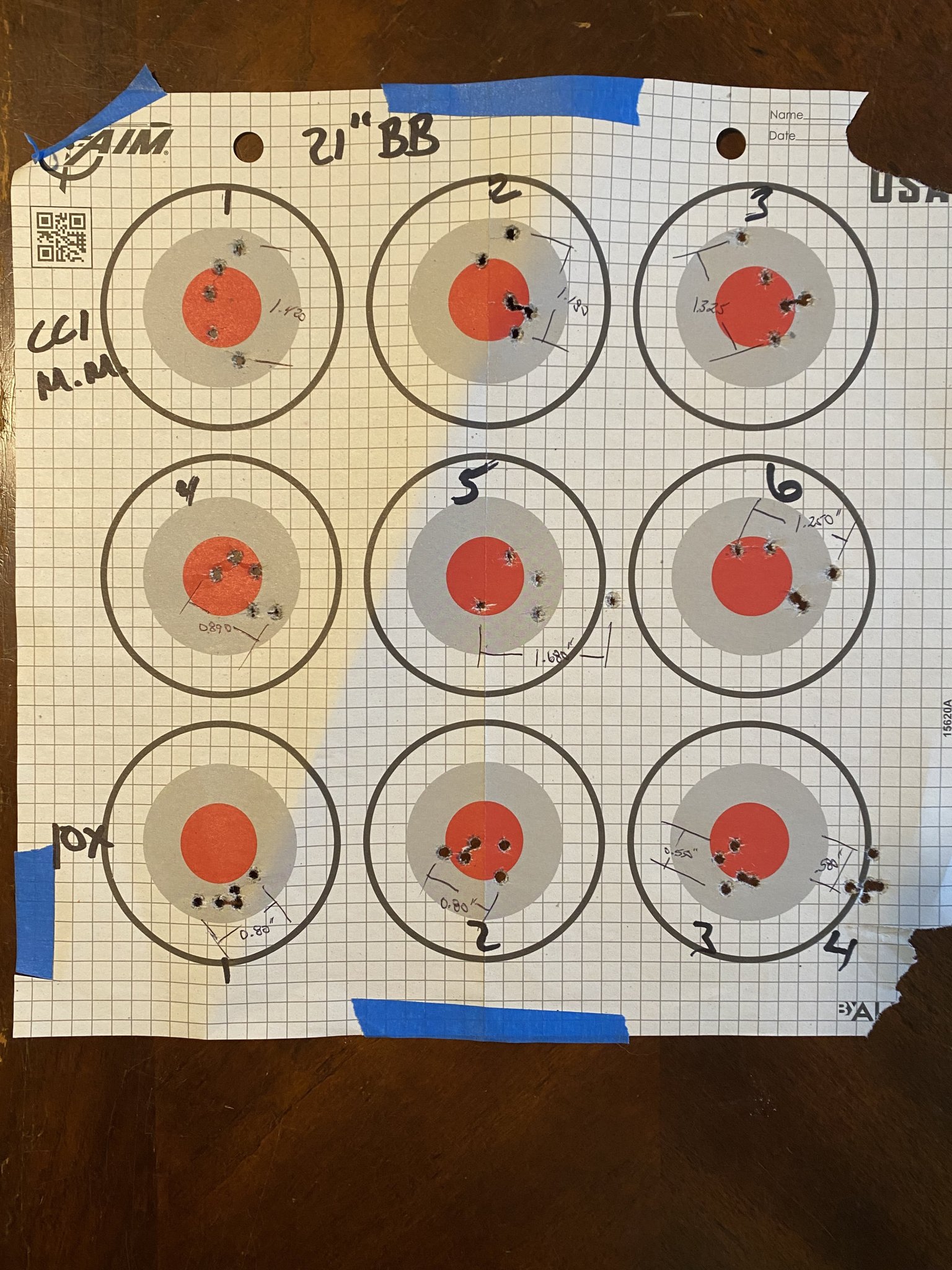

As a follow up to my earlier post here are some targets from this weekend. These were shot from 50-yds and you can see my set up. The lower has a Daniel Defense trigger. It's a pretty high pull but breaks very crisp. I'm not sure this is the right lower for the upper but it shot alright. I'm also using the 2A Armament bolt with BB barrel. This is the titanium bolt that was on the market for awhile a couple years back. Very sleek design but oddly enough it didn't work very well with the barrel that came with. I'm shooting that with a normal CMMG bolt. Anyway here we go...I clearly didn't like the CCI Mini-mags. These were the 40gr "target" loads. I then shot (4) groups with Eley Tenex where the last two groups were just under 0.60". Not too much to bragg about with the Norma Match22; nor with the SK Rifle Match. It did seem to tighten up pretty good with the SK St. Plus. All of cycled fine and I used Black Dog Mags, S&W 15-22 mags, and KRISS mags. All worked great.
Now, I'm not going to sit here and say that this is better or even as good as most 1:16 twist "match" barrels but I'm convinced the barrel is capable. I need to shoot it more and dial in on the ammo it prefers. Looks like Std Plus is a good candidate.
edit: this is the 21" BoreBuddy Apogee Match barrel if that wasn't clear.
