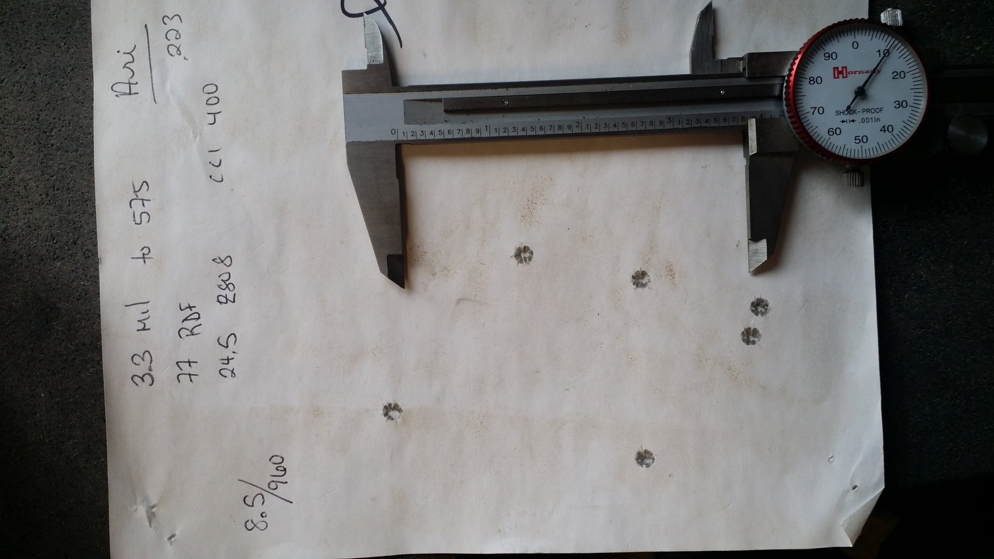

Well Heck.... My apologies. These are in bolt rifle.
This is my daughter at 575 with the 77 RDF, These were overrun bullets. She could hold a 16 inch plate at 960 and keep them on a coyote 7/8 inch tall at 700.
Can't complain... She will use them in a couple matches the over the next month. We will see how they hold up. She has shot about 250 of them the last few weeks. She doesn't like to shoot paper, so these are it at range just to verify drop and general group.
Not bad ! Looks like your using 8208? XBR?

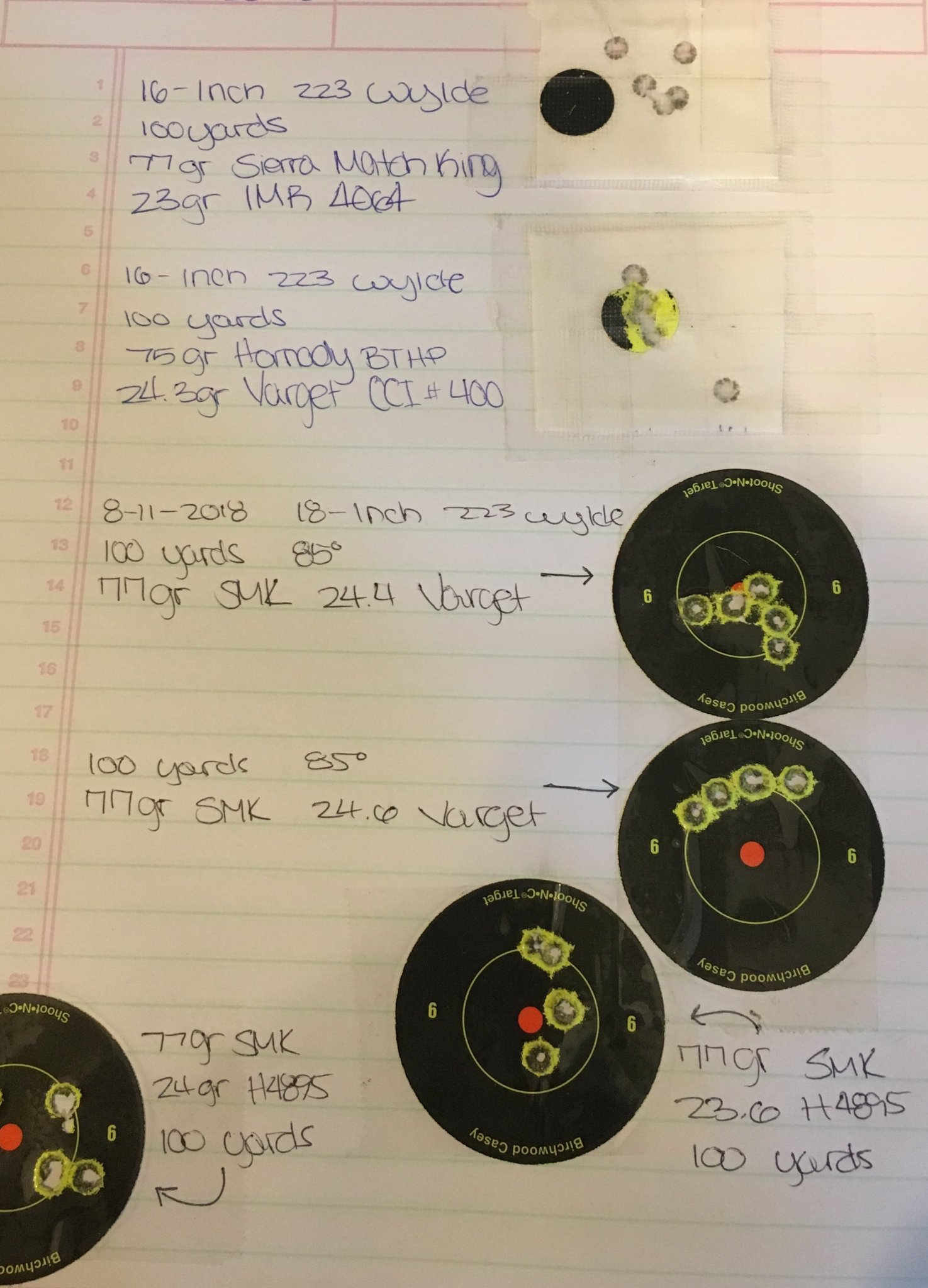

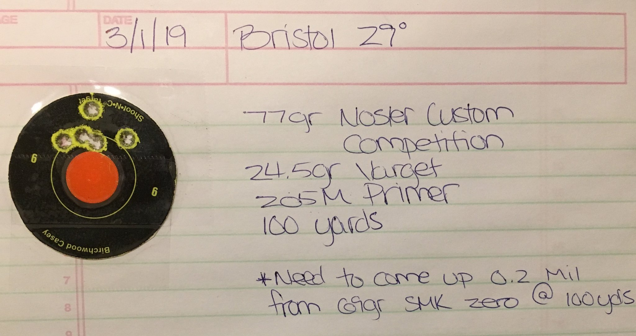

I just played around with the 77gr Nosler Custom Competitions to get a comparison against the 77gr Sierra MatchKings. Looks like the Sierra bullets shoot a little better, but the Nosler are still sub-moa. Considering this is out of an 18-inch AR, I'll take the Nosler load sing as it's almost half the price of the 77 SMKs.
I didn't know they had RDF bullets in 77 grain weight. I tried the 70gr RDFs and didn't get any worthwhile results.
