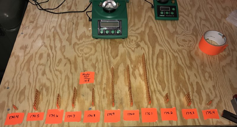

I followed the numerous threads on Scout about the RDF and they convinced me to give the RDF a shot.. a big shot. Now, first thing I'd like to point out is that I have the factory seconds, but I have a LOT of them.
I decided to pick them up in .308 around the same time I sold my old .308 and ordered a new one from RBros, so I haven't actually loaded any up yet. The rifle should be ready very soon, so today I was just messing around at the bench and decided to weigh these RDFs. I've never sorted by weight before, but I'm seeing some pretty large spreads and inconsistencies here.
I've got weights from 174.4gr to 175.3gr.
My two questions are:
1. Is this because they are the factory seconds? The description when I bought them said it was 100% cosmetics that made them blems.. maybe they're full of it.
2. Since I've never cared to sort by weight or check the effects of my previous loads with the 178 AMAX, I don't know how this will affect vertical stringing. I feel like a half a day of searching for topics on sorting bullets by weighs has yielded a number of threads on various forums saying that bullet weight consistency isn't actually that big of a deal, but this is a large inconsistency IMO. Will this be a huge problem?
Well, I posted this thread out of a little bit of a panic. I was starting to worry pretty bad that I had 2k useless bullets.. but a quick data entry on JBM shows that there is essentially a maximum of 2" of difference at 1000 yards with all other things being equal. Maybe it's not as big of a deal as I feared. Still I've never seen or heard of that much variation in such a large percentage of bullets in one box. I have heard of boxes of Bergers having a single bullet off by .6 in a box every once in a great while.. but 60% of this box was greater than .3 off of 175gr.

I weighed another box this morning. I weighed each bullet on two different scales and got exactly the same number on every one of them. I know there can still be variation in the scales.. but this has me a little frustrated. If nothing else... it takes some confidence away on the performance of my ammunition.
