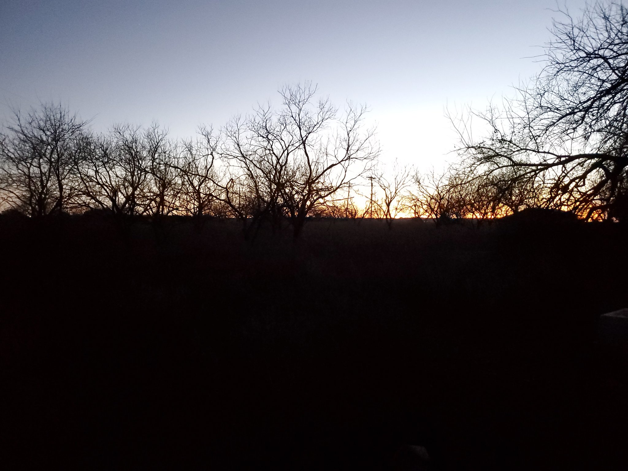

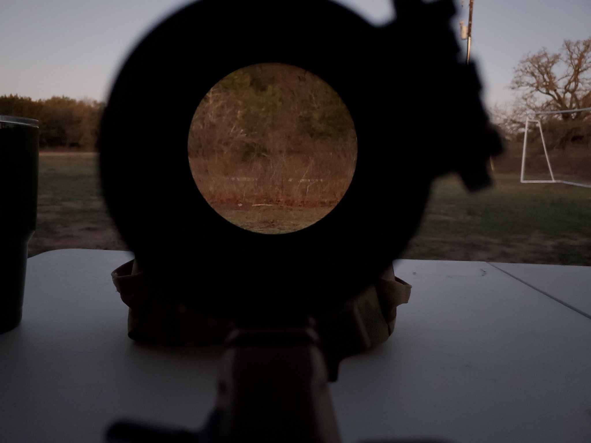

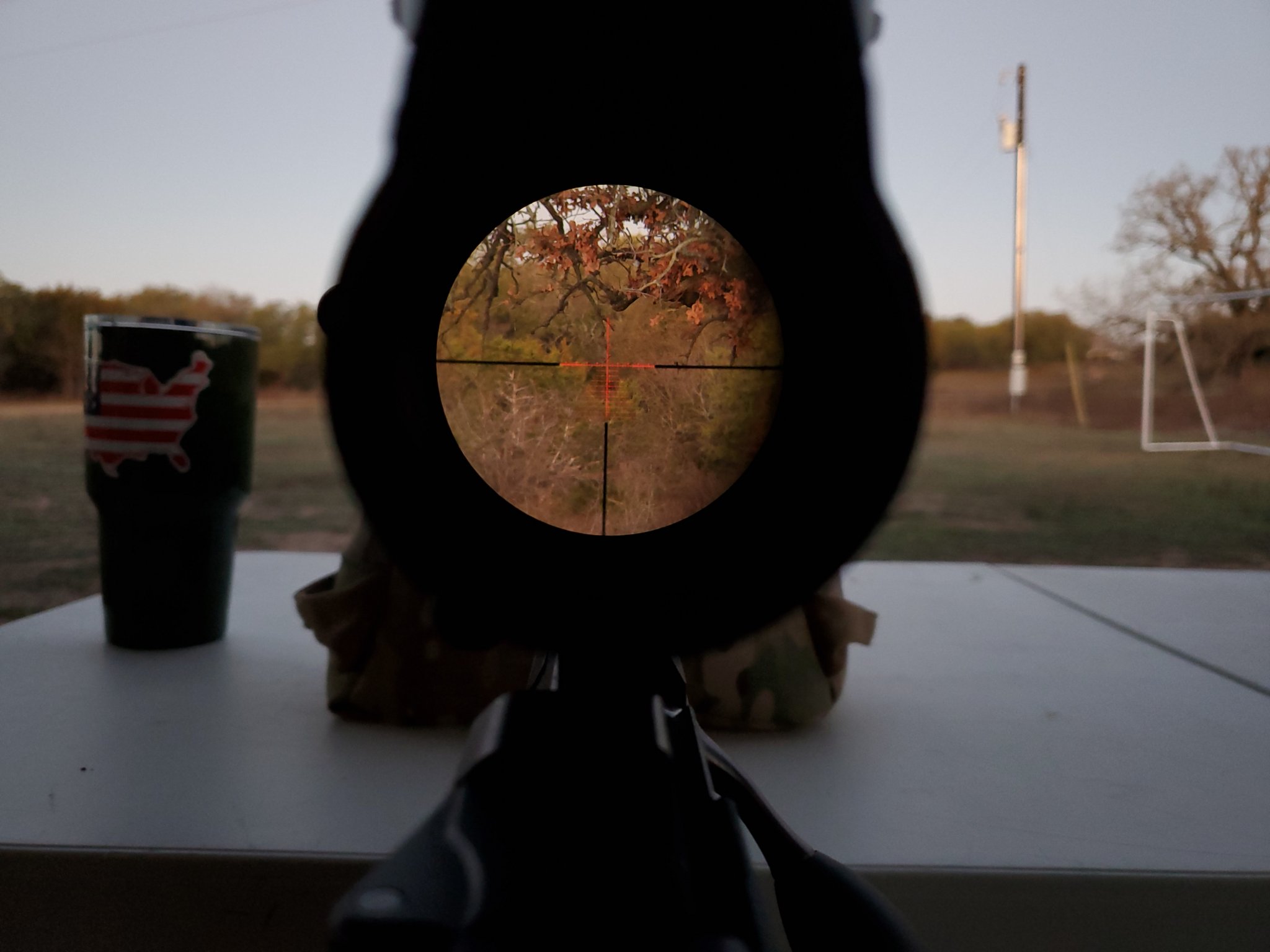

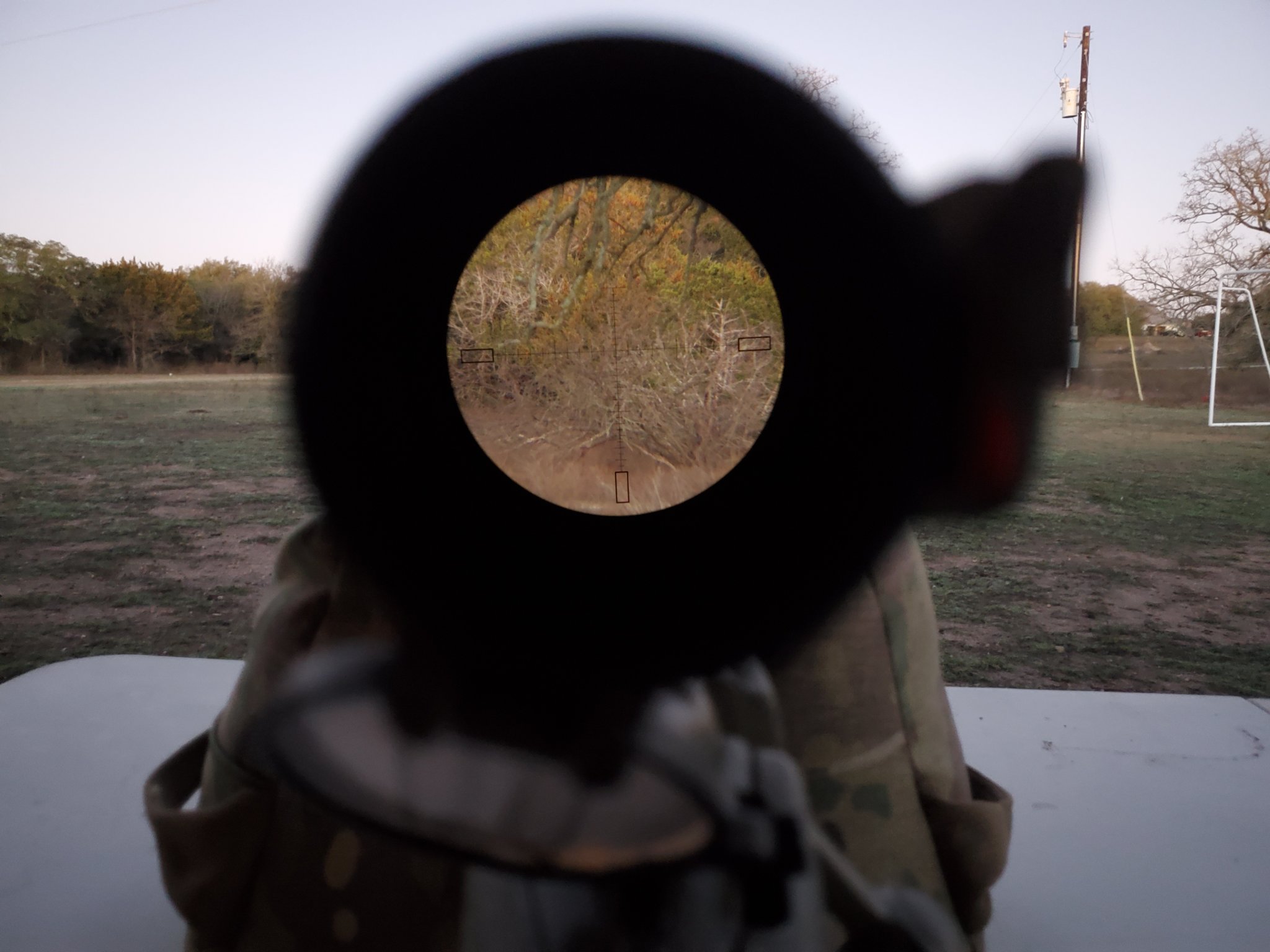

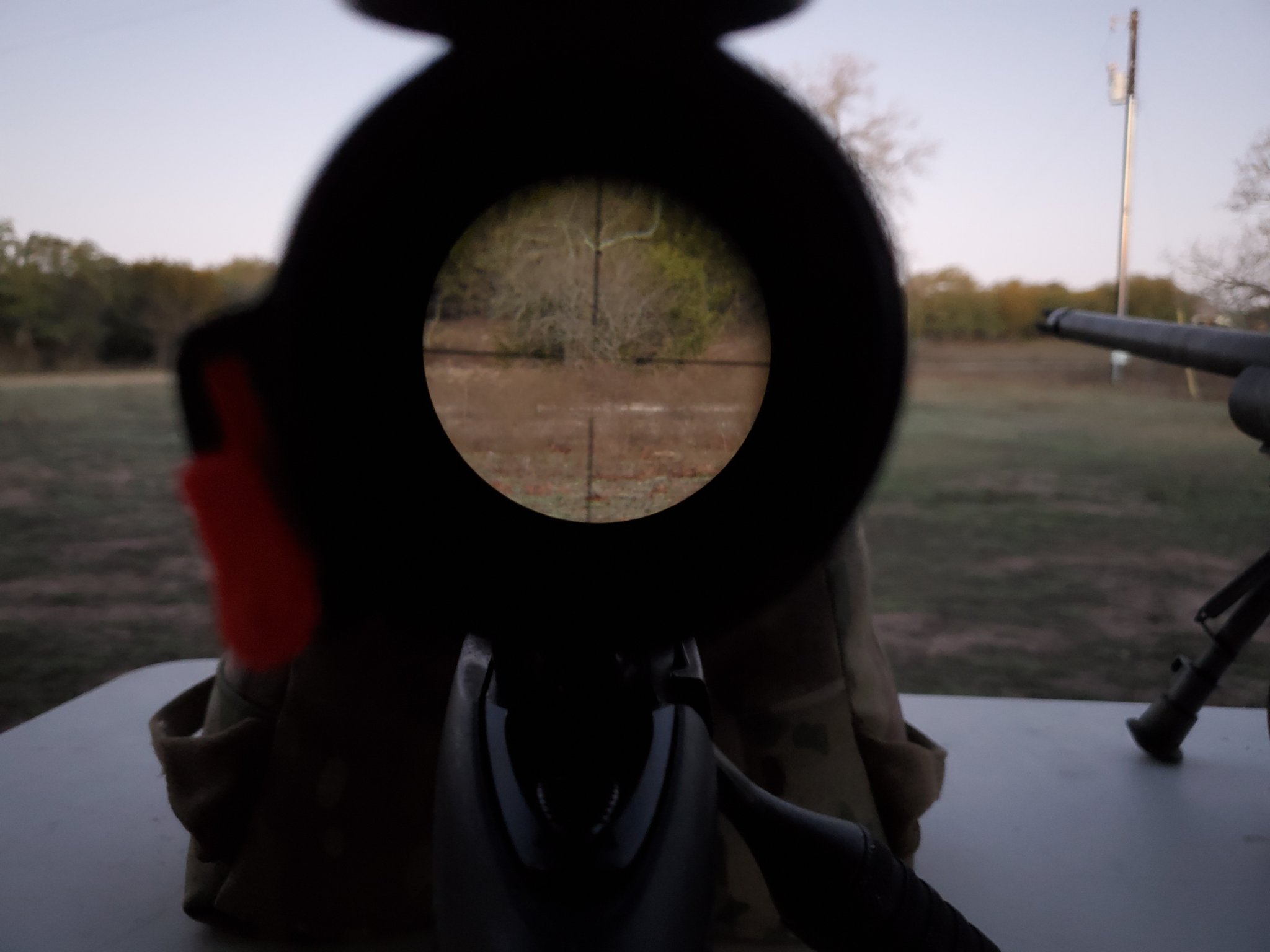

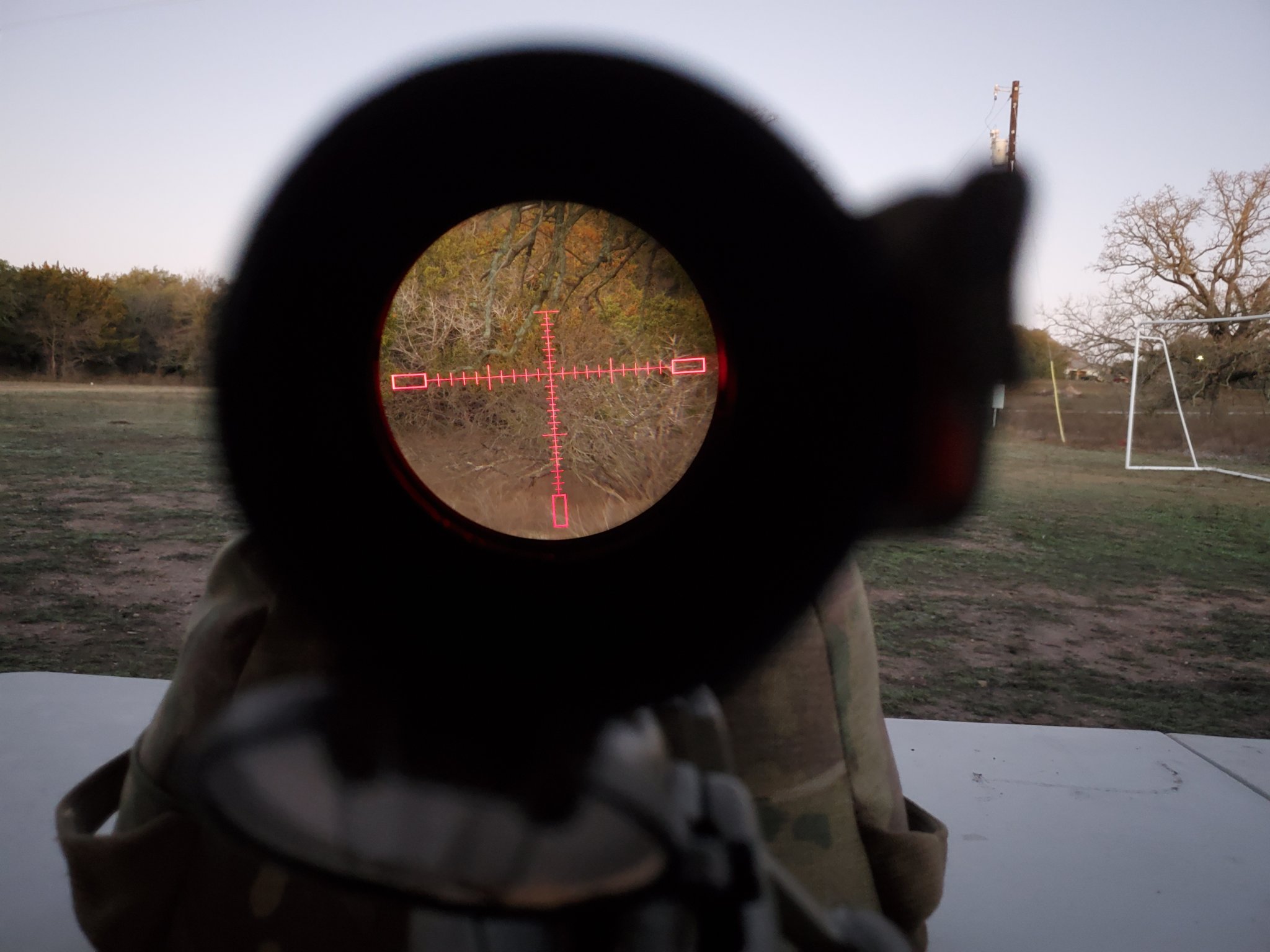

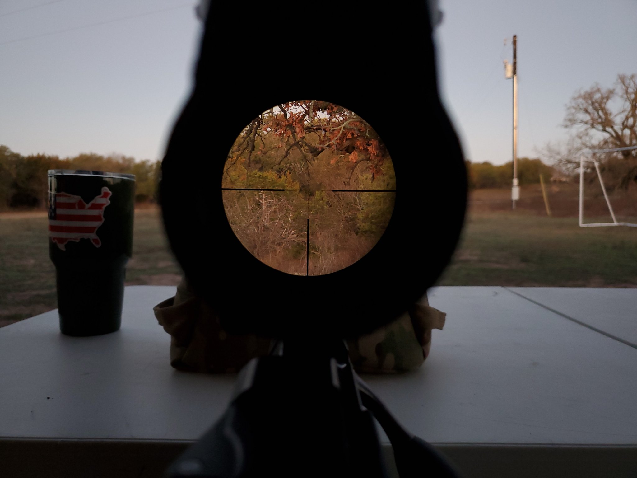

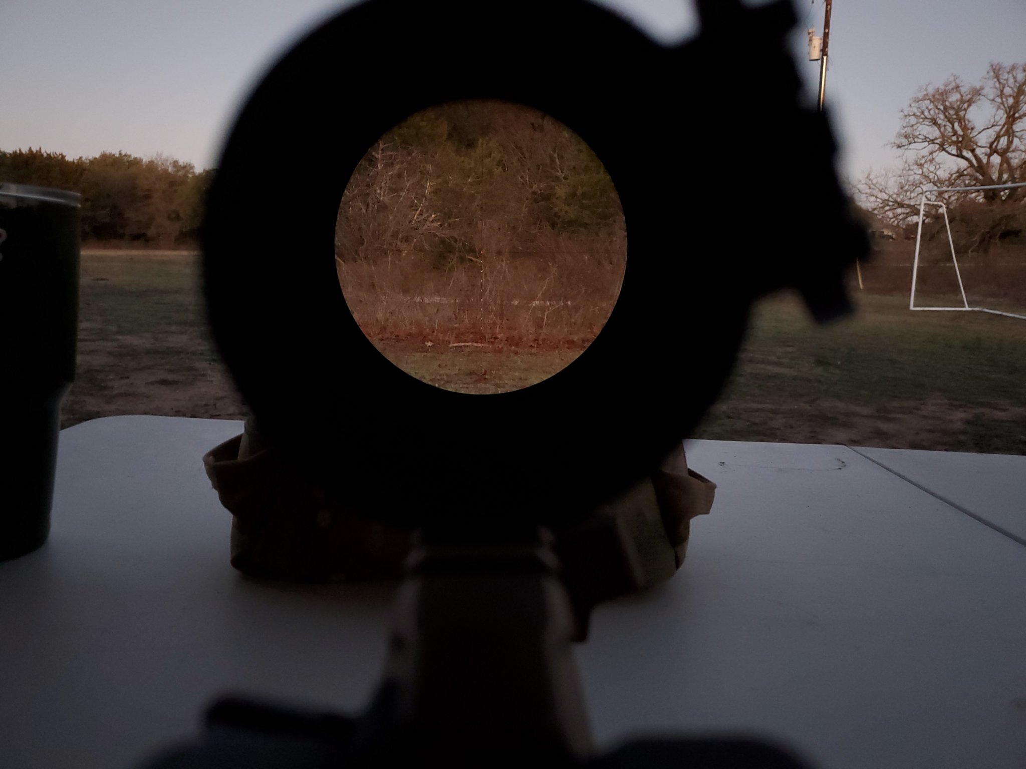

Pictures were taken facing west, there is a neighborhood on the east side of our property. I did grab my binos and face the east at sunrise and it just made it harder. The contrast between the brighter sky and the darker ground made it tougher to pull out detail.
As you can see, in some of the pictures, the reticle is completely useable, but in others, I can not pull out the center crosshairs or dot. Your mileage and eyes may very. As of December I’m 20/20 in my left and 20/25 in my right. Wouldn’t expect that to make much of a difference. The hardest for me to resolve was actually my NF 4-16x42 ATACR, but then again, it also has the smallest exit pupil, and thinnest reticle.
ETA: some of these pictures were 10 or more minutes apart as I was switching between rifles and trying to get the camera to focus.
Reactions: Black max
The argument on time of day is moot. A small thin FFP reticle at low power is harder to see than a thicker SFP reticle at the same magnification regardless of light condition. It doesn't matter if it is bright and sunny or dark. At a certain point (light conditions) FFP reticle on low power becomes unusable without illumination while the SFP reticle is still viable. Whether or not this weakness of all FFP scopes compared to SFP scopes for hunting use weighs less than the benefits of FFP compared to SFP is up to the end user. Illumination on FFP scopes narrows the gap significantly on all but quick snapshots. I bet we can all agree on this at least.

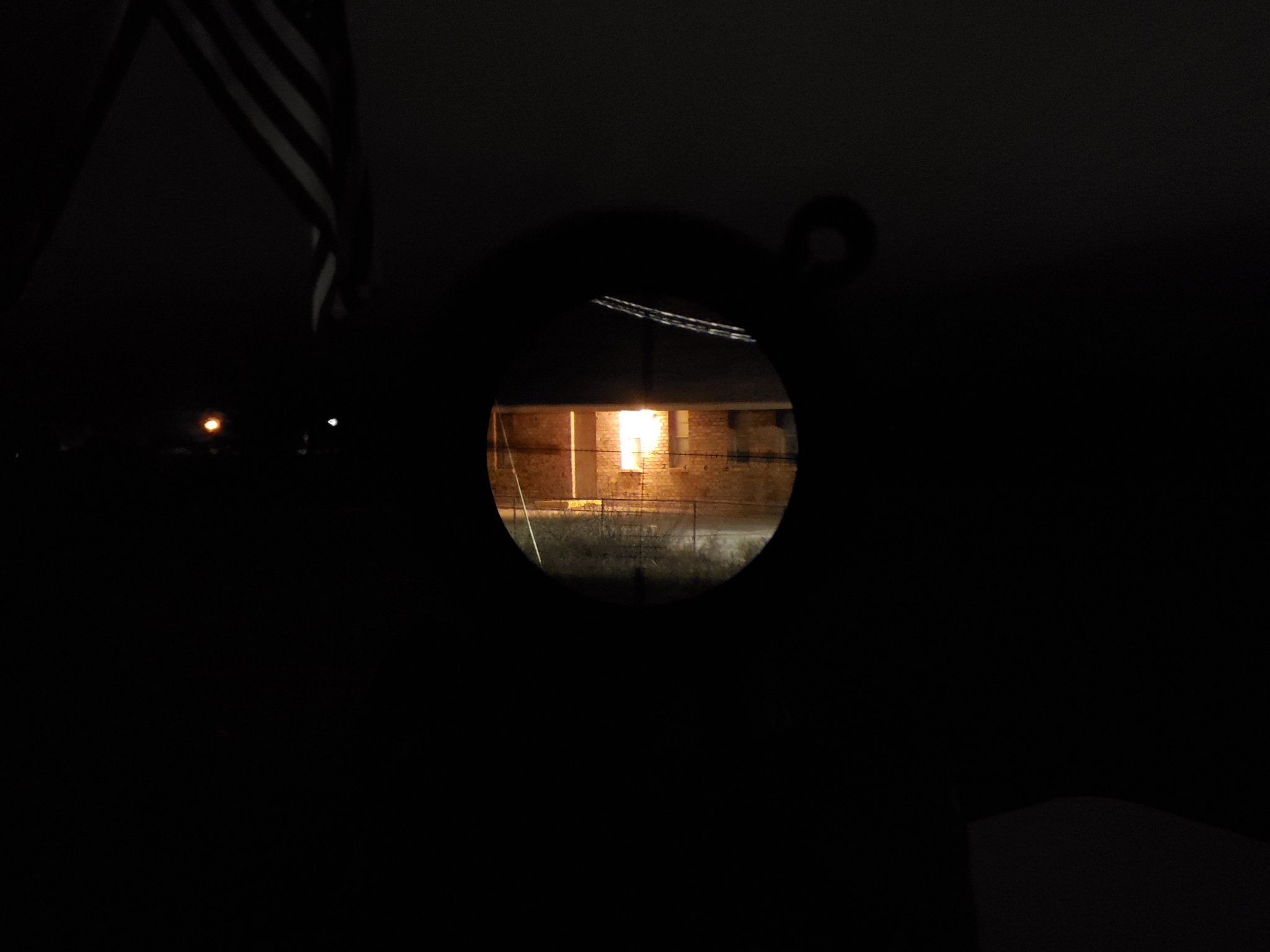

How can that be lowlight when your scope is literally pointing at a light...
That’s the opposite of low light. What’s it look like pointed in the opposite direction?
Fair enough. Poor example. I had just taken the pic for a different post and thought I would drop it in here in reference to the low light discussion from earlier. We normally have the light attached to the rifle and its pointed the other dirrection. The point I was trying to make was that not everyone is using them during daylight hours. I just got in a WickedLights A48IC and will try it with that seing how that's it's intended use.

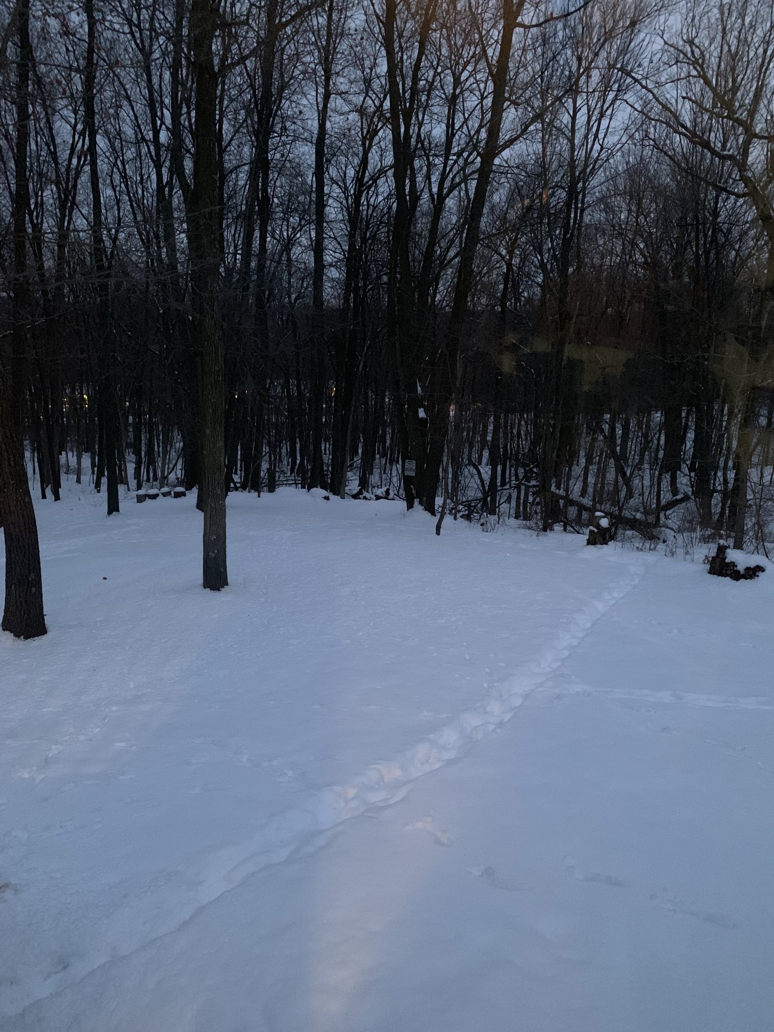

I was working I’ve getting a 30 minute before sunrise pic and forgot. This is 17 minutes before sunrise here. 13 minutes ago I would use an illuminated reticle every time I had it. If I didn’t have it I might have to wait it out in order to make a precise shot on a dark animal.
and this is with a bright blanket of white in the ground. In the fall when it’s just leaves, it’s darker yet
