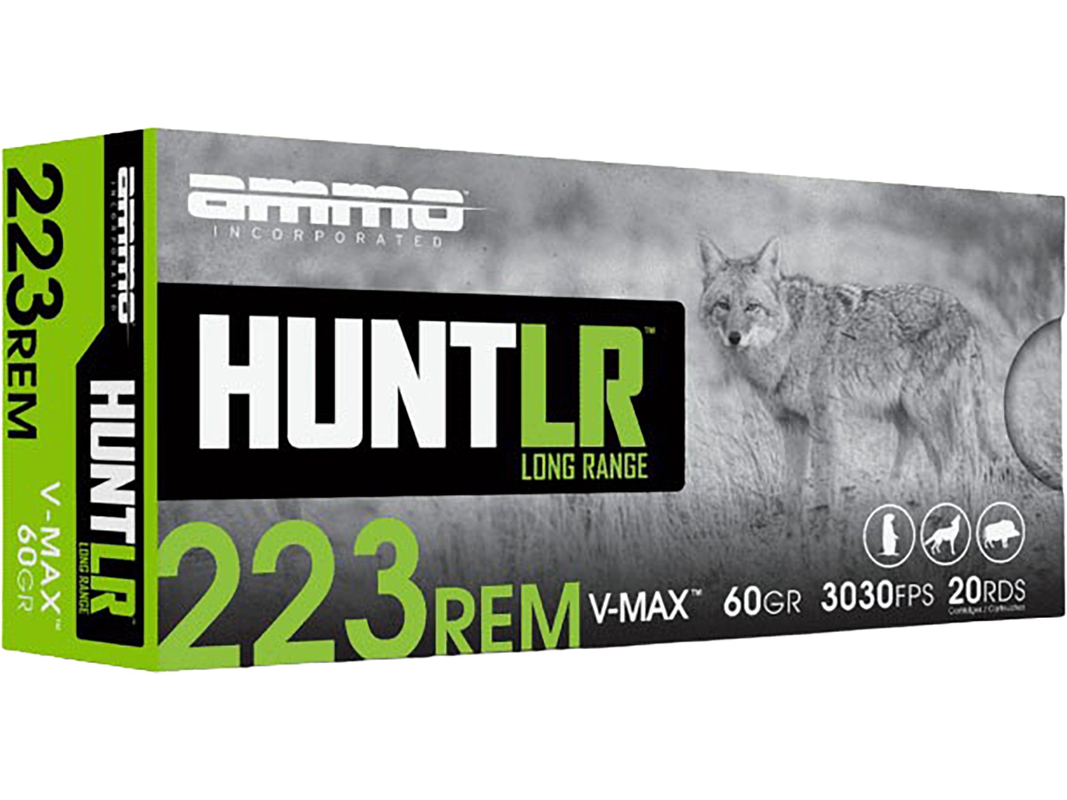

.223 60 gr Ammo Inc Vmax

Yeah, I’d say your results are as much a factor of the manufacture as the grain weight. Ammo inc and AAC aren’t exactly match loads.
Sample size of one here, but I’ve shot a few cases of Ammo Inc 60gr vmax and it’s consistently a great performer. This is the non-reman version. No idea about any other selections they make though.
