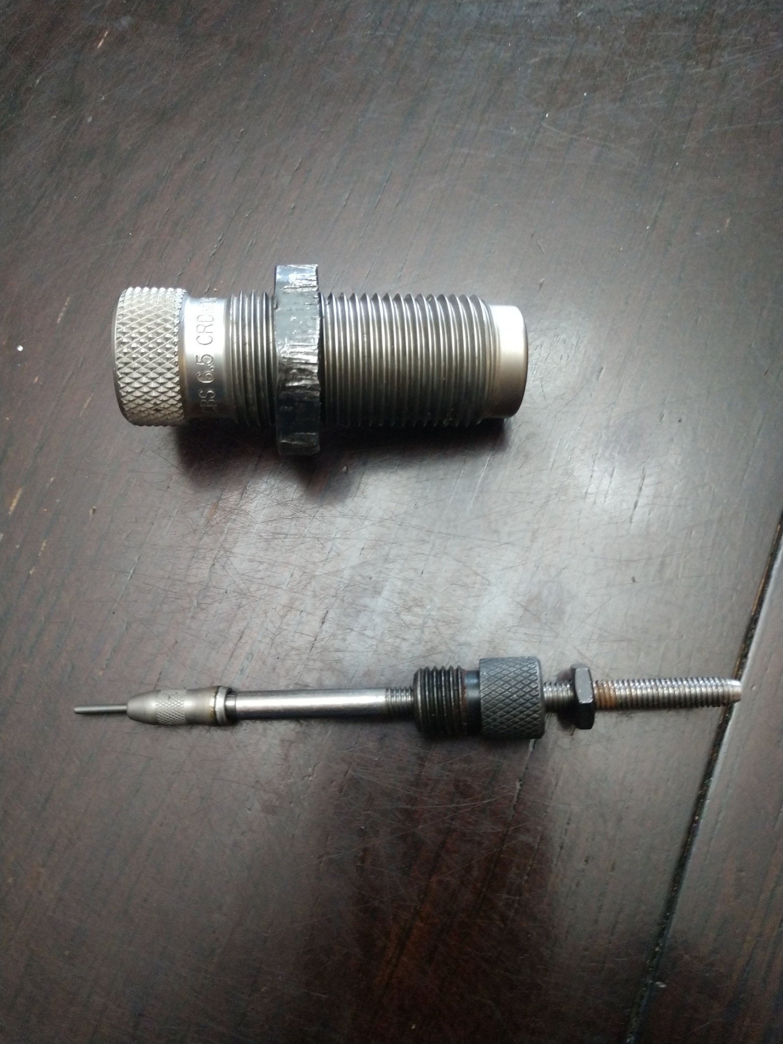

Everything looks good on the die. (As far as I can tell)
I took the die apart, looked fine, cleaned it up, ran about 25 cases through it, seems consistent now. Idk, maybe it's just me, but they definitely varied before. We'll see. Thanz guys. TRUMP2020!
Reactions: atbarr
What the hell happened to your lock ring? Something that mangled could certainly cause inconsistencies. If your problems return, spend $5-$10 on a new ring.
Don't be an ass. Had to use it as a puller removing a stuck case. As long as the mating surface isn't marred, what's the diff?

I don’t know how you don’t think the mating surface isn’t messed up zooming in on the pic the bottom of the lock ring is all kinds of out of whack
Sure thing. I'll take a perfect one off another die. See what happens. Thanx. Appreciate the feedback. You're pretty damn awesome. I smoothed er up on a surface grinder, but hey, looks are everything.
After alot of use, I finally somehow stuck a case for the first time. It was a son of a bitch, but I got the fucker out by putting a pipe coupling under the ring, and putting the bottom of the stuck casing in my vise at home. Then cranked on the lock nut with channelocks because I didn't have the correct boxend or deep well to fit. I was despatate to get the fucker out to continue to load for a get-together with my friends. I succeeded, but in the process mangled my locknut. Excuse the fuck outta me. If any assholes out there don't understand, kiss my ass. I opened up I'm a beginner looking for help. Can ya wise the hell up and get on topic now?

If I may make a small suggestion regarding your reloading die. try cleaning the rust. While it may be unorthodox, using a vibratory brass cleaner is a great rust remover.
To be honest, if you had that much trouble with a stuck case, really you might want to send the die back to the manufacturer to have them check it out. I know, RCBS, Redding and Hornady are very nice about providing this type of service
Lol. Stop it. Ok, I'll do that. I'll have to admit, I don't see how a lil patina on the threaded pin adjustment would effect anything. I may get ahold of the company, idk. I'm about to write off the whole issue. I'm not noticing the variance while trimming anymore. Can't explain it. Thanx to everyone's advise. I regret even posting this. Been bad all round. FWIW, my equipment is in good working order and taken care of. This locknut has been abused, I admit, but I've explained how it happened. I haven't gotten to shot any 6.5 I've loaded recently to see if the super flyers have gone. Maybe not load at all? I just don't understand what went to hell. It coulda been I was using a leadsled too. The one I have is "hard to get behind the rifle". Maybe an inconsistent / poor cheekweld was in the mix? Things happened to improve going back to bipod and rear bag. IDK. Playing with my 22-250 presently. She shoots great! Seldom larger than .5moa with a few less than .25. fast. Got loads worked up with Varget, H380, etc. Also Savage.
Using a soft vice grip like this in your vice will be much easier on your equipment
Soft Vice Grips
Yep. Got a set to use when I changed out a barrel. I had to get a death grip on that stuck case. Wasn't gonna happen with soft jaws. My stuff is good as new, I hadta get rough with that die. At the time I figured I had nothing to lose. Worst case, buy another nicer set. Not that pricey, really.
I take impeccable care of my vehicles, bikes, atv, etc. Friends accuse me of being a neat/clean freak. Lol. The remarks pissed me off and made an ass of myself. I apologize sincerely.
