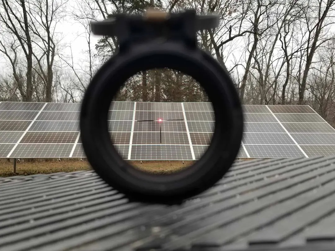

I haven't actually measured fov, but in that video I posted in this thread, the atacr is aimed at a hill significantly closer than the flat area by the river than the nx8 is aimed at. Pretty impossible to draw conclusion from. However, I did take this photo series:
Diopter on both is set to give the same performance at 1 and 8x, in each, for me. My diopter typically runs -0.5 to -0.75 over my right eye.
