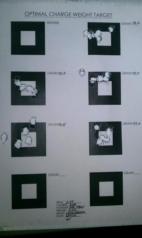

The wind was terrible yesterday, but calm and cool this morning. Here's what I ended up with:
I botched the shot left of the main group on 42.4. There were no overpressure signs with the Winchester brass I used today. It seems 42.5 and 42.6 have the same relative POI. I'm thinking I may want to try some loads at 42.7 and 42.8 to see if they are also in the same area. Thoughts?
Try them out at a further range and see what happens.
.1 grain increments are a little tight. Loosen up a little, .3 should work fine. What looks good at 100 yds can be pretty suprising at 300yds. At least you have a base to work from now though.
Remember, using OCW you are not looking at vertical spread or group size. You are looking for a series of increments that print to the same POI from the POA.
Normally shoot only 3 shot groups then find the center of each group and see which ones are similar POI.
