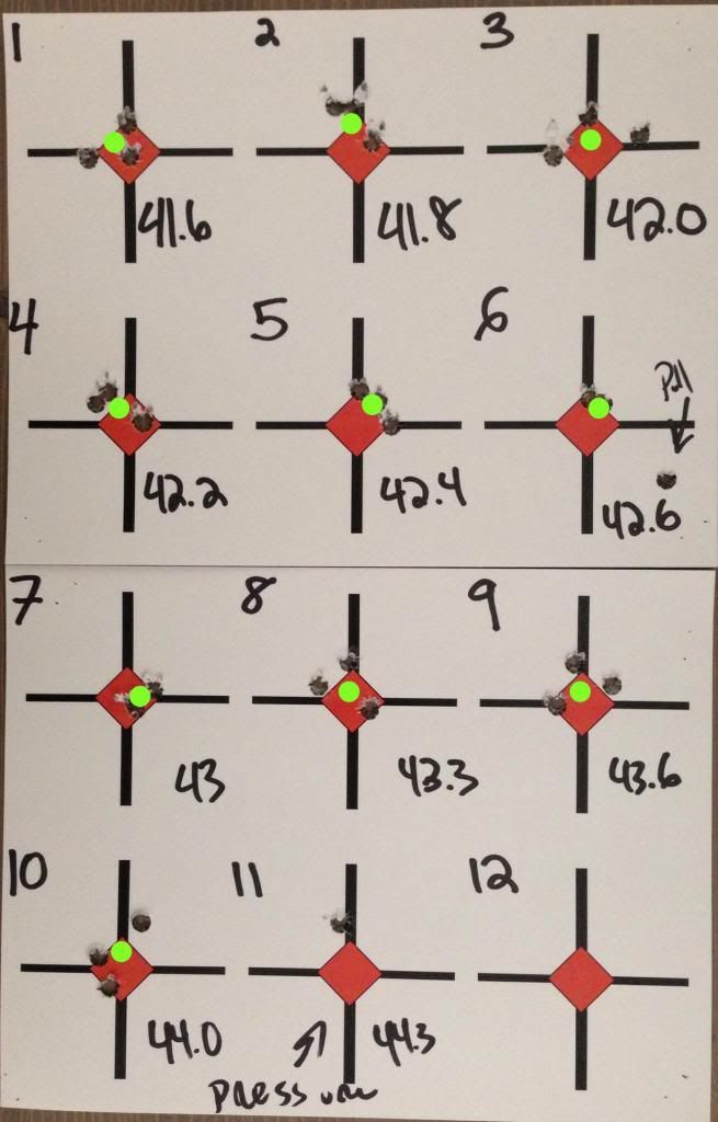

Good evening Hiders, I did this OCW based testing today and was curious to see your input on the finding and my separate observations. Today was 56deg, 47%rh and testing was at 100 yds at 146' alt. Sun was shining and it was a great day to be at the range, and with the exception of one pulled shot I was happy with my shooting. 175g Berger VLD Target, Federal 1X Brass, Win LR Primers, Varget
node at 42.6 as determined by THE man Dan, I also see something at 43.6. I ran a ladder thru the chrono at the end of test(magneto speed), and here's how it ran. The green dots are edited in for the triangulation of the shots.

having previously messed around with Bubb's 20shot ladder, some of that info gels with these groupings. I began to see too much pressure signs at 44.3g so I only sent one shot (flat primer, shiny ej mark clearly present), the 44g was showing a shadow ej mark, on the 43.6 there was nothing. I don't mind running on the "hotter" end of things since I'm very detail oriented in my reloading and check everything OCD style. At the higher node I can hit 1K dialing 9.8mils(1286fps, 352.35"drop), with the lower node 1K @ 10.2mils(1262fps, 422.93"drop)
Mostly my question is am I actually seeing this at 43.6 also? Any advice and tips are greatly appreciated. Working with Dan was quick and easy I will say, made getting this rolling simple as pie.
