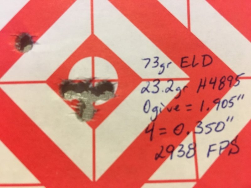

I may have to try seating seating depths and new primers with the H4895. I am very excited about using H4895 as the velocities are outstanding and I never even hit max charge as well as the groups being consistent and tight regardless of the larger SD. Which is odd to me. The group below had an SD of 25 and ES of 58 but look at how tight the four out of five shots are. Doesn't make sense to me. Almost all of the different charge increments hit the center of the target with very little deviation in POI. All five shoot groups did have at least one flyer but none of the four shot groups measured over 0.900"
