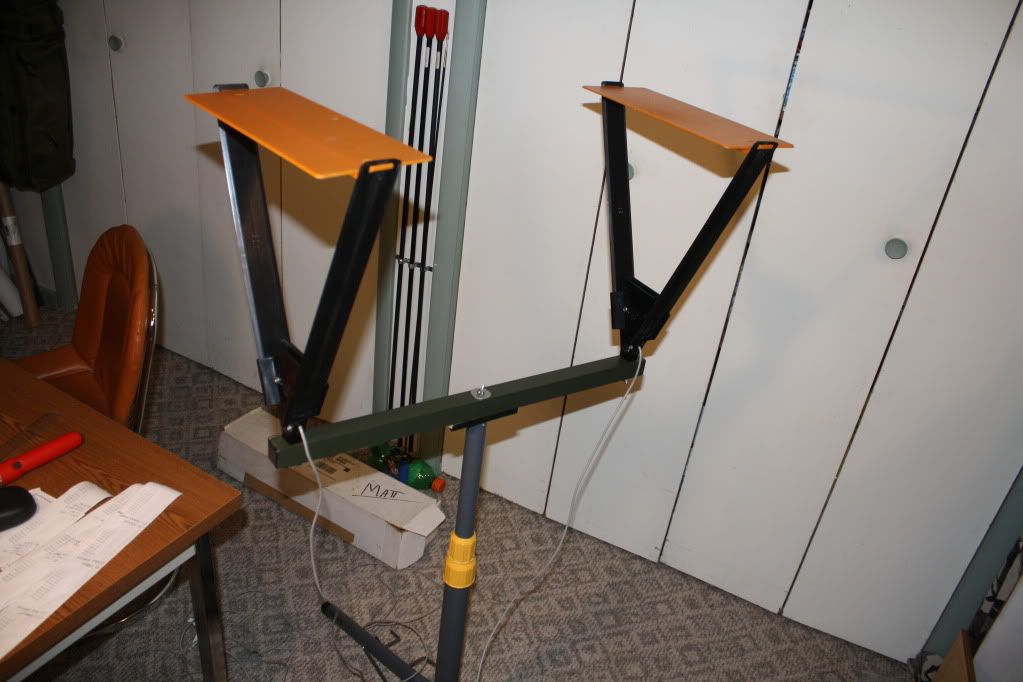

I have been using my Oehler chronograph for a few years now and one thing that has really bothered me is the round rail made out of conduit, and how the sensors attach to this rail. Wind kept acting on the sensors and moving the whole assy, plus I was looking for a faster setup time.
SH member johndoe gave me some suggestions regarding my rail project, in a previous post. I have completed my rail and figured out (I hope) how to post pics!

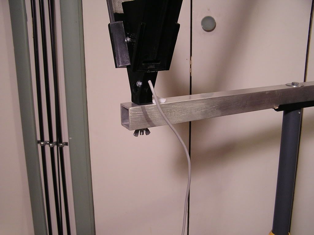

The rail is made out of 1 1/4in ,6061 T6, aluminum tube. Sensors are mounted 2ft apart using the original sensor studs with wing nuts to hold to rail. I use a center stud to hold rail to my tripod (a Sears work light tripod). Plastic end pieces were found in a local hardware store. Painted with OD
Hunter's Specialty Camo spray paint (this stuff is really SOFT and takes forever to dry) then followed up with a Krylon Clear Matte finish. The Krylon dries so much quicker and is a much tougher finish.
This shows rail before end pieces, painting and center stud.
Painted rail with end pieces and attached to tripod with wing nut.
