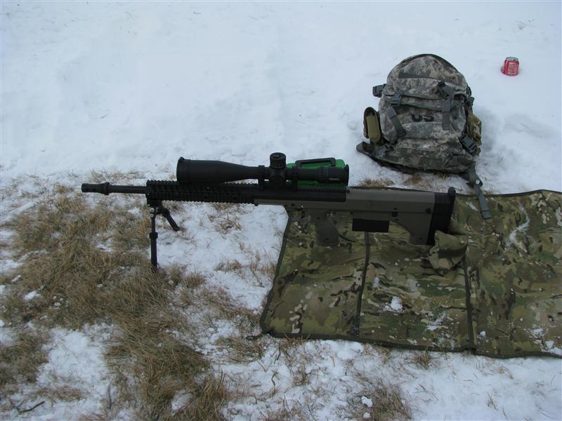

<div class="ubbcode-block"><div class="ubbcode-header">Originally Posted By: ColdBore007</div><div class="ubbcode-body">Killer Penguin, Looks like you have a hell of a nice space to shoot not far from home! I'm loving the setup! </div></div>
Thanks.
My woman took those pictures right out the front window. That very same window that I shoot my suppressed stuff out of in the winter. I figured the lapua with no suppressor would break my window though! So I had to go outside. Once the suppressor shows up, I won't be out there. lol
Yesterday we drug some steel out to 725yds. Here is why I usually shoot in the house. We had to dig a trench through the snow to clear a shooting lane.
